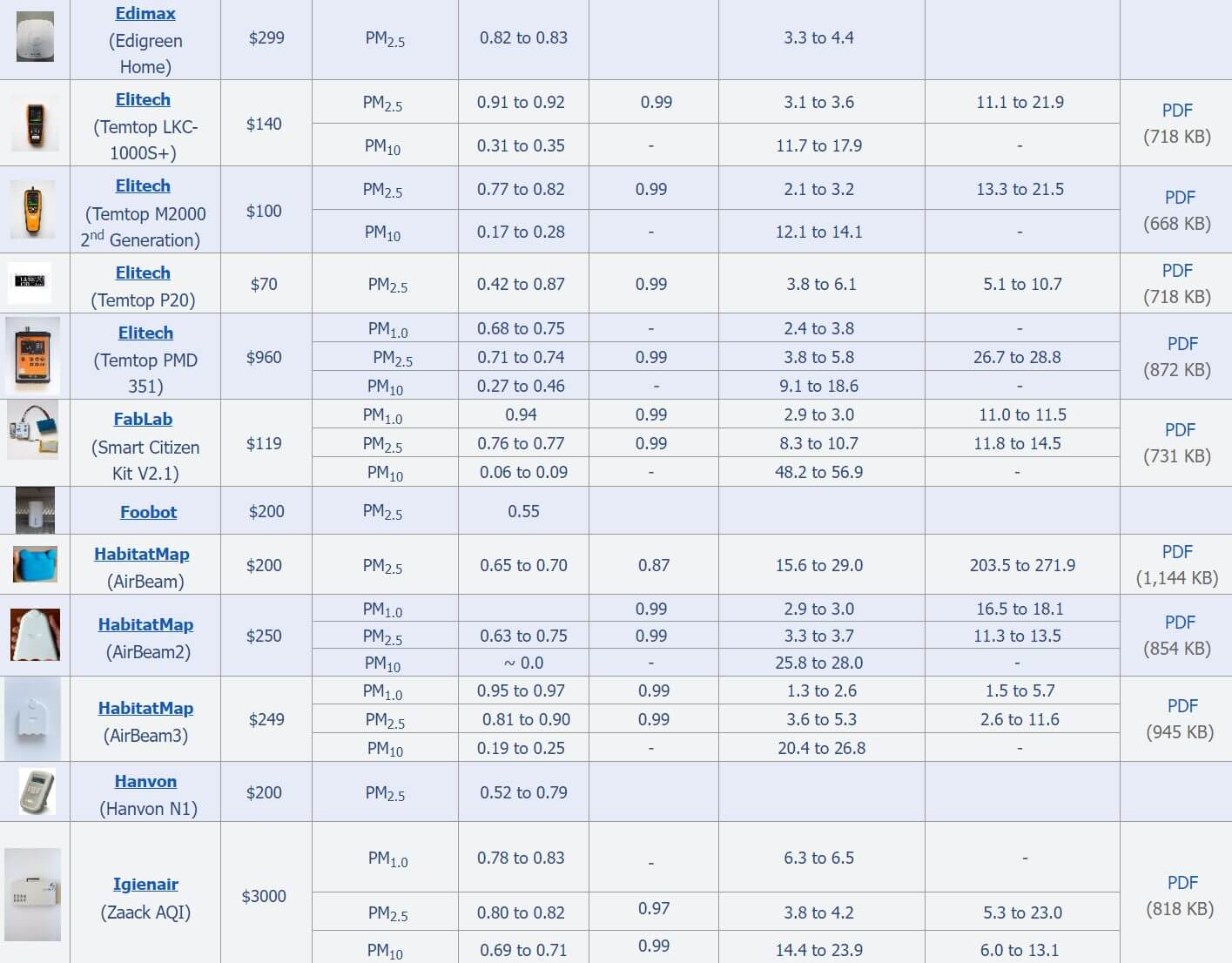

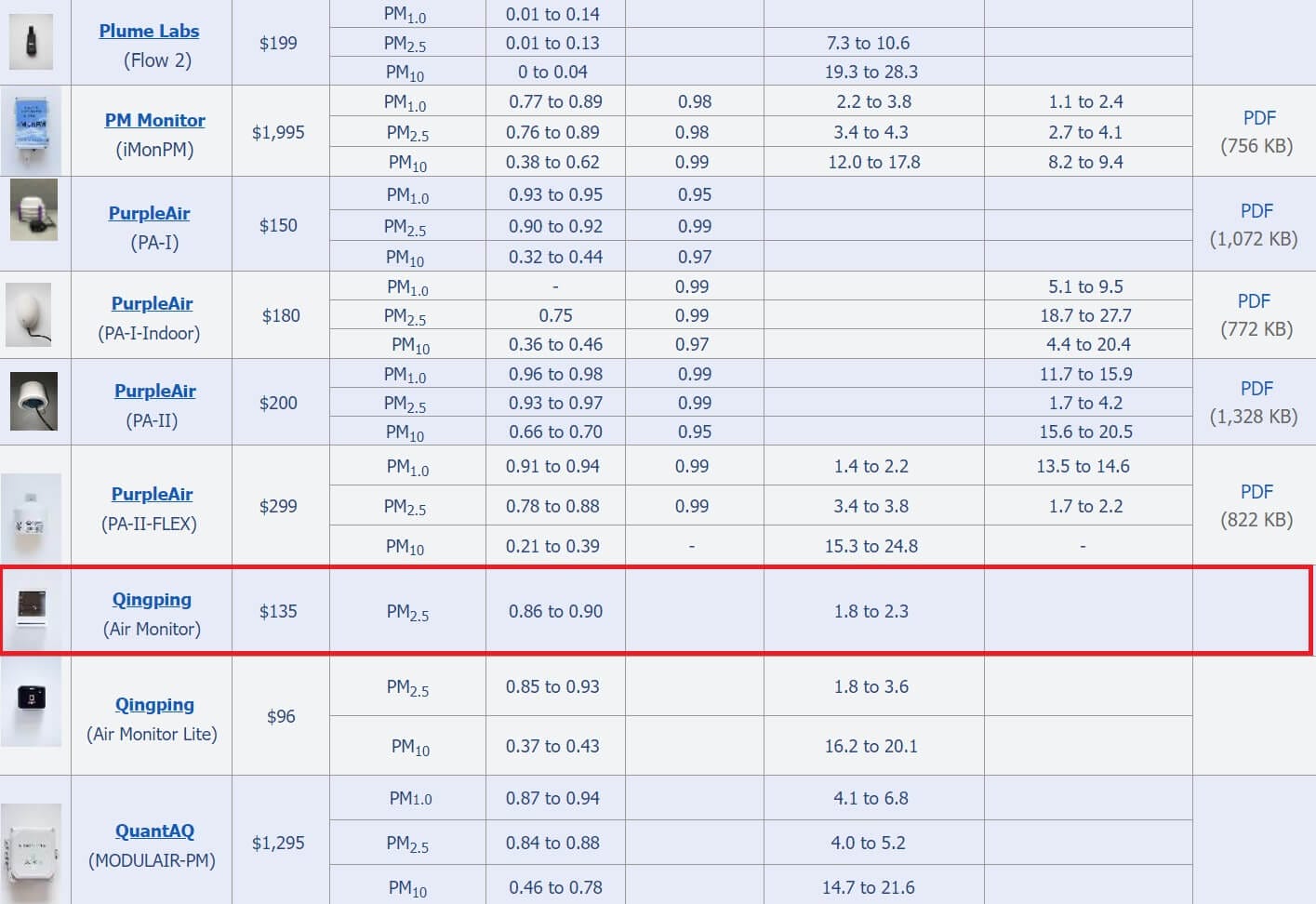

AQSpec PM10 Accuracy
A screenshot from AQMD’s AQ SPEC program. Notice the inaccuracy of PM10 from the different low-cost monitors.

The good news is that AQMD recently tested the original Qingping Air Quality Monitor, so we can use its results for this section instead. While the generation 2 device has not yet been tested, the first-generation device correlated well with reference-grade PM2.5 monitors in real-world tests and I believe the newer device uses the same PM sensor. While it performs a bit worse than monitors from PurpleAir, it also performs much better than more expensive monitors such as the AirVisual Pro.
I also referenced some graphs from SmartAir in my review of the first-generation monitor, which further shows that the Qingping Air Quality Monitor correlates well with reference-grade equipment but that it does tend to understand PM2.5 concentrations. Since the first monitor couldn’t measure PM10, there are no results for that, but I wouldn’t expect much, seeing as the Qingping Air Monitor Lite uses a sensor from the same brand and shows only a 0.37 – 0.43 R-squared value (1 indicates a perfect correlation).

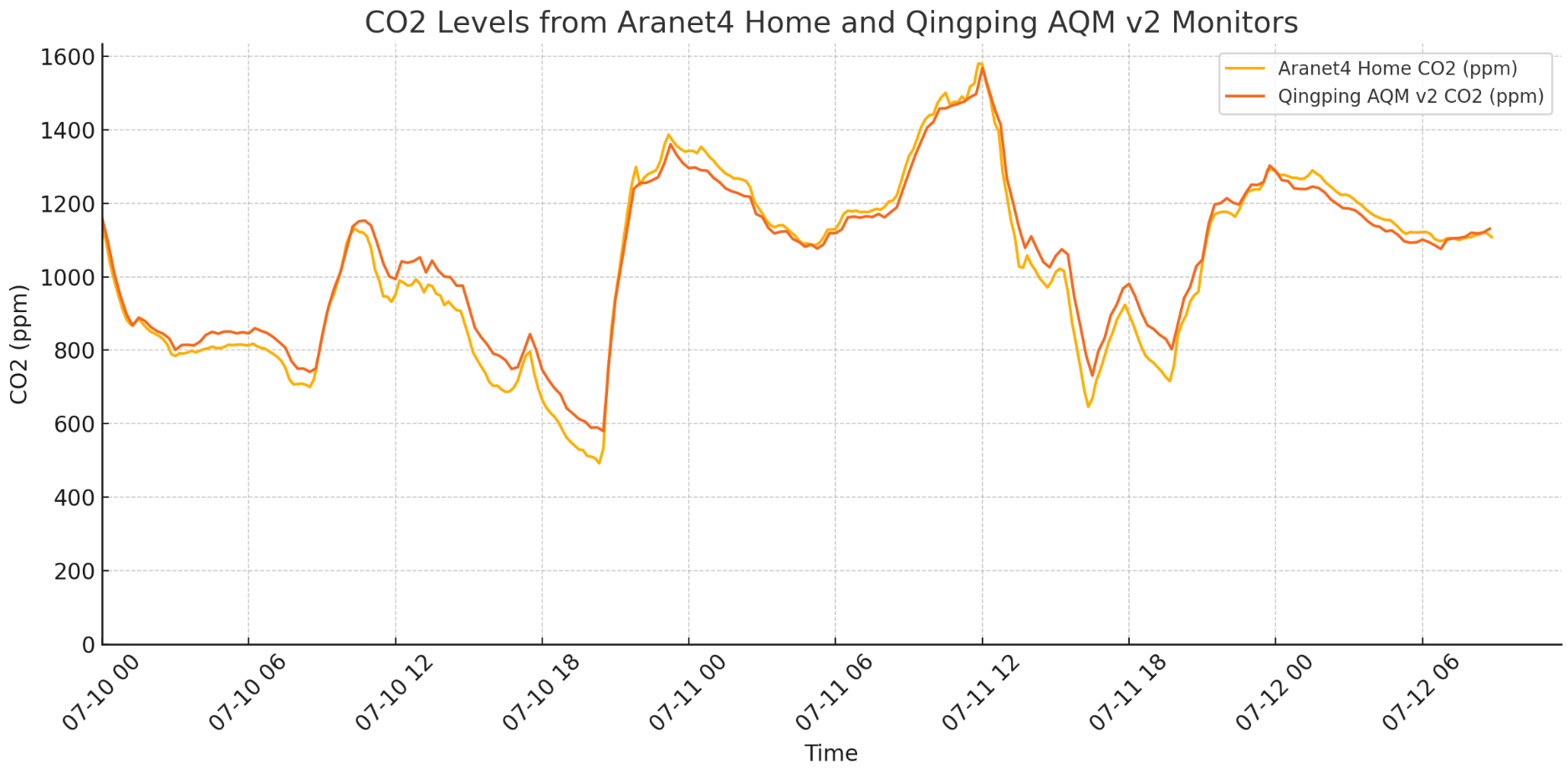

As for carbon dioxide measurements, I expect this monitor to perform well as it houses a Sensirion SCD40 sensor – the same sensor you will find inside many devices, such as the AirValent CO2 monitor. Luckily, I was able to record some CO2 data so I could share it!
Qingping Air Quality Monitor Version 2 CO2 Accuracy
In the graph above, I compared the carbon dioxide readings from the Qingping Air Quality Monitor to the Aranet4 Home, which is generally regarded as the most accurate consumer-grade CO2 monitor. As you can see, both devices read similarly, but there were some deviations. That said, these were within the stated accuracy of both devices.
These results are very similar to what I found during my review of the first Qingping Air Quality Monitor, and this leads me to believe the performance between the two is more or less identical – despite using a different sensor. However, considering that consumer-grade CO2 sensors are quite accurate these days, this makes sense. It is also worth noting that you can manually calibrate this sensor from the device, meaning it’s easy to set a new baseline when needed.

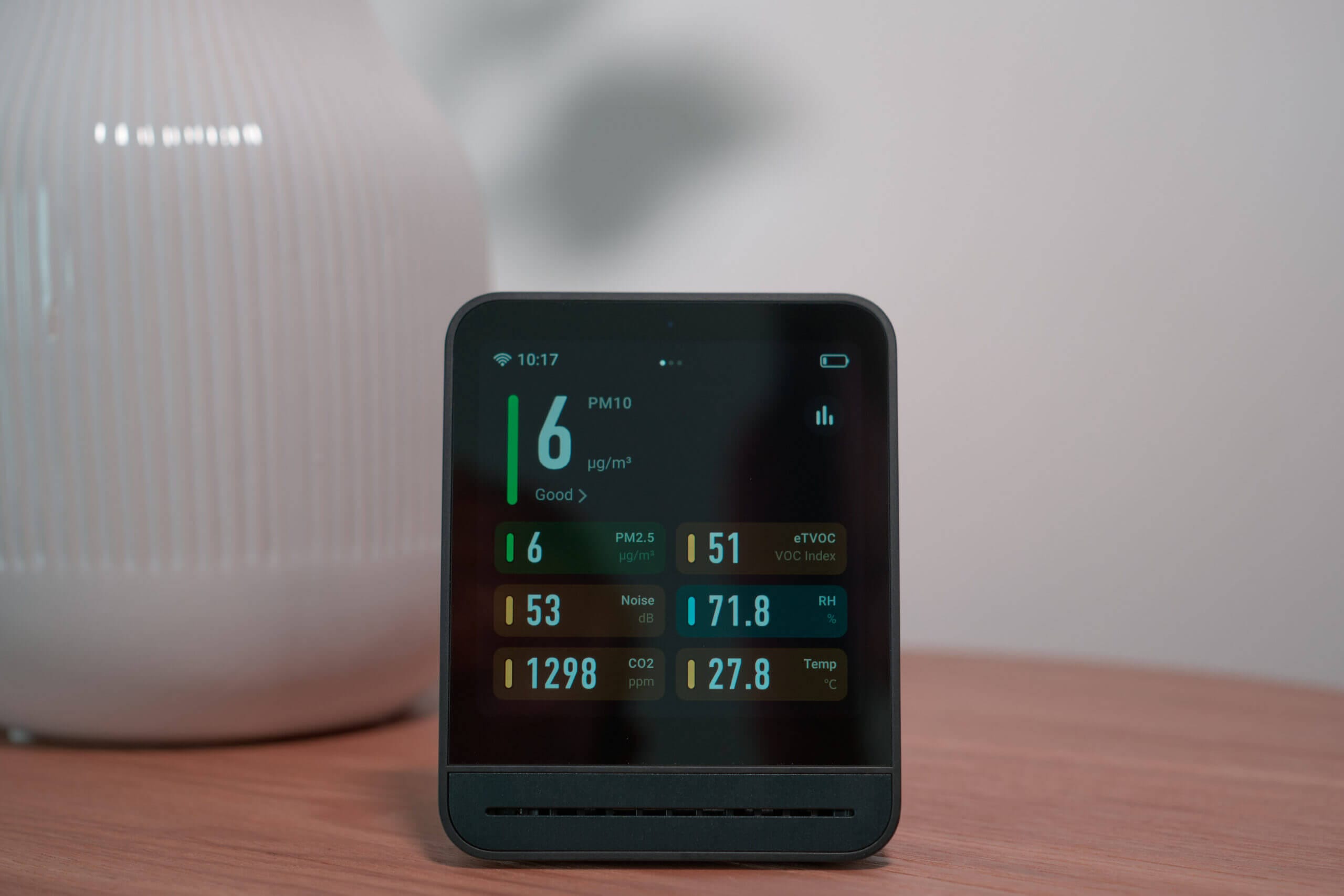

Qingping Air Quality Homescreen (2)

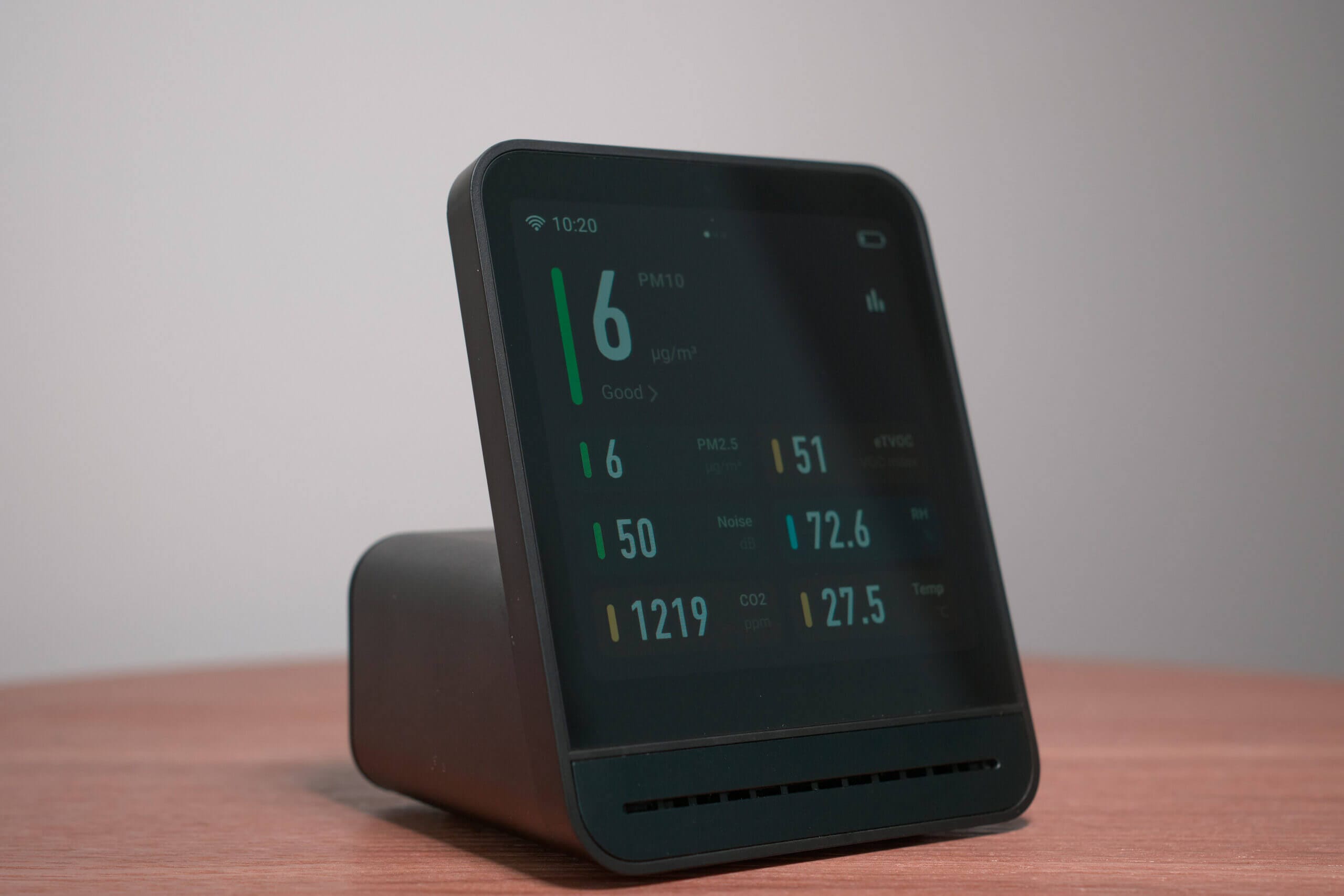

One of the aspects that makes the Qingping Air Quality Monitor have such a great user experience is the large, 4-inch touchscreen that dominates the front of the device. This significantly improved over the first generation, which sported a ‘mere’ 3.1-inch touchscreen. It’s this touchscreen that makes this indoor air quality monitor so unique. There are other air quality monitors with large screens, such as the IQAir AirVisual Pro, but very few monitors merge this large screen with touch capabilities.
Of course, a touchscreen alone isn’t particularly useful in many cases. However, Qingping has ensured that this touchscreen is a pleasure to use by ensuring it’s responsive and creating a complete UI built around the touch capabilities. Even if you’ve never used this monitor before, it’s intuitive to pick up and use, and I think anyone can navigate the UI, even with no prior experience.
An issue that many low-cost touchscreens encounter is a lack of responsiveness, but I can confidently say this isn’t the case here, as navigating the UI on the Qingping Air Quality Monitor is a breeze, and the monitor is very responsive. While you might notice a few dropped frames occasionally, it’s never had a significant hiccup over the three weeks I’ve used it.
Qingping Air Quality Second Version
In addition, the screen is high-resolution with a pixel density of 254 ppi. If you’re unsure what this means, it essentially means that there are 254 pixels for every inch of screen – while significantly lower than many modern smartphones that sit at 400 ppi and above, this is fantastic for a low-cost monitor, and the screen looks beautiful. It also appears to have much better viewing angles than the first-generation device, making it easier to see the screen at an angle.
The touchscreen is a pleasure to use, and I wanted to focus on this aspect of the Qingping Air Quality Monitor first, as it’s what you will spend most of your time interacting with and looking at. This screen also makes the monitor fantastic as a standalone device. While it does feature good connectivity, there’s no need to pair this monitor with your phone if you don’t want to, as everything can be done on the device itself – even connecting to WiFi!

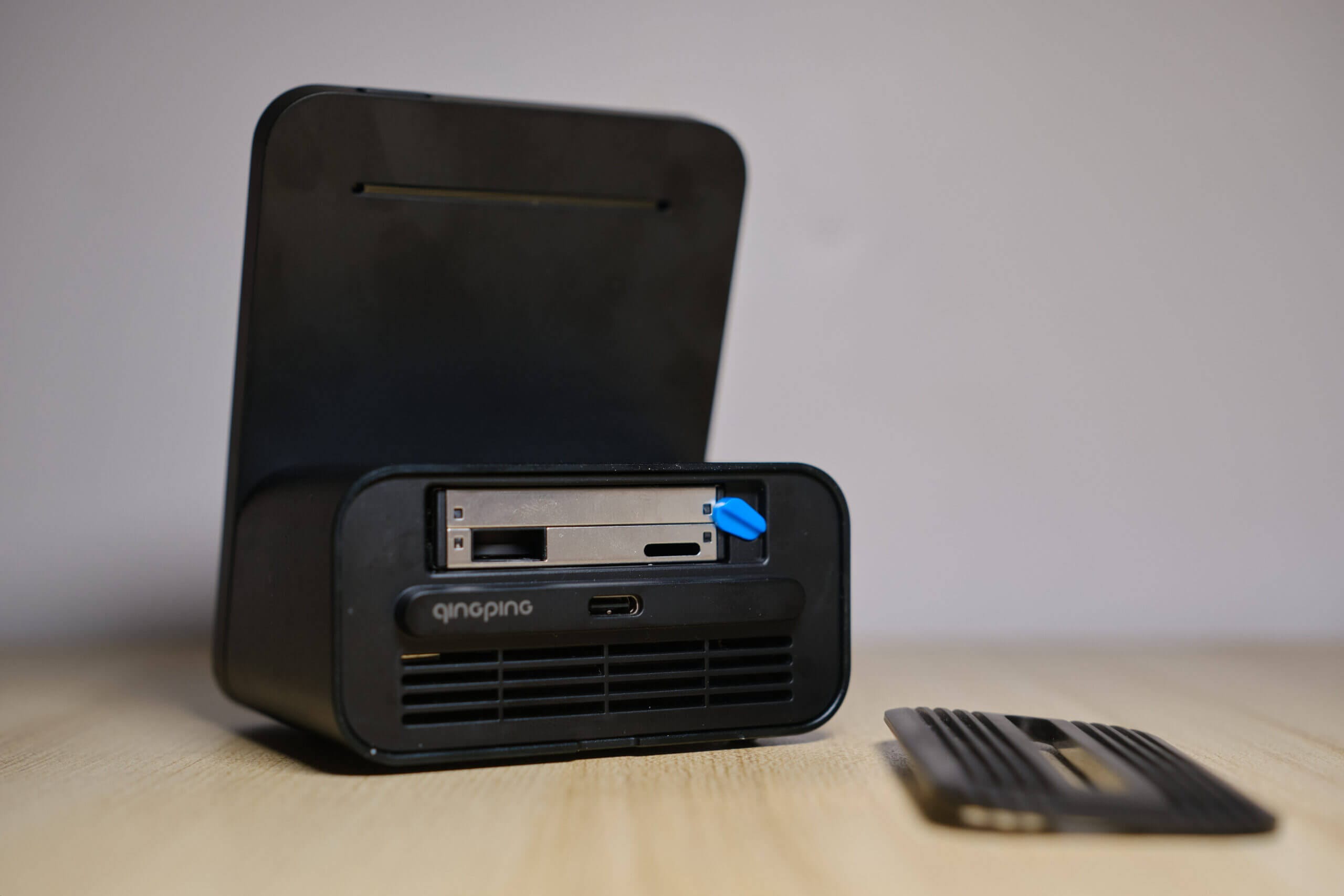

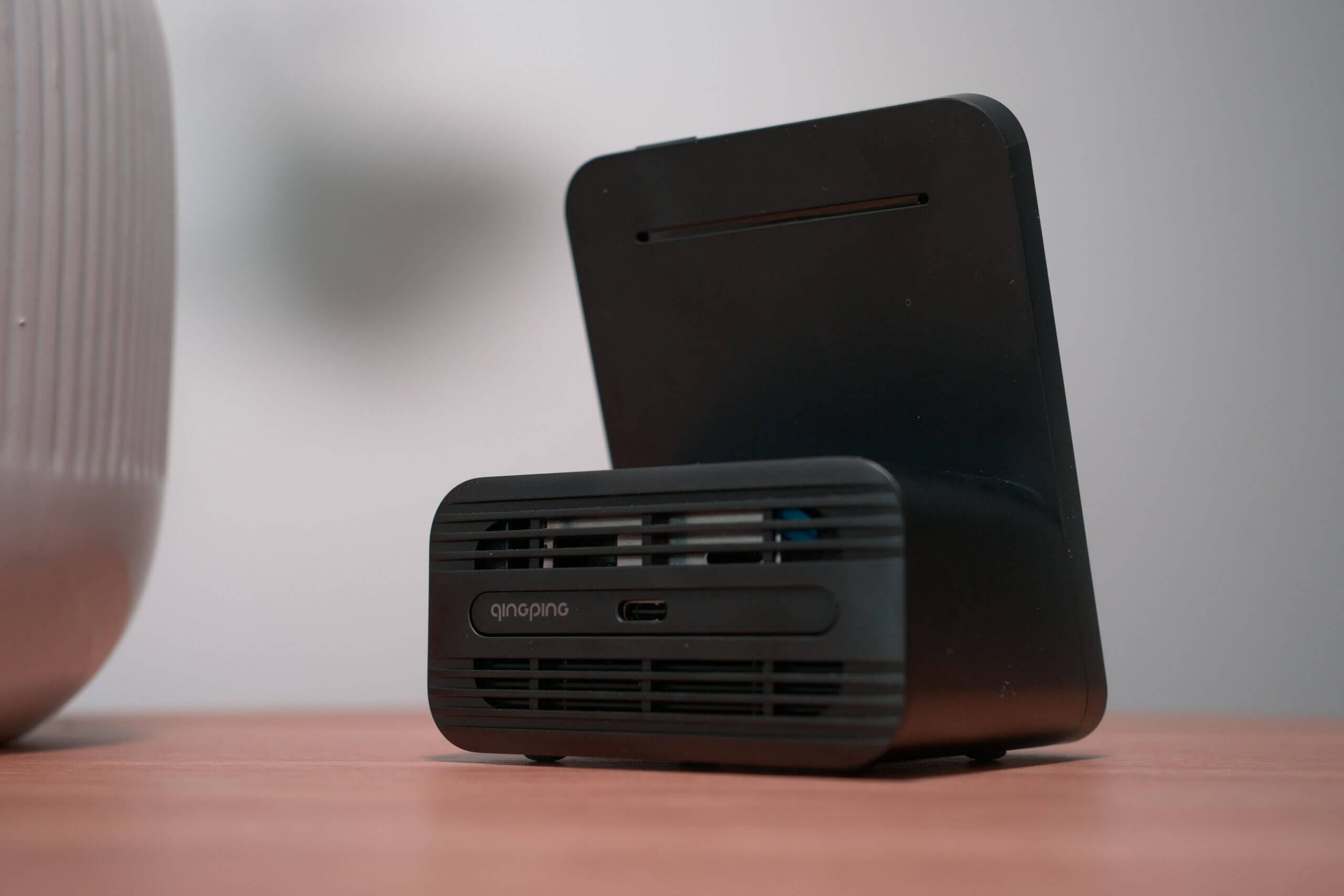

Turning the device around, you can see its interesting form factor. While the front of the device makes it look rather large, as soon as you turn it around, you can see that it is the shape of a capital L (or a reversed capital L if you turn the device around the opposite way!). At the bottom of the L is the chamber that houses the sensors, mainboard, and a small battery. Despite being an interesting shape, I’ve come to like this form factor, and it looks nice on a bedside table, desk, or otherwise.
Qingping Air Quality Monitor Back

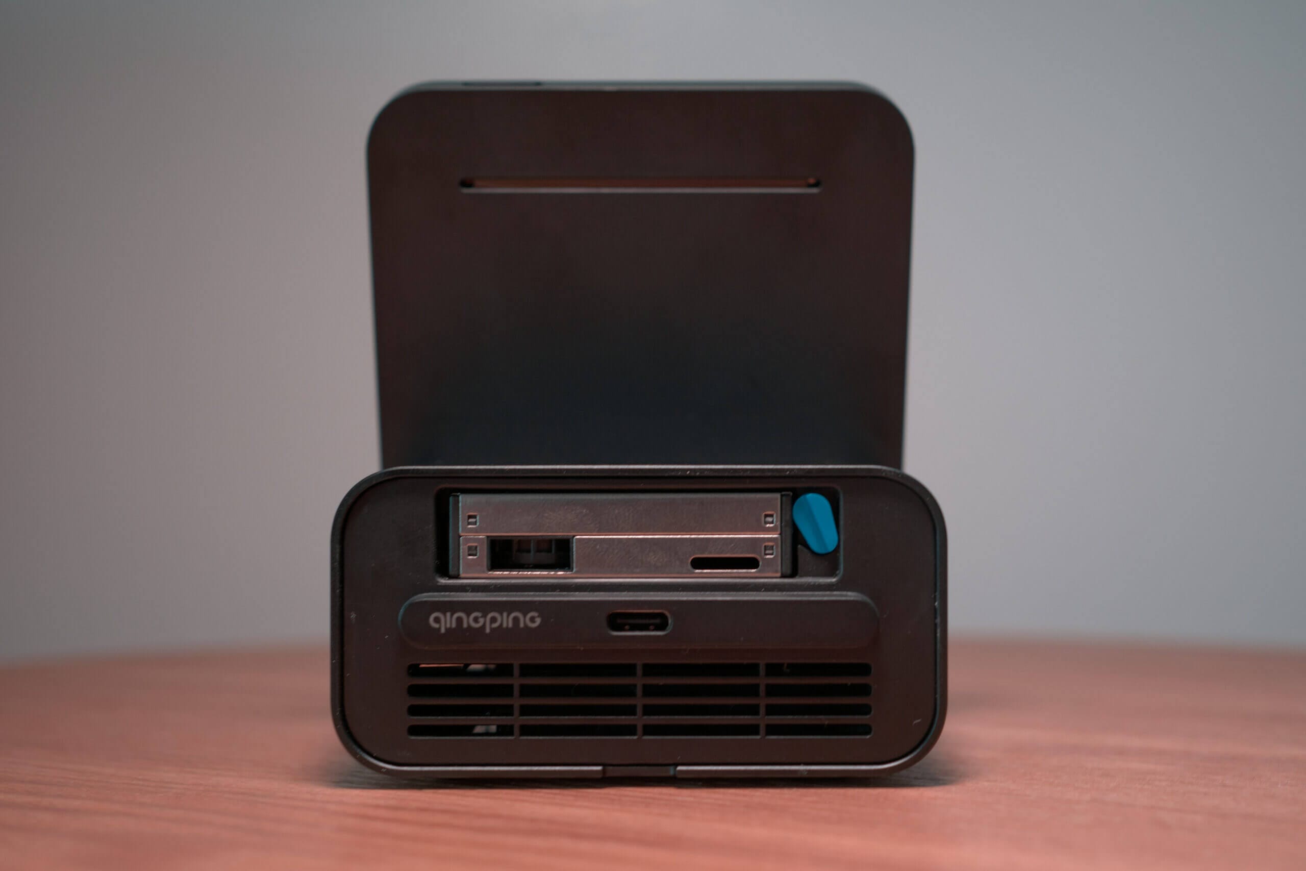

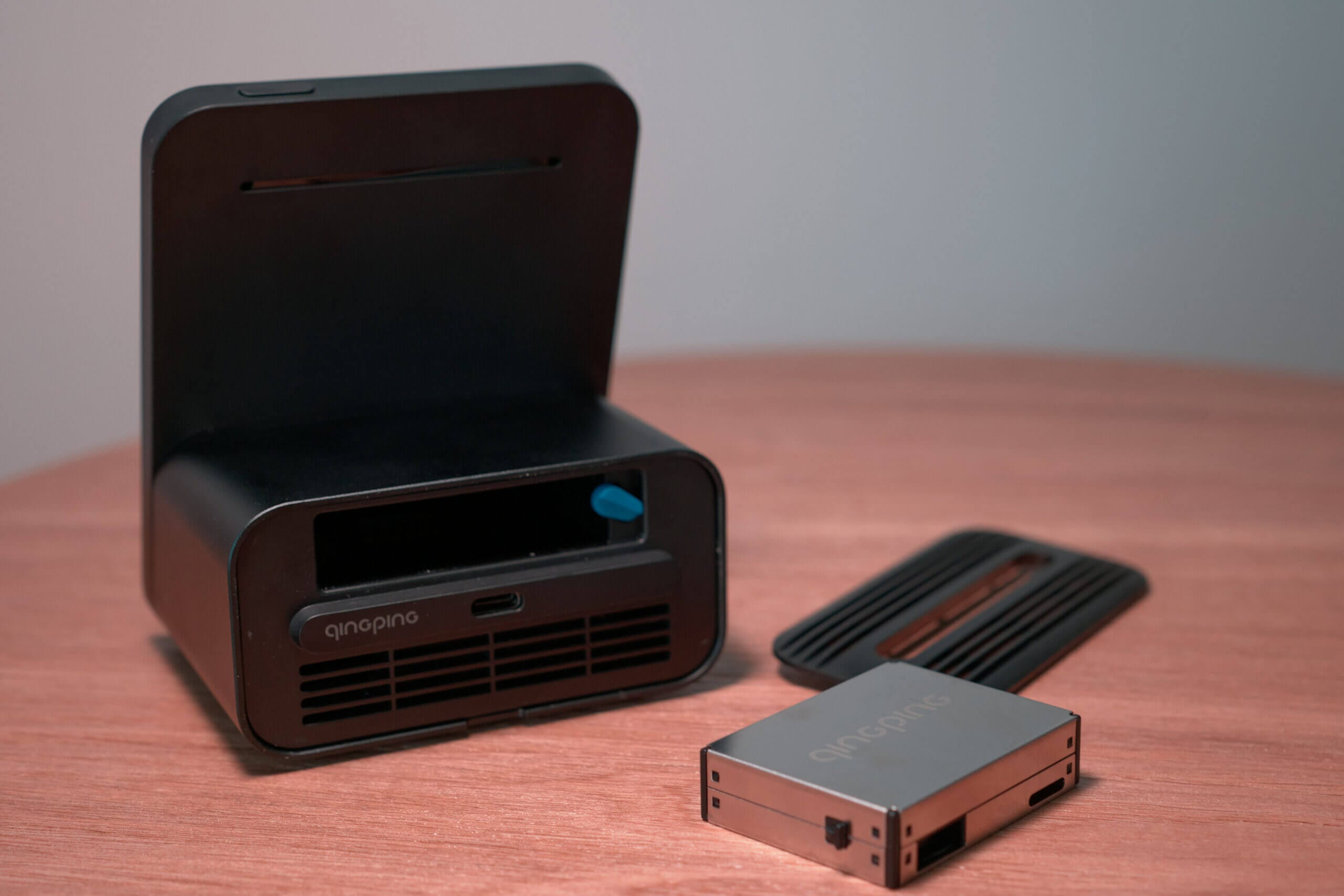

That brings us to the back of the device – normally an uninteresting part, but something that is a highlight with the updated Qingping Air Quality Monitor. Why? Well, similar to smartphones of old, the Qingping Air Quality Monitor Generation 2 has a removable backplate that hides the removable and replaceable PM sensor module. You may be wondering why they chose to make only the PM sensor user-replaceable, but it makes some sense as these modules tend to have the lowest lifespan due to their reliance on moving parts – in this case, a fan.
I assume Qingping had some issues with failing PM sensors on their previous model, which is why they made this significant change. However, I’m all for it. Being able to replace the sensor that is most likely to fail is a huge step in the right direction, which, in this case, is user repairability and increasing the lifespan of devices. Maybe I’m asking too much, but imagine a version three device with a user-replaceable battery or CO2 sensor in the bottom slot. I’m just throwing around some ideas, but wouldn’t that be cool?
Qingping Air Quality Removable PM Sensor
Either way, I love this change, and Qingping has made it exceptionally easy to replace the PM sensor. However, since it’s housed in proprietary housing, you will need to purchase the replacement module from Qingping – you can’t just buy an off-the-shelf sensor as a replacement. I’ve been told the replacements will sell for $25.

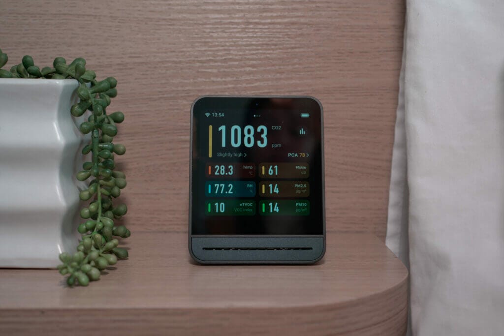

As I mentioned above, I typically wouldn’t cover the user interface in a dedicated section, but I think this device needs this section for two reasons: first, it’s very well thought out and has received a lot of attention. Second, anyone wanting to use this device without the accompanying smartphone app will rely purely on this UI, so it’s worth discussing.
The device’s home screen will change to a screensaver after a few minutes. The user can set this screen saver, and it can be customised in an almost identical way to an Apple Watch. The time will feature prominently, but you can edit every other widget on the screen and the order in which the pollutants are displayed. This is a fantastic approach and lets the user set only the information they care about to show on the home screen. You can choose from three layouts, mainly focusing on whether you want to show an analogue or digital clock.

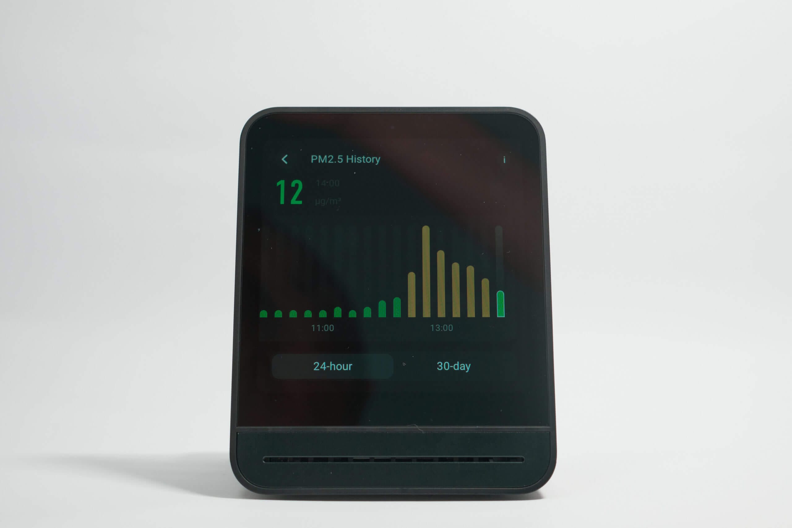

As soon as you ‘wake’ the screen by touching it, you will be met with a screen like the one in the image above. Tapping on any individual pollutant or environmental parameter will move it to the prominent position at the top. From here, you can tap the graph icon in the top right (again, shown in the image above) to see a detailed graph of your indoor air conditions over the past 24 hours or 30 days.
Qingping Air Quality PM Graph
While you can see some information on this screen, and it’s great for a quick overview, you will want to export data via the app for a full breakdown. That said, I’m glad you can see some historical data on the monitor itself, even if it is limited. One aspect that I really appreciate about this device, however, is that you can tap on the information ‘i’ to learn more about the pollutants and the thresholds.

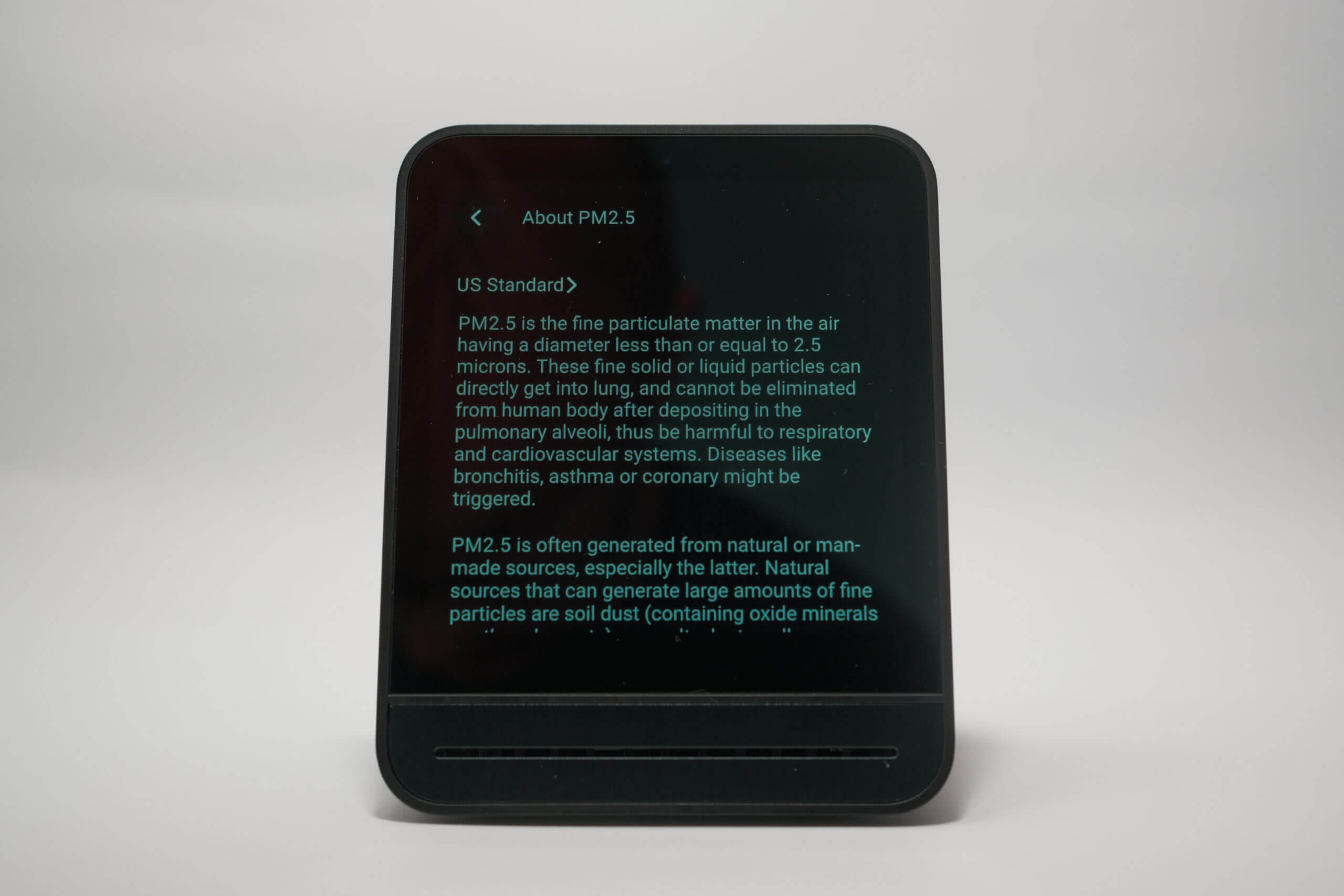

For anyone who is already aware of the intricacies of indoor air pollution, you won’t find yourself tapping on this information button very frequently. However, these snippets of information make this monitor so much more accessible for anyone who is using an indoor air quality monitor for the first time.

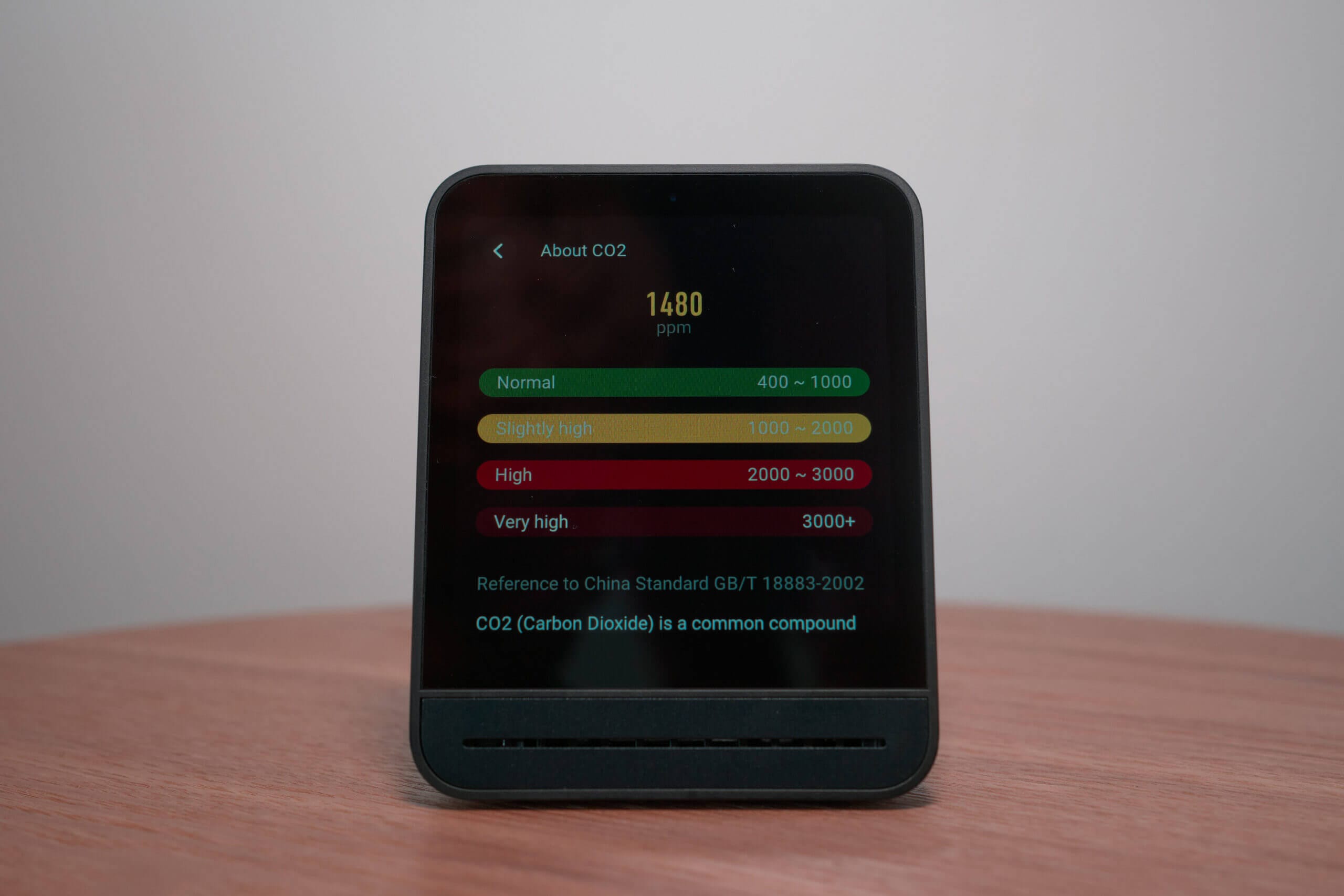

Qingping Air Quality Standards
For example, tapping the information button for PM2.5 will raise the thresholds and allow you to switch between the U.S. EPA PM2.5 standard and the China Standard. There is also a short description of the dangers of PM2.5 and common sources of this fine particle pollution. Overall, this is an excellent user experience, and I think it makes this monitor perfect for first-time users.
Unfortunately, for some things, such as carbon dioxide, the thresholds are based on the relatively lenient China Standard GB/T 18883-2002 (which is helpfully mentioned on the device). I wish there were another option for CO2, similar to how you can change standards for PM readings, but I also don’t think this is too big of an issue for two reasons – firstly, you can read the absolute concentration in parts per million easily, and you can set up entirely customisable alarm thresholds for every pollutant – but more on that soon.
Qingping Air Quality Monitor CO2 Information
While I don’t agree with all of the standards, I love how Qingping has been completely transparent about which standards they are using to base the thresholds on. Every air quality monitor should be like this, and I appreciate how they go even deeper to explain to everyone the dangers and sources of every pollutant. Let’s move on to a few other features that make the Qingping Air Quality Monitor unique!

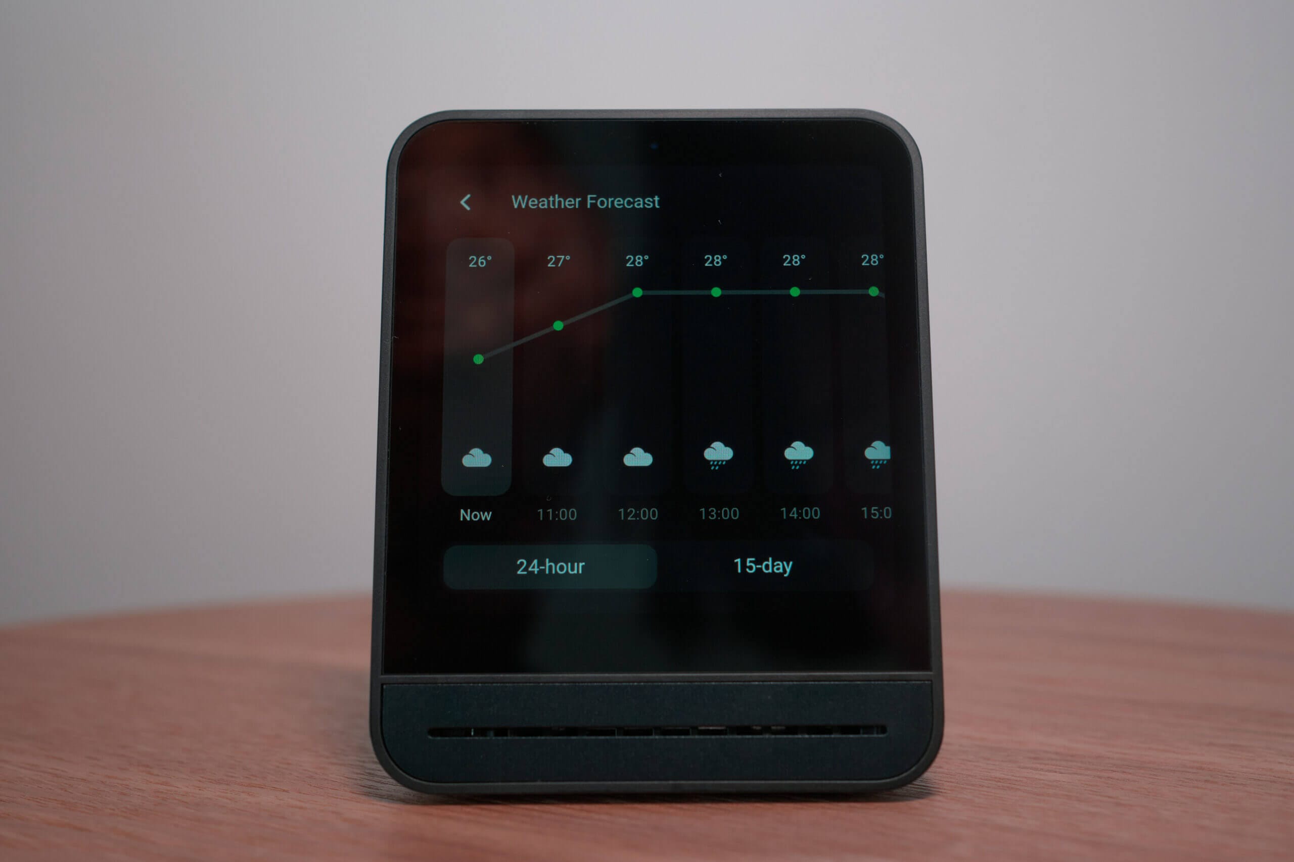

If you swipe left from the home screen, you will get to a weather station screen which shows the time, weather forecast (when connected to the internet), and local AQI and UV index. To view more information about the weather forecast, you can tap on the block and be led to the screen shown in the image below. This shows how Qingping has tried to make this device an indoor air quality monitor and a weather station for your home – they’ve certainly done a better job than some manufacturers, too!
Qingping Air Quality Monitor Weather Forecast
It is worth noting that you might not get all of this information if you live in a smaller town or city. For example, when I was in a small town in the Philippines, I couldn’t view AQI or weather information, as there were no monitors in whatever network Qingping was relying on for this information. However, in a larger city such as Davao, I can get all of the information I need on this screen.

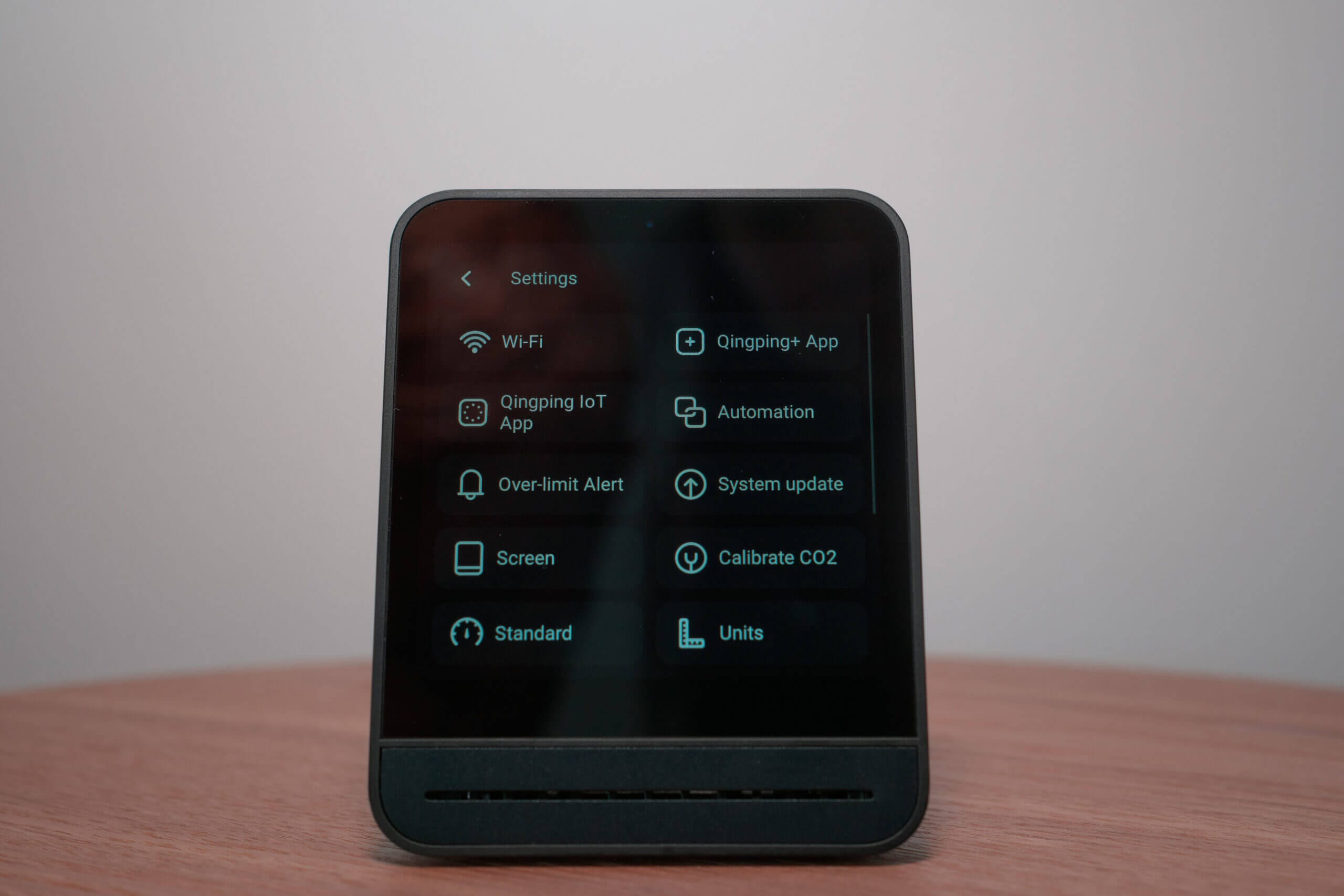

Swiping left once more will bring you to the settings screen. This screen has four buttons which allow you to set an alarm (yes! This monitor also acts as an alarm clock, which the first version did not), change device volume (pollutant alarms and the alarm clock volume can be adjusted separately), change screen brightness, and delve into the complete device settings which are partially shown below.
Qingping Air Quality Monitor Settings Screen
You can adjust the device’s settings from this screen without relying on the accompanying app. I absolutely love being able to do this, and you can even perform advanced functions such as calibrations here on the device. While there is much to talk about here, I want to focus on a few particular aspects.
Firstly, the over-limit alert settings will allow you to set alerts for every parameter this device measures. That means you can set alarms for everything from PM2.5 concentration to noise levels. The best part? You can manually set the exact thresholds and even adjust if the alarm is a minimum or maximum threshold. Why can’t more companies introduce this completely customisable alarm functionality? It’s fantastic.
Secondly, you can update the device from this screen. This is worth noting because a community member found some bugs with the device and reported them, and the Qingping team fixed them within two weeks. Based on this, the support of this device again appears to be fantastic, and there may be more updates to come down the line.
Overall, the Qingping Air Quality Monitor Generation 2’s UI is fantastic and feels much improved over the first generation (which I still liked). I know this section may seem overly positive, but I really appreciate this device’s UI and overall user experience. Besides a few questionable standards, there is so much to like here, and I think this might be the best monitor to recommend for new users.

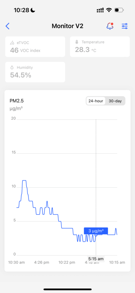

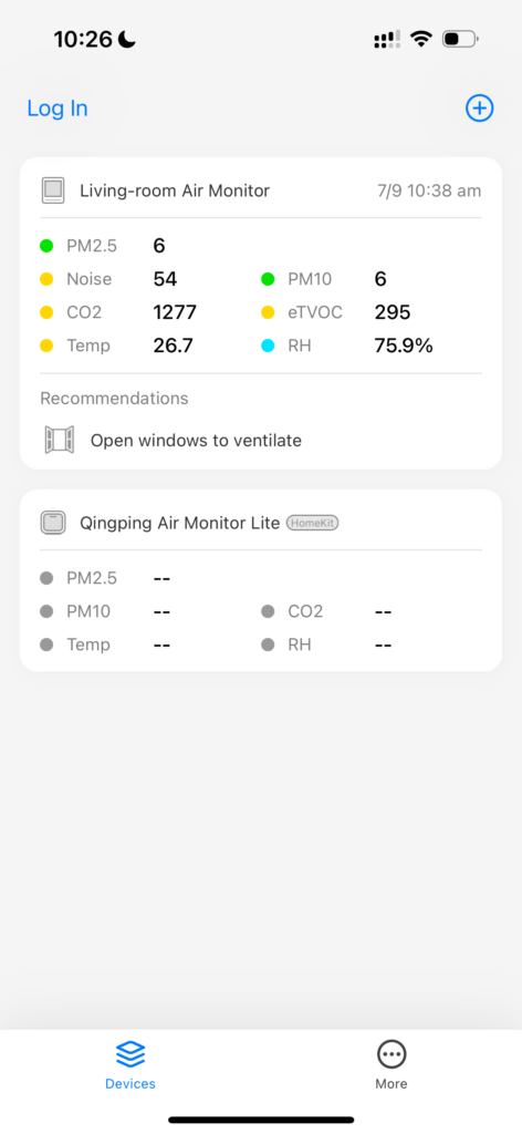

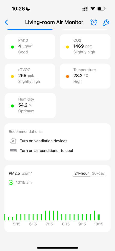

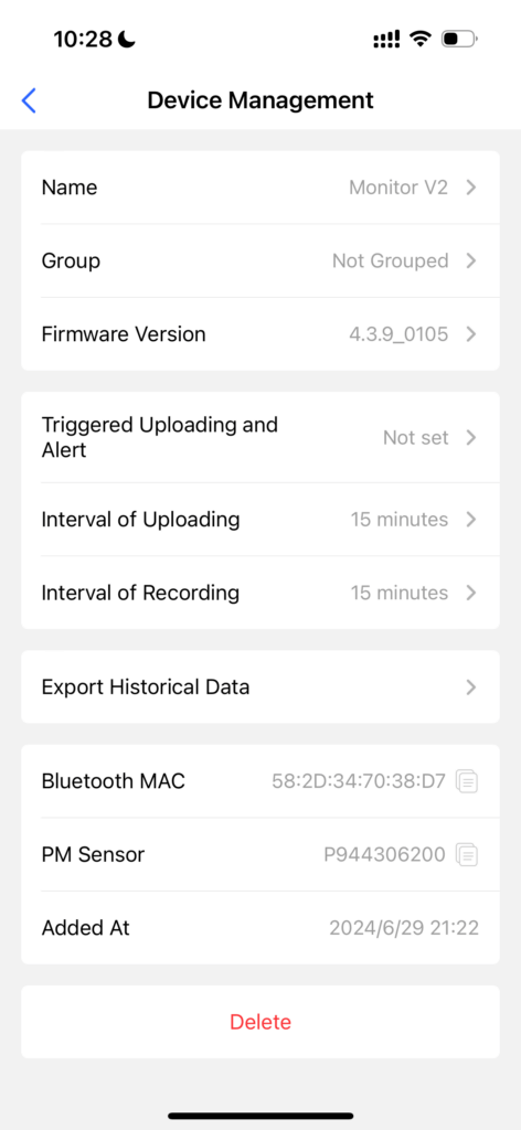

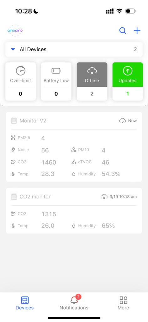

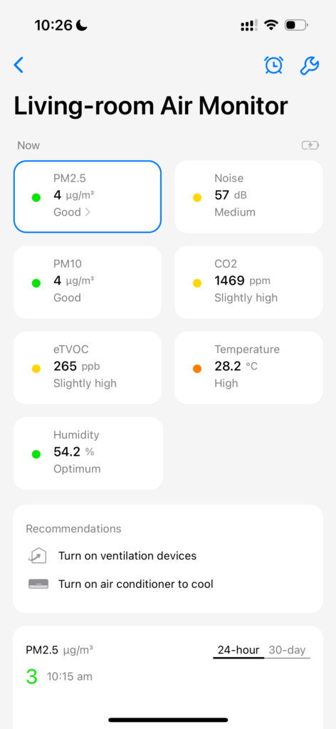

Above are some screenshots from the Qingping+ app. One of my pet peeves with these kinds of apps is that they often require you to log in. While Qingping does try to make you log in, you can skip this process and use the app without an account. I am a fan of this approach, and I hope it will stay so in the future.
From the app’s home screen, you can see the data from your connected Qingping monitors and some suggested actions. Tapping on a monitor will take you to a more detailed screen that breaks down all measurements and provides a historical graph. While the graph in the app is limited, there is an option to export data, which is much better for anyone who wants to break down their air quality trends. Unfortunately, exported data can only be shown in 15-minute increments, so I hope this is adjusted in the future.
What surprised me the most about this app is its few settings. Sure, it makes sense since everything can be done on the monitor, but you can’t do much other than export data and change units in the app. For example, you can’t calibrate CO2 from here (which would be nice, as I like to leave my monitor near a window and trigger a calibration that way).
Is this a big deal? Probably not, considering the settings are there – they’re just housed on the monitor instead of in the app. That said, I would love to have duplicates of all settings in the app for the sake of simplicity and convenience. After all, sometimes I don’t want to get up to change monitor settings.
Overall, the Qinping+ app is fast and straightforward to use, and I have no qualms with it. However, it does feel very simple and almost lacking. Of course, you can change all of the needed settings on the device itself, but I can’t help but feel like it would be nice to also have these options in the app. Thankfully, this doesn’t impact the device’s usability much, as everything is there, just not on the app.

    The CO2 log looks promising. But what about the CO2 sensor autocalibration? Have you discovered anything about it?
    This (and the dataseet) looks like Sensirion SCD40 allows “ASC” either enabled or disabled (default=enabled), period=weekly, and this setting could be easily changed. But the Qingping CGS2 Air Monitor User Manual only mentions that there’s a “Calibrate CO2 Reading Manually” option, without saying anything about the automatic calibration.
      You’re welcome! I’m glad you found it useful.
      The Qingping Air Quality Monitor Gen 2 allows the user to disable automatic calibration on the monitor or the Qingping+ app. Interestingly, I can’t find a toggle on the Qingping IoT app. But anyway, yes, it does allow the user to enable or disable automatic calibration and manually calibrate the device when needed.
      Interestingly, the automatic calibration period can not be changed, and I’m unsure what it’s set to on this device. I would guess it’s left as the default 7 days, but it’s possible that Qingping changed it.
      I believe all Qinging devices allow you to disable automatic calibration which is fantastic. It would be even better if they would allow us to adjust the calibration period, too!

    I’m reading 90 on the eTVOC index (or 491 ppb) in the living room, now I’ve been dealing with a persistent dry/super mild sore throat for about 7 months now and it could be any factors of course, went to docs and they can’t find anything, but anyways, is that reading something to be concerned about, in your opinion? Oh and we did get a new furnace few years ago so not sure if there would be an issue with hvac. Thanks!
      Hi, @rgeysbeek. Thanks for joining the forum! I’m glad you’re enjoying your monitor.
      Honestly, it’s tough to tell exactly how the Qingping device works regarding eTVOC, as they’re not very transparent on the matter. If you’re curious to see a (very) long conversation about the topic, please feel free to check out this thread:
      Here is Qingping’s response:
      The method of obtaining the VOC index readings by Qingping air monitor 2 is the same as Sensirion, but the evaluation method is different.
      Since the Qingping Air Monitor 2 allows the VOC readings to be switched to mg/㎥ or ppb, we have a specific evaluation standard for mg/㎥ and ppb, which aligns with this scale.
      So, in other words, Qingping’s index uses ‘absolute’ readings and follows a Chinese standard (found here: https://www.mee.gov.cn/…
      However, based on the screenshot below, 90 should indicate that VOCs are increasing (compared to a relative baseline, which I assume must sit somewhere in the ‘good’ range). While the ppb reading is also not ideal (for reasons mentioned at the top of the thread I linked above), it’s probably a better measurement to get a general overall of your VOC levels in the longer term. The index is always adjusting, and therefore, isn’t good for identifying much other than decreasing, steady, or increasing levels of VOCs.
