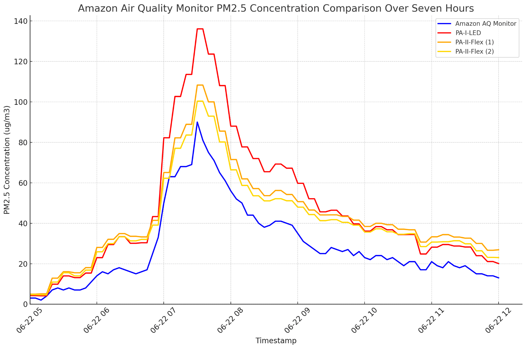

The first comparison I carried out compared the peak reading (which can’t be changed) from the Amazon Smart Air Quality Monitor (in blue) to three Purple Air devices in five-minute intervals. When I first saw this graph, I was instantly worried – it looked like the Amazon monitor was significantly underreporting concentrations compared to the Purple Air monitors.
I then repeated the experiment and had similar results, as shown below. I was confused, though, as the Sensirion SEN54 is generally decently regarded and should be relatively accurate, so I would expect the same from the SEN44. Yet somehow, the Amazon monitor always underreported. After researching, I realised that the issue was likely with the raw data I exported from the Purple Air monitors.
Amazon Smart Air Quality Monitor Accuracy (2)

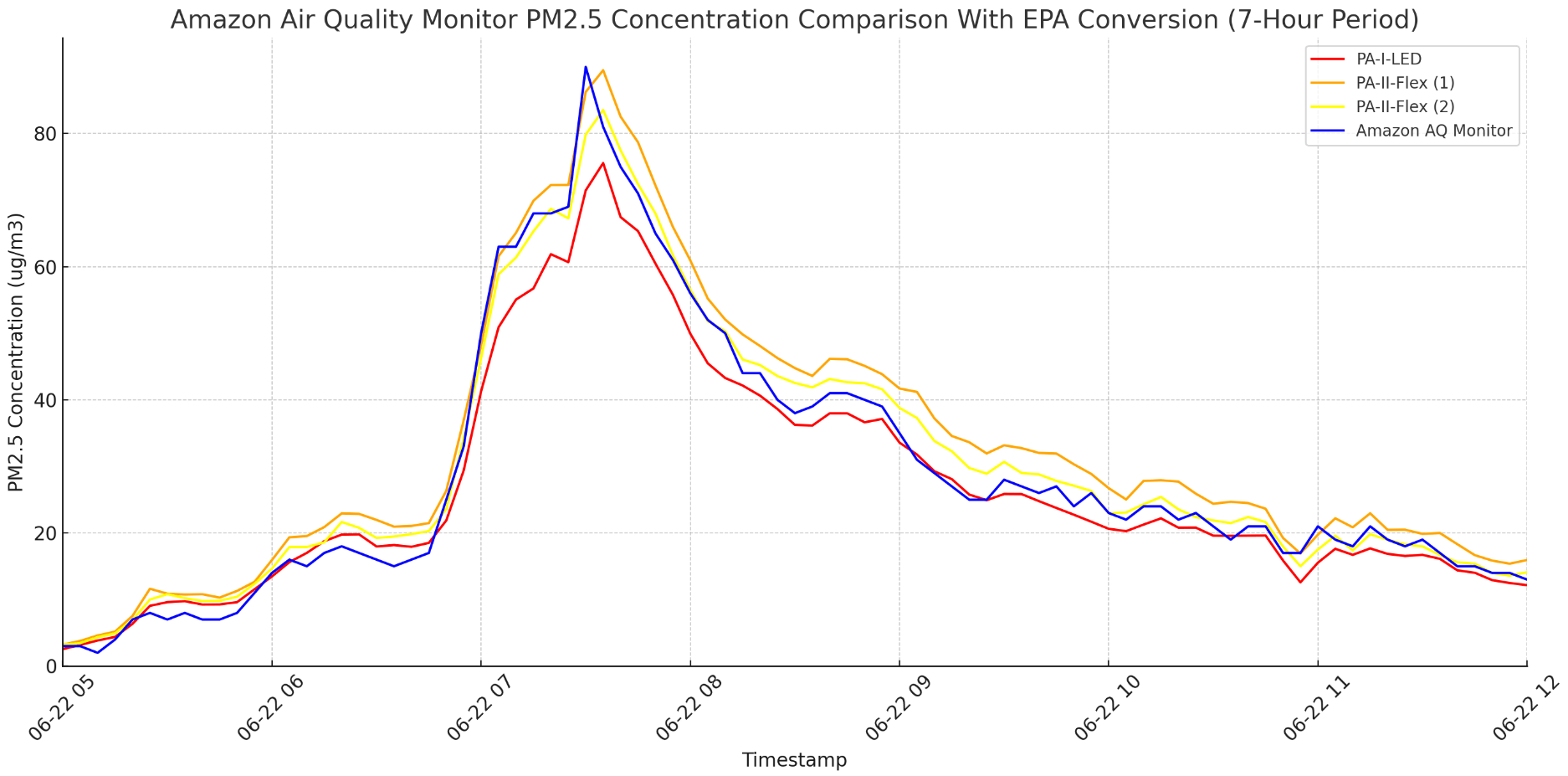

If you’re not aware, Purple Air monitors are good monitors, but by default, the raw PM2.5 concentrations they report are significantly above what reference equipment reports. This is especially true for smoke events, which were the primary source of pollution during my testing of the monitors. For this reason, the U.S. EPA (Environmental Protection Agency) created a correction formula to correct the monitors’ data, which has been proven to improve accuracy significantly. I thought it was worth a try, so I changed the Purple Air data to be corrected and plotted the Amazon Smart Air Quality Monitor’s data again.
Amazon Air Quality Monitor Accuracy vs PurpleAir
After applying corrections, you can instantly see a noticeable change, with the Amazon Smart Air Quality Monitor reporting very similarly to the Purple Air monitors. Despite doing much research, I can’t tell exactly what corrections Amazon or Sensirion has added to the monitor or sensor. Still, it appears to perform well, and it reports very similarly to the (corrected) Purple Air monitors.

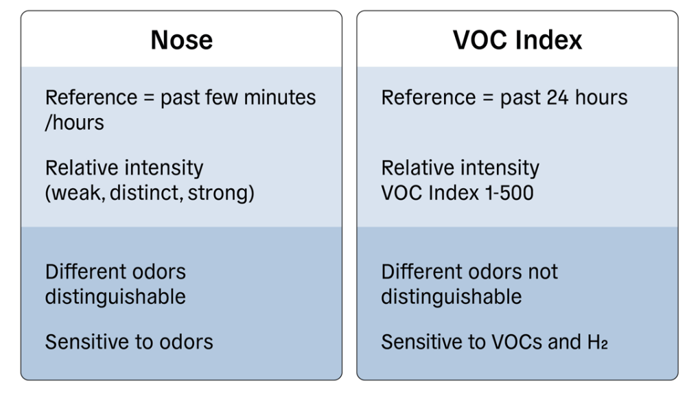

Now, let’s move on to what many people will consider the next most important metric to monitor – VOCs or volatile organic compounds. Generally speaking, the Sensirion VOC sensors are decent and some of the most commonly used in the field. However, there is one very important factor to keep in mind. Sensirion’s sensors, as with many other brands, do not show absolute VOC values, instead, they use an index which shows relative values.
Sensirion VOC Index
Sensirion VOC index.
While Sensirion’s index is on a 1-500 scale, Amazon has changed that to 1-100 for the Amazon Smart Air Quality Monitor. This means that you should not use the number displayed for VOC concentration as an absolute but as a relative indicator of increasing, decreasing, or steady VOC levels. These sensors set new baselines every 24 hours, and that baseline constantly adjusts, meaning you can’t view absolute concentrations in the app. While I’m unsure what Amazon sets the baseline at, it appears very low (I’d guess either 1, 5 or 10 is the baseline).

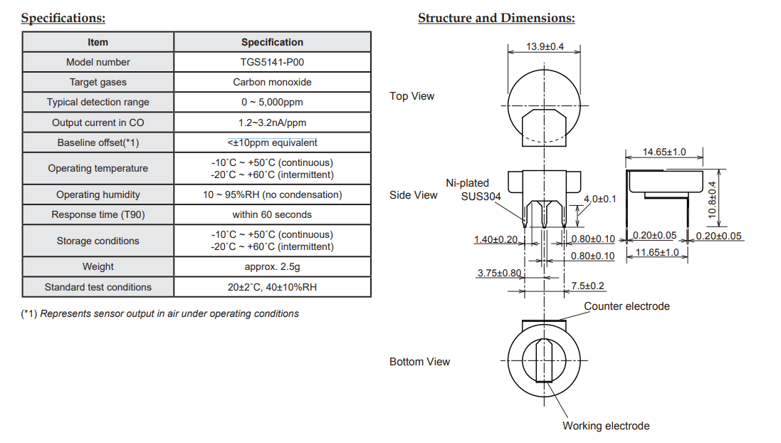

This leads us to the final sensor – the Figaro TGS5141 – used to measure CO (carbon monoxide). Once again, this monitor should not replace or be used in place of a certified CO monitor. That said, having another CO monitor that provides absolute values can be handy in some situations. Unfortunately, those situations are likely quite rare.
Figaro CO Sensor Specs
Above are Figaro’s official specifications for the sensor. As mentioned, the baseline offset is <±10ppm, meaning that up to 10ppm, the sensor may not record any concentration. Considering that outdoor concentrations rarely exceed ten ppm and that indoor concentrations will likely only exceed that concentration when smoking or, potentially, cooking, this has very limited usefulness. Is there a disadvantage to having this sensor included? No, but it definitely shouldn’t be relied upon, and its usefulness is questionable. I would’ve much preferred to have seen a CO2 sensor included, even if it would’ve increased the price by $10.

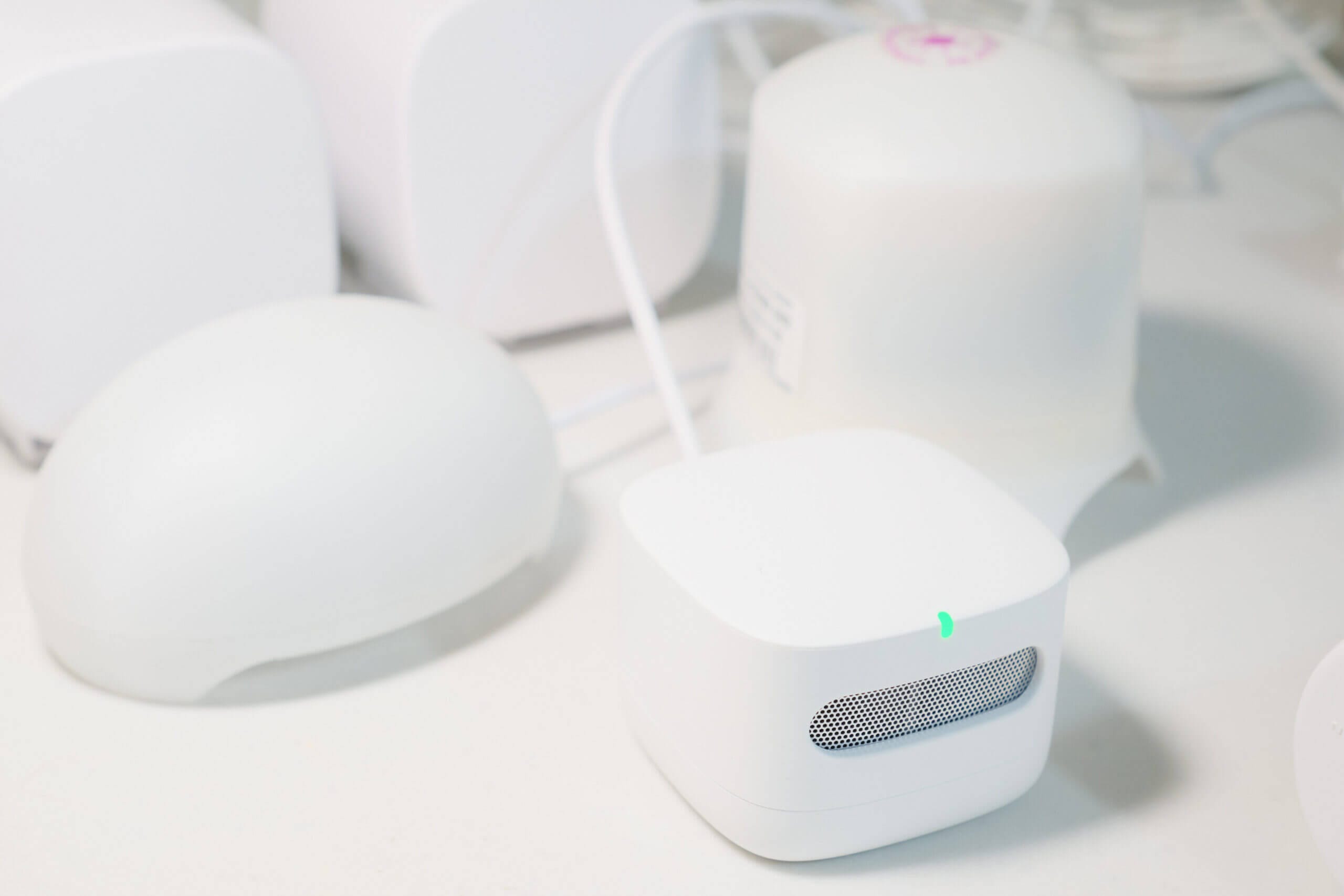

Amazon Smart AQ Monitor Front

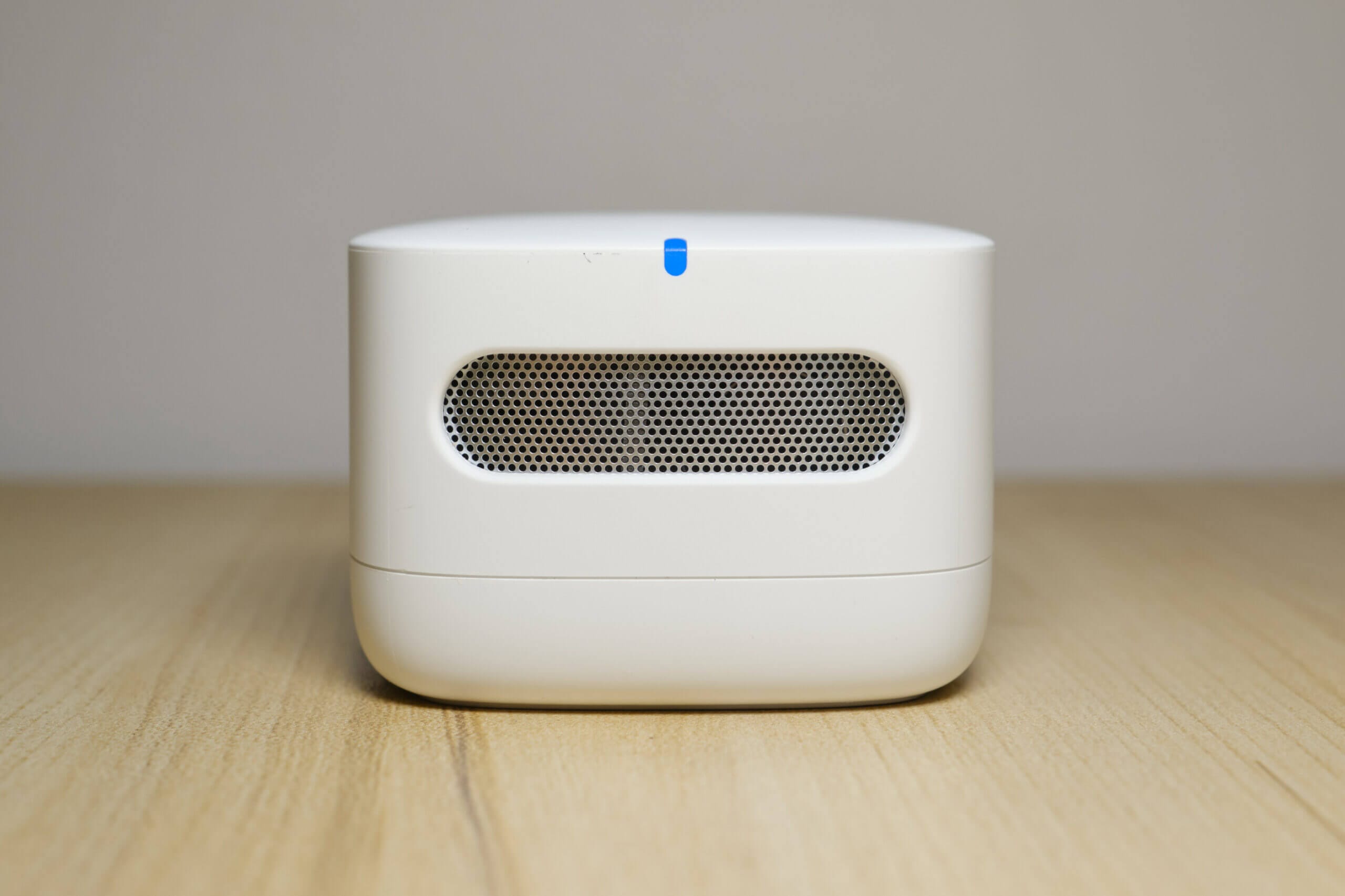

For many, the Amazon Smart Air Quality Monitor’s unassuming and minimalist design is its most appealing aspect. This is probably the most simple-looking air quality monitor I’ve ever reviewed, and it gives me a feeling similar to that of the Qingping Air Monitor Lite. That’s not to say the monitor feels cheap or low-quality – quite the opposite! The monitor is compact but weighty, and the plastic feels high-quality.
There are a few obvious things to note here. Most importantly, the device doesn’t have a screen or display, meaning that the monitor is useless on its own. Instead, you will need to use the app any time you want to interact with the device. While there is a small LED on the front of the device, this only indicates your overall air quality score and lights up either green, yellow, or red based on the Amazon AQI, which we will discuss in the next section.
The design feature that stands out the most is the vent, which covers the front of the device. This vent allows air to enter the device, and right behind it, both the intake and exhaust fan from the SEN44 sensor sits. While I had some apprehension about this vent and felt that it might restrict airflow, the sensor appears to perform the same inside and outside the case.
Amazon Smart AQ Monitor Underside
Turning the device around, you will find the only button on the back. This button allows you to power on and off the device and enter the manual setup and factory reset modes. A quick tap will also briefly enable the LED so you can get a quick (but very limited) insight into your indoor air quality. It’s worth noting that this function is only needed if you turn off the LED in the app; otherwise, it will always be on.
You will find some regulatory information on the bottom of the device, a QR code to manually add the device to Alexa, and two interesting features. Firstly, the Micro-USB port is used to power the device. I can’t believe I’m saying this still in 2024, but there’s no excuse for Micro-USB. Type-C is so cheap these days; even $10 devices have Type-C ports on them. I can’t see any justification to continue using this outdated technology (to be fair, a few air quality monitors still use these older ports, but that doesn’t save them from my criticism either!).
Secondly, the device has a standard tripod mount on the bottom. While I can’t imagine a situation where this is particularly useful, there’s no downside to having this extra mounting option. I’m sure some people would appreciate the mounting mechanism.

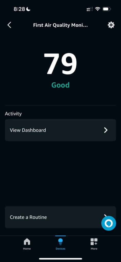

You will need to use the Alexa app on your smartphone to use this device. While the app is named Alexa, you don’t need any other devices to use the Amazon Smart Air Quality Monitor – just your smartphone and the monitor are enough to get started. While the pairing process can be straightforward, with your phone detecting the monitor, I couldn’t find it, so I had to scan the code on the back of the manual or the bottom of the device. Thankfully, this instantly solved any further problems, and pairing was painless.
After a seven-minute calibration period, you can begin accessing data from the monitor. To access this data, view the ‘Devices’ tab and navigate to your air quality monitor, tap on it, and you will be presented with a range of measurements. At the top of this screen, you will see an IAQ (indoor air quality) score out of 100 (with 0 being the worst and 100 the best). This score considers temperature, humidity, particulate matter, carbon monoxide and VOC values and aggregates them into one reading.

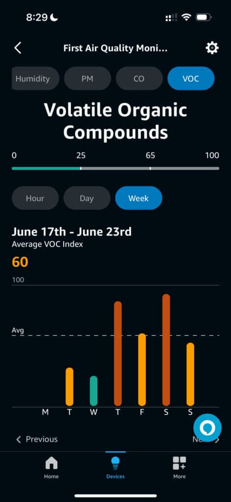

While some might find this useful, viewing the individual metrics below the overall score is far more important. Here, you can see breakdowns of each environmental variable and pollutant in further detail. From what I can tell, these are updated every 30-60 seconds. Tapping any value will take you to the graph section, which shows each factor’s historical trends in an hourly, daily, or weekly view. As mentioned in the accuracy section, each value is the peak recorded during that period, not the average. This skews the ‘averages’ that the app shows on each graph, as these are actually just the averages among the peaks for that period.
It’s also worth noting that Amazon’s thresholds, based on EPA guidelines, are still quite lenient. Let’s take the PM2.5 reading, which Amazon considers ‘good’ if it’s between 0µg/m3 and 35µg/m3, ‘moderate’ from 35µg/m3 and 150µg/m3 and ‘bad’ above 150µg/m3. While the EPA does state that 35µg/m3 is the upper limit for ‘acceptable’ PM2.5 exposure over 24 hours, it’s important to note that it’s only considered acceptable as an average for 24 hours, and we see new, stricter guidelines get released frequently from different organisations as the severity of air pollution is recognised.
While I am glad to see Amazon use guidelines from trusted organisations, I wish there was at least an option to manually set thresholds, in which case I would likely set mine at 15µg/m3. Similarly, the CO thresholds are based on EPA guidelines, and the temperature, RH, and VOC thresholds don’t state their source, but they are arguably less important, and the VOC index is relative.
