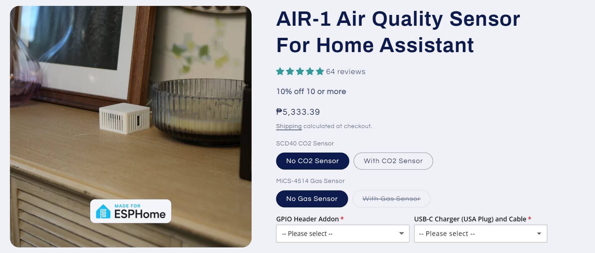

The Apollo AIR-1 is customizable before you even complete your purchase. On the website, you can purchase the basic model with only the SEN55 all-in-one sensor (it measures PM, VOCs, NOx, temperature and relative humidity) or choose to add a CO2 and chemical sensor to your monitor. Naturally, adding these extra sensors will also increase the price, meaning customers have flexibility over what monitor they want and what they are willing to pay.
I chose to get the complete monitor with both additional sensors for the sake of testing. However, I don’t think this is the best configuration, and it’s also not the one I would recommend. I will discuss why soon, but for now, let’s list the sensors that can be found inside this rather small monitor:

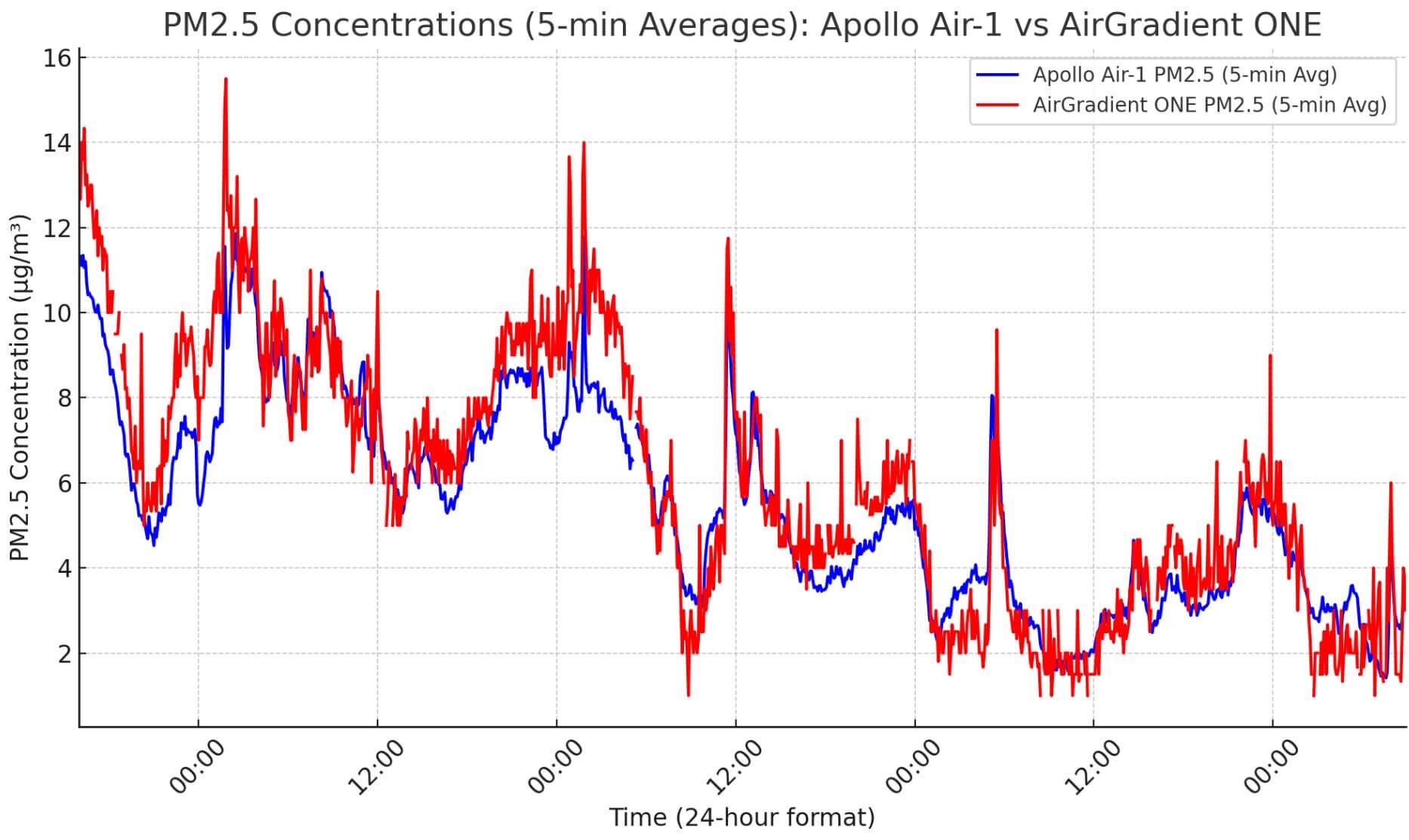

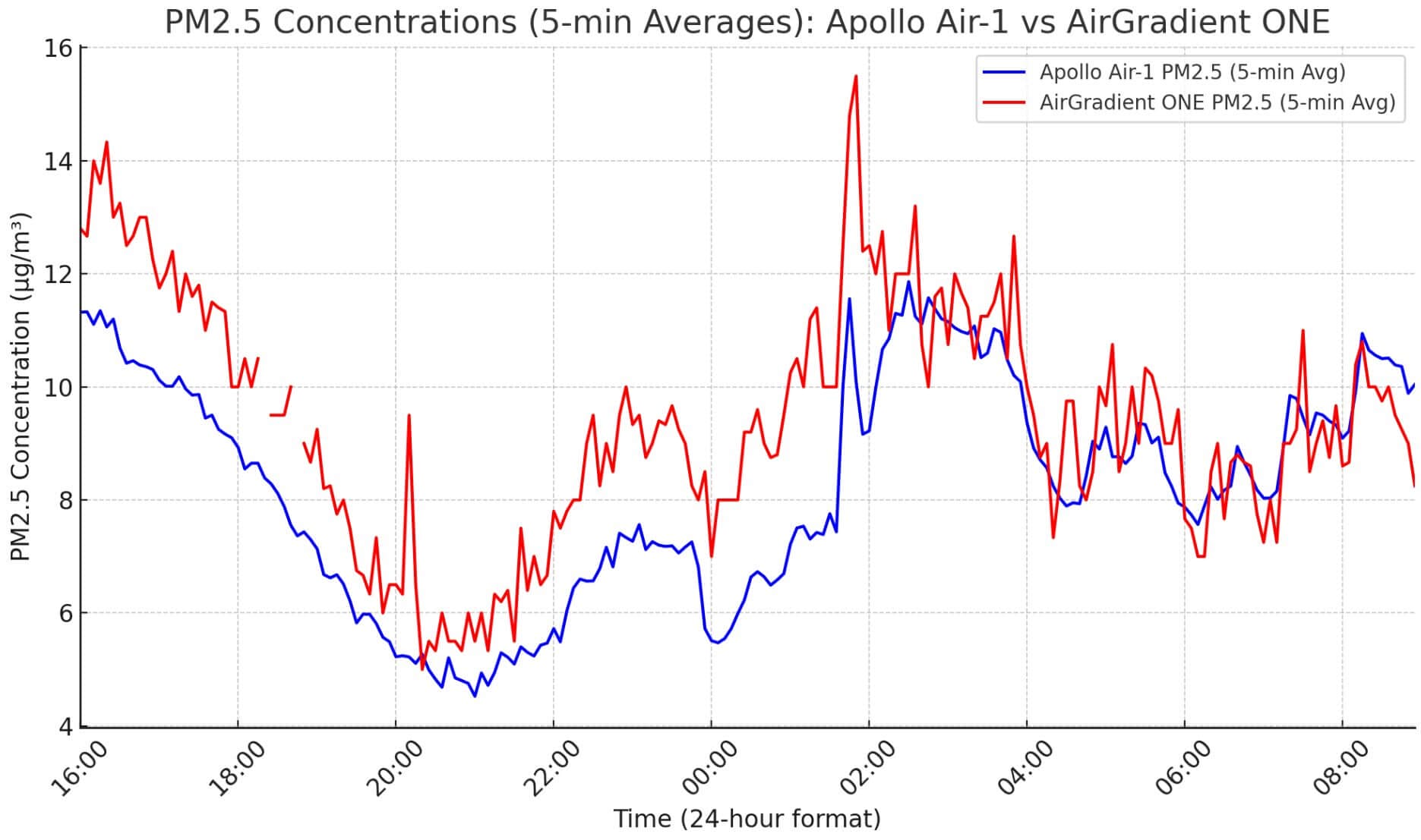

I wanted to test the PM2.5 values compared to my AirGradient monitors. As you can see on the graph below, the AirGradient ONE typically reported higher raw concentrations than the Apollo AIR-1. It also appeared to provide more varied ratings, whereas the Apollo followed a more consistent trend. Either way, it’s good to see that the monitors correlate well.
It’s important to note that the AirGradient ONE uses the Plantower PMS5003, and this sensor is known to overreport PM2.5 concentrations (which is why monitors like the PurpleAir Zen and Flex, as well as the AirGradient monitors, use an EPA-developed algorithm to improve accuracy). With this in mind, I would actually lean towards the Apollo AIR-1’s PM2.5 readings as being slightly more accurate – at least when it comes to raw values.
AirGradient vs Apollo PM2.5
I also compared a shorter period to make the graph easier to follow. You can see the graph below. As expected, the AirGradient consistently reports higher values at higher concentrations and similar or lower values at lower concentrations. This aligns with my expectations and is a good sign for the Apollo AIR-1. More importantly, we can see that both monitors pick up on the same trends, and they are both more than capable of informing the user if they need to take action, such as turning on an air purifier or opening (or closing) the windows.
AirGradient vs Apollo PM2.5 Readings
Overall, I would say the Apollo AIR-1 and its SEN55 are accurate for PM2.5 concentrations. While I wouldn’t rely on the other measurements as much – especially PM10 – it’s an issue with all of these low-cost sensors and is far from isolated to the Apollo device. While you can use the PM10 values to indicate actual concentration, it’s important to note that the readings will always be closely tied to PM2.5 readings, which is not always true with actual particles.

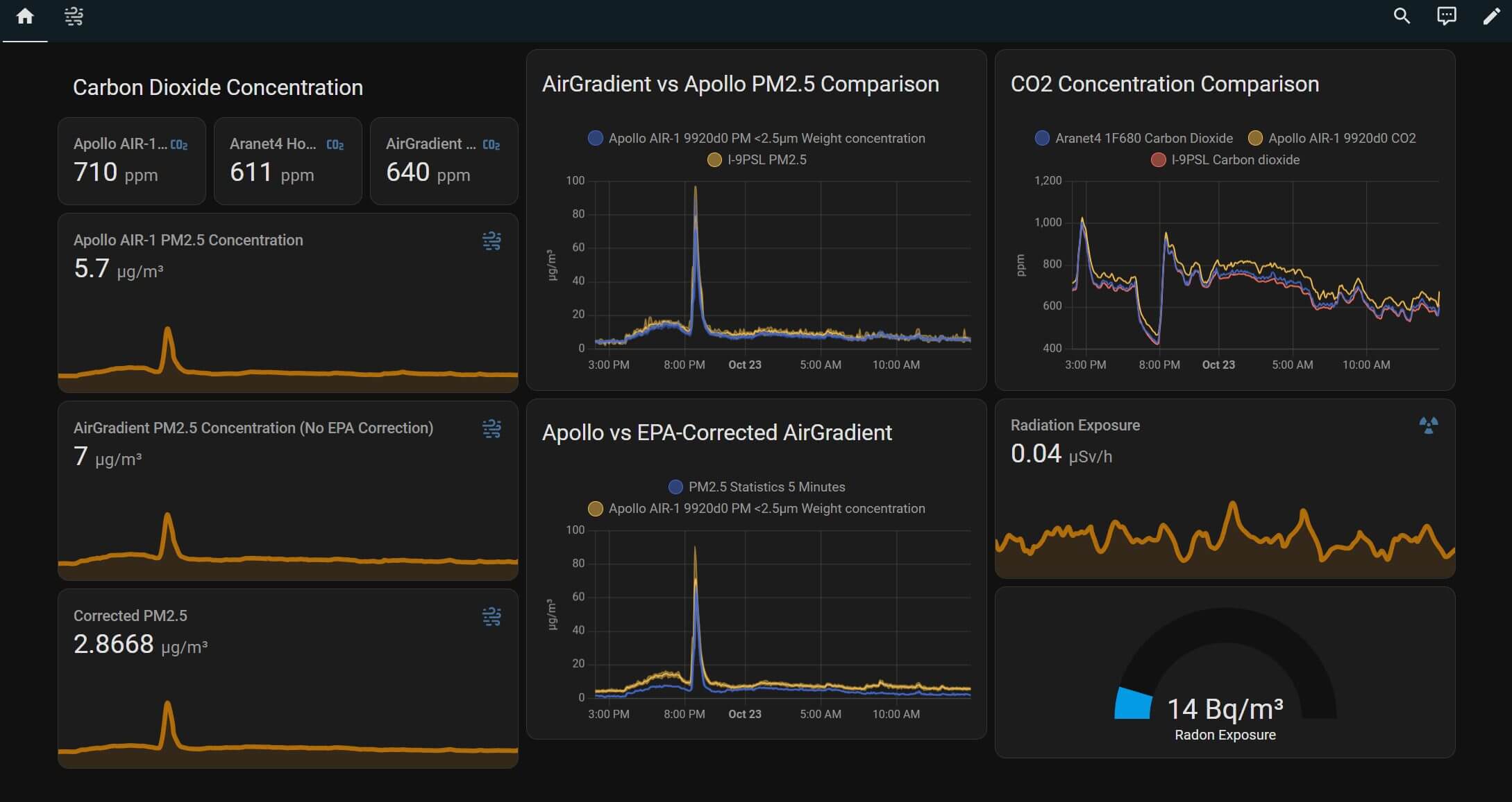

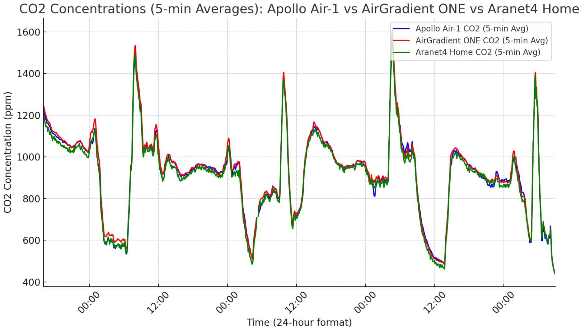

Moving on, I also wanted to check the accuracy of the carbon dioxide readings from this monitor. Since it uses an SCD40, I was already expecting good performance going into this review, as this is the same sensor that countless other monitors I’ve reviewed use. While it has a few caveats compared to transmissive NDIR sensors, such as the SenseAir Sunrise in the Aranet4 Home, it’s still a good performer and was likely chosen due to its incredibly small size.
Apollo AIR-1 vs Aranet CO2 Accuracy
Above, you can see the carbon dioxide concentrations recorded by my Apollo AIR-1, AirGradient ONE and Aranet4 Home. In reality, you can probably barely see the Apollo AIR-1 on this graph because it is tracked so closely with the other monitors that the line is often obscured. This is a great result, and as the Aranet4 Home is considered the gold standard for accuracy in consumer-grade CO2 monitors, it shows the accuracy of the CO2 readings from the Apollo AIR-1.

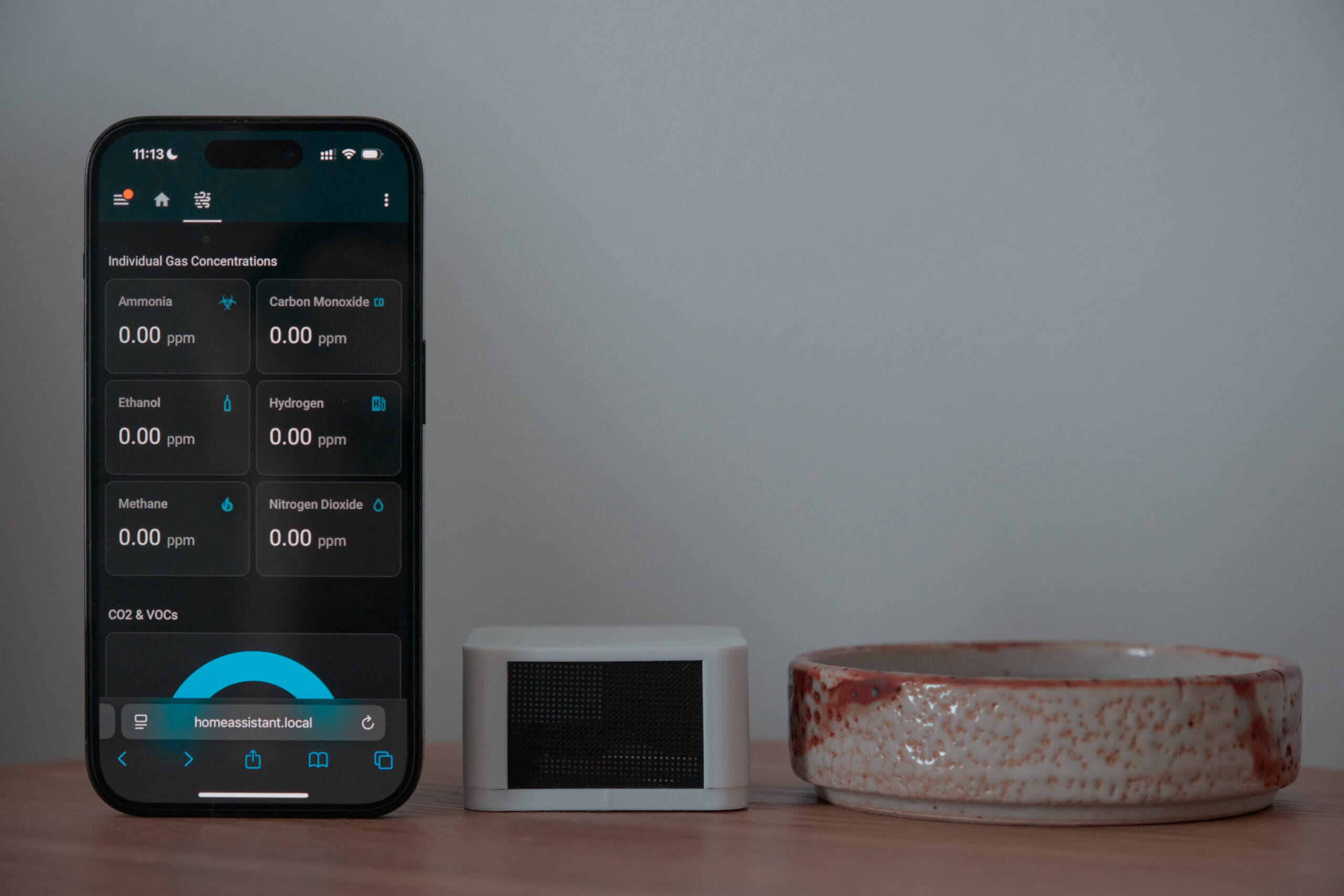

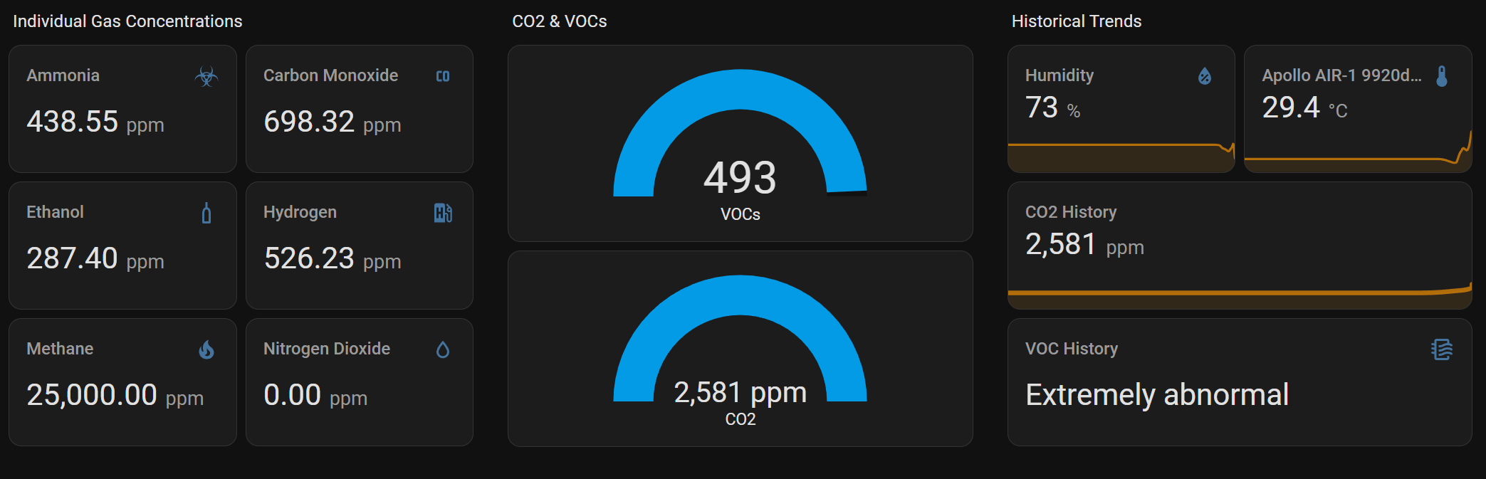

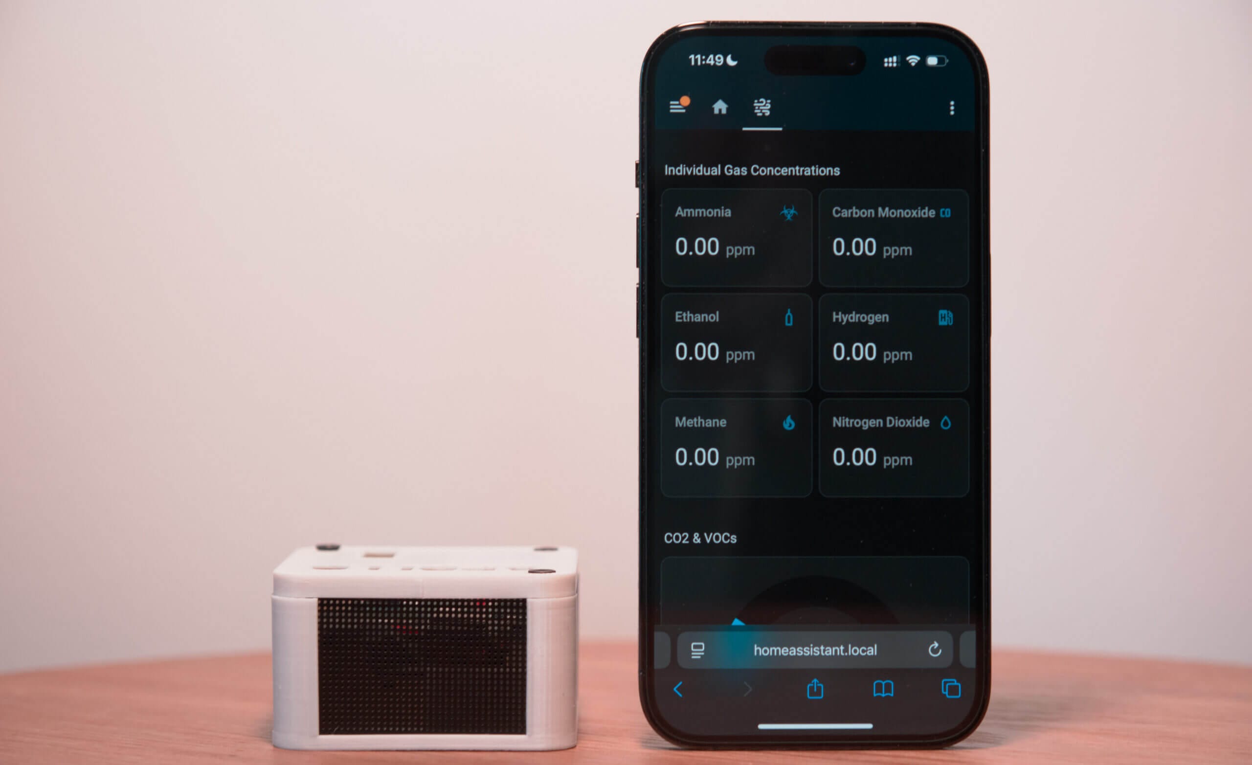

When it comes to the third main sensor on the Apollo AIR-1, the MiCS-4514 gas sensor, things are a lot less positive, and I don’t think you are missing out on much by getting the SEN55 and SCD40 combination instead. It’s worth noting that the VOC readings do not come from this sensor; rather, they come from the SEN55, so this sensor is just adding ammonia, carbon monoxide, ethanol, hydrogen, methane and nitrogen dioxide readings to the monitor. In theory, having these additional pollutants being monitored sounds great, but it comes with some very major caveats.
Firstly, and this is important to keep in mind, this monitor will not make a substitute for a dedicated and certified monitor in any of these categories. If you are worried about exposure to carbon monoxide (or any of the other mentioned gasses), purchase a certified monitor instead. What if you just want an indication about these gasses and don’t want to rely on the sensor? Surely it’s okay, then? Well, I’m still not sold.
I’ve found three key issues with the sensor. First, it’s not sensitive at all and very unresponsive. Second, it exhibits cross-sensitivity to gases (more on this soon). Finally, it shows random spikes that I know are impossible because I would be dead if the gas sensor had reported the correct value at that time. Anyway, let’s start with the first issue.
Apollo AIR-1 Ammonia
In everyday use of this monitor, and with the exceptions of the spikes mentioned above, I never once saw the gas concentrations recorded by this sensor rise above 0 ppm. One day, I cleaned the bathroom and kitchen with Mr Muscle cleaning spray (the primary ingredient being ammonia), and I never saw a rise in the measurement even though the smell of ammonia was strong. To test this further, I placed a bowl full of Mr Muscle next to the monitor, and I still saw no increase. The image above shows how I set this up.
I thought I would go a step further and place a paper towel doused in Mr Muscle right in front of the monitor. Nothing changed for a few minutes and I was becoming very disappointed. However, after about two minutes of having the towel right in front of the monitor, a change in the ammonia concentration was recorded. If you look at the image below, you will notice this uncovers another issue.
Apollo AIR-1 Gas Sensitivity
For some reason, while the ammonia concentrations increased as expected, the recorded methane concentration also went through the roof! Considering that 2000 ppm of methane is immediately dangerous to life and health, this was quite a concern! However, this concentration rapidly dropped (as did, surprisingly, the ammonia concentration even though I didn’t move anything), and it was clear this was either a random spike or the methane reading was cross-sensitive to some other gas that was present.
I wanted to test the sensor further, so I then proceeded to place the monitor in a container with a candle. This time, it responded rapidly (although the concentrations in the rather small container would have quickly reached extreme levels). This again highlights the cross-sensitivity issue, as by this point, there was no ammonia present, and I would not expect to see ethanol, methane and hydrogen increase, and not by this much. On the other hand, nitrogen dioxide never increased for some reason, even though this would have been one of the gasses I would have expected to increase concentration.
Apollo AIR-1 Gas Sensitivity (2)
I repeated this experiment a few times and left the monitor in the container with smoke for a few minutes. However, the results across each test were very similar. This has led me to conclude a few key things about the MiCS-4514 gas sensor. Namely:
  • It’s very unresponsive to low gas concentrations
  • It’s cross-sensitive, and other gases impact some gas readings
  • It exhibits random spikes (especially when it comes to methane)
For these reasons, and since I’m not the only one to have experienced them (see here and here, with some studies also sharing similar issues), I have concluded that this is not a very good sensor. I think most customers should save some money and stick with the quality Sensirion sensors. Perhaps this sensor could prove useful if the device was placed in a garage (as it seems intended for vehicle fumes), but even then, I have doubts.

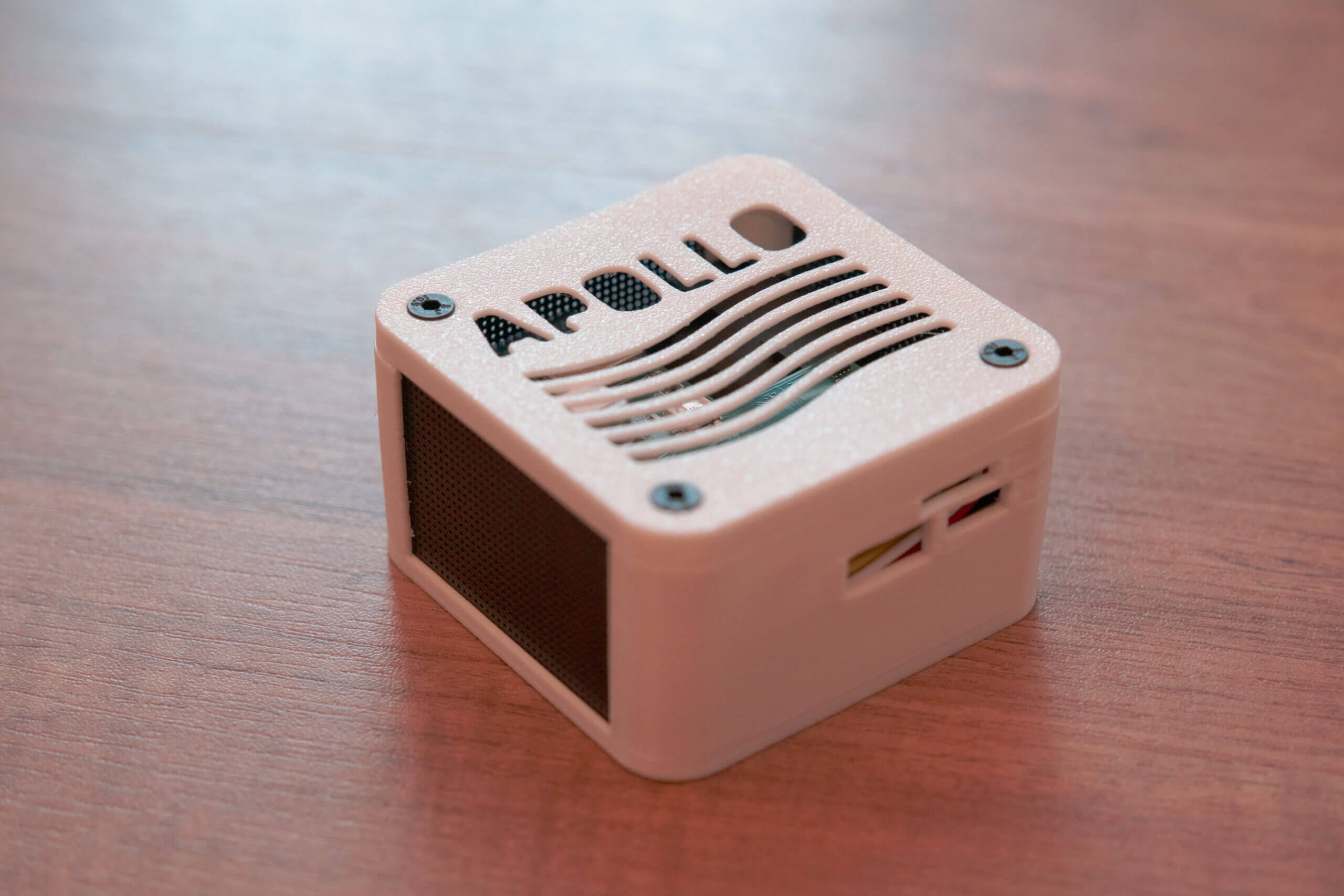

Apollo AIR-1 Top Face
The design of the Apollo AIR-1 can be broken down into two main categories – internal design and external design. Let’s start with the latter, as it’s most people’s first impression of the device. The first thought that most people have upon seeing this device is, ‘Wow, it’s small!’ because this really is a compact air quality monitor. While I don’t think it’s imperative because this isn’t a portable air quality monitor, it is amazing how small they’ve managed to make this device. Many people will appreciate how inconspicuous it is, largely because of its size.

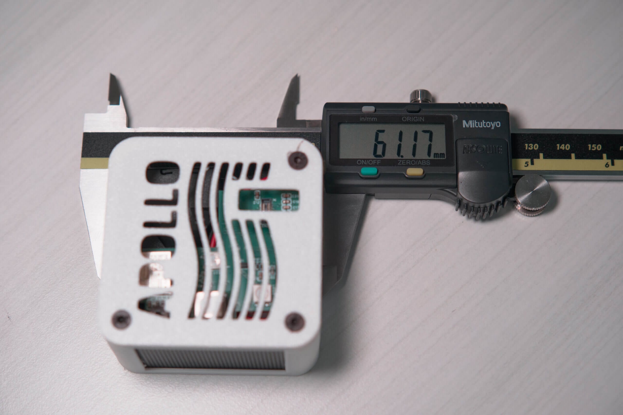

The device measures 61x61x30mm and is very lightweight due to its simple plastic design. It’s made even lighter because the top (or bottom, depending on how you orientate the device) is partially cut out to reveal a logo. Three of the device’s sides are mostly mesh to allow air to enter and prevent any hindrance to the airflow.
Apollo AIR-1 Size
The device’s build quality reminds me of the VisiblAir monitors, as the whole case is 3D-printed (likely with the exception of the mesh, but I can’t be sure). This means that while it’s decent, you might notice some minor defects around the outside of the case. I’m fine with 3D-printed cases, especially from smaller manufacturers, but I will note that my case came with a bent bottom plate. While this was likely due to being shipped halfway across the world, the case isn’t particularly resilient and you will want to be careful with it.

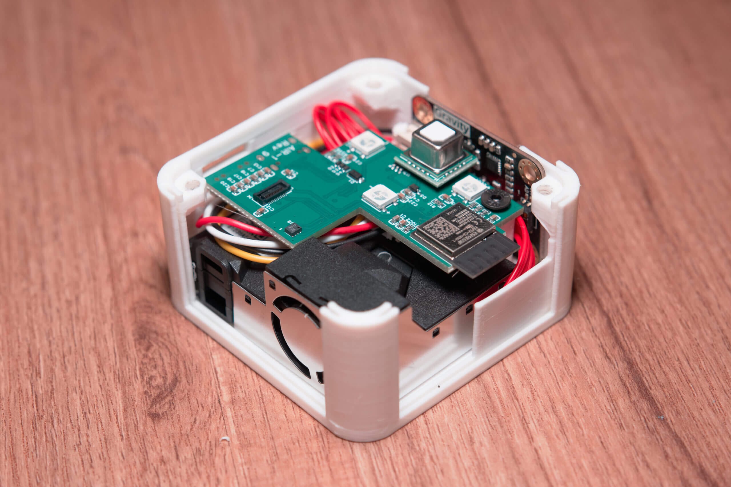

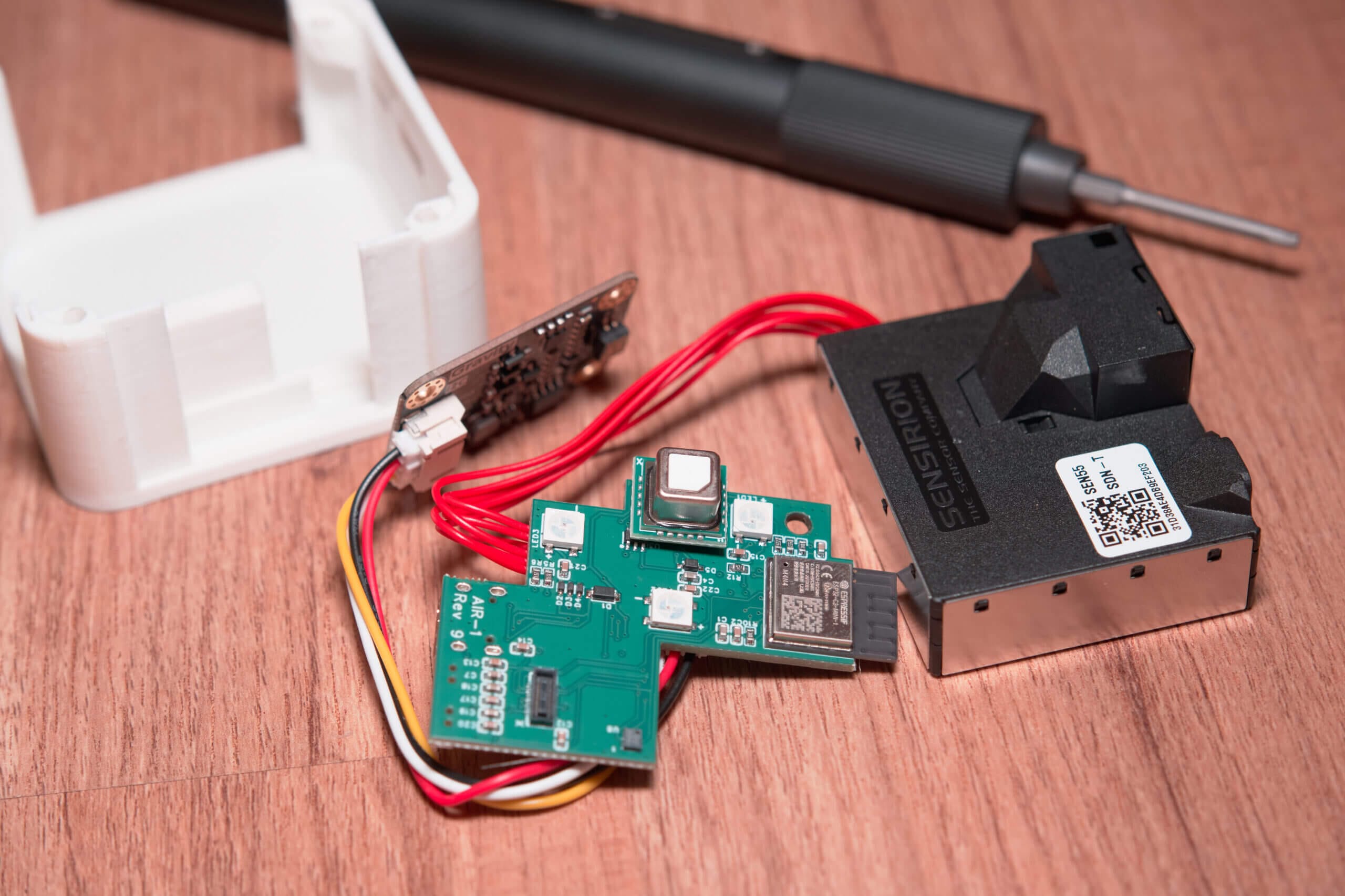

Now, when it comes to the internal design of the device, I had worries simply due to how compact the device is. While the PM sensor should be fine, as the fans are located right behind the mesh, I was worried about temperature, relative humidity, and carbon dioxide readings. The first two can be influenced by heat generated from the device (especially when it’s this small and compact!), and the latter because photoacoustic sensors can be impacted by vibrations created by the fan in the SEN55.
Luckily, I didn’t notice any issues with the CO2 measurements, and while there are definitely some issues with temperature and relative humidity (which I discuss in the accuracy section), these can be offset. Since the device uses the same case regardless of configuration, I would be curious to see if these issues are less with the SEN55-only configuration. Either way, it’s not a big deal, but it is amazing how much they managed to fit into this small package.
Apollo AIR-1 Components
So, let’s take a look inside! When you first screw the top (or bottom, I still can’t figure it out) of the device, you will find the main board of the device with the ESP32 chip – you also may or may not have the Sensirion SCD40 CO2 sensor attached. This sensor is extremely small, and it’s due to components like this that the device was able to be miniaturised so much. On the side of this board, you will find the Type-C port for charging the device and a GPIO slot.
Underneath this board is the SEN55 sensor, which is by far the largest component of this device due to its need for a fan. While the whole module is self-contained, you will find the PM, VOC, NOx temperature and relative humidity sensors within this module. One of the best aspects of this sensor is that it’s designed for longevity ( > 10 years) with a self-cleaning function. While it’s hard to tell how long these sensors will last in daily use, Sensirion has a lot of confidence in the longevity of this component.
Finally, fitting into a slot down the side of the monitor, you will find the MiCS-4514 gas sensor if you choose to include it. I’m not sure if removing this sensor would make the temperature and heat readings more accurate due to less internal heat generation, but it could be an added bonus for removing this sensor, which I don’t think is worth adding to your configuration. Either way, they fit a lot into this monitor, and it’s very impressive!

Since I have a range of devices that support Home Assistant, I created a few dashboards. For the sake of this comparison, I connected my Aranet4 Home, AirGradient ONE and Apollo AIR-1 all to Home Assistant and created a dashboard that plotted the data from each. As you can see above, I could easily create a dashboard that compares PM concentrations from both the AirGradient and Apollo devices, as well as a comparison table for CO2, including the Aranet4. While most people likely wouldn’t need a comparison table like me, I found the ability to do this extremely powerful for this review.
However, a dashboard like the one I created below is likely more useful to a typical user. This dashboard uses only entities from the AIR-1, and it has been very useful for me to design it in a way that I find logical and easy to follow—no other air quality platform allows anywhere near this level of customisation.
Apollo AIR-1 Dashboard Home Assistant
Please ignore the large section of missing data. I went away for a weekend, and while I was away, my Raspberry Pi crashed.
As I mentioned earlier, Home Assistant is far more powerful than this. You can create everything from advanced automation to custom calibration algorithms on the platform (which I have done, but not for my Apollo device). While these features are slightly more advanced – but still surprisingly easy to use – don’t be scared away by Home Assistant, as getting the basic functionality of the device is not difficult after you spend an hour learning the platform. If you have other air quality monitors (like any Aranet devices), you will likely find these can integrate into the platform, too!

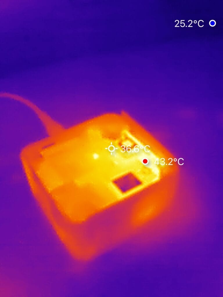

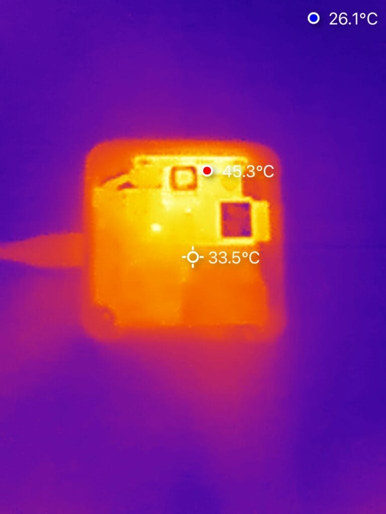

    Based on Ethan review I have 2 AIR-1 and an QP Lite. All have temperature and humidity completely wrong QP+ 3.2 degrees Celsius one of the AIR-1 -2.1 and the other one -2.9. Humidity also 10-15 lower. But my feeling is that co2 and pm 2.5 are completely wrong on AIR-1. This resulting of a useless product and I would suggest to stay away form this product. This is a shame because they seam to be very nice guys. I need to mention that one AIR-1 I place it outside and I calibrated manually (shows ~200 ppm less than QP Lite), the other one I did not calibrated (shows ~260 more). When it comes tom PM2.5 AIR-1 shows 21.5 and PQ Lite 16 (I tend to believe that this is the right value).
    QP Lite I never had to calibrate co2 sensor has a battery + display + a good app also integrates with home assistant so really no point of choosing AIR-1.
      Hi @telebog,
      Thanks for joining the forum!
      Out of curiosity, could you share some comparisons of the readings from the two devices simultaneously? The AIR-1 has good components (minus the gas sensor), so I would expect it to provide good readings. I would be happy to look into this further with you.
      1. telebog
        Because I am a new user I can only attach one photo. I will write the measurements.

        You can see that there is a big difference between the pm 2.5 between the two air-1 and also very different from QP lite. Also there is a difference between the 2 Air-1 in ppm inside. The temperature and humidity are totally wrong. If I set the offsets in the Home assistant I can get good measurements inside at around 20 degrees and around 60 humidity, but once this goes very low the measurements will be wrong. So temperature and humidity are useless on this device. Pm 2.5 are not reliable either, and 1 out of 2 devices reports co2 lets say correctly.
          Sorry about the permissions error – I totally forgot about that. I appreciate you taking the time to write down all of the measurements.
          There is quite a significant PM difference between the sensors and this is quite interesting to me. While the AIR-1 monitors report relatively similar readings most of the time, they also have quite some deviation. This is within their stated specifications, but it’s surprising how much higher than the QP they read.
          While there are very few studies with the Grandway sensor used in the QP, I would actually be more inclined to believe the AIR-1 for PM as it uses the Sensirion sensor which is much better tested (and has more studies covering it). With that said, the Sensirion sensor, as with many low-cost PM sensors, tends to overreport, so the truth could be somewhere in between. Here are my own findings when I tested the device:
          https://breathesafeair.com/apollo-air-1-review/
          I’m unsure if Apollo is using any kind of correction, but if they are, it’s possible that the humidity is influencing the readings as humidity plays a large role in accuracy when it comes to low-cost PM sensors. I also found that the temperature and RH readings could be quite different from reality, so I agree with your findings on these two parameters.
          As for CO2, I still think there is somehow a calibration issue playing a role here. NDIR sensors are pretty good these days, and even across different devices I usually get very similar readings. For the same device, they should be very similar!
