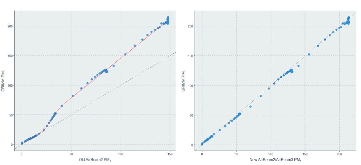

AirBeam PM Correction Algorithm
Left: AirBeam 2 PM1 vs Reference (before correction). Right: AirBeam 2 PM1 vs Reference (after correction).
Similarly, the team at Habitatmap, the company behind the AirBeam 3, used AQMD (South Coast Air Quality Management District) AQSPEC (Air Quality Sensor Performance Evaluation Center) data from the AirBeam 2 to create a correction algorithm to improve the accuracy of data from the AirBeam 3 (and newer AirBeam 2 devices). While this algorithm differs from that used on PurpleAir devices as it doesn’t account for relative humidity, it achieves a similar purpose of making the device more accurate in many circumstances. However, it’s important to note that different particle types can influence the accuracy of light-scattering sensors.
Unfortunately, I still can’t perform my own tests due to the same unstable WiFi connection that caused issues in my recent Qingping Air Quality Monitor Gen 2 review. While I don’t have access to reference equipment to fairly judge the accuracy of this device, I would have liked to compare the sensor to five other Plantower PMS5003/PMS6003 sensors to see how the correction algorithm impacts readings and assess precision. While I can’t complete this in time for this review, I will post the results on the BreatheSafeAir forum once they’re complete in a few weeks when I have a better connection. If you’re interested, please head on over there to learn more!

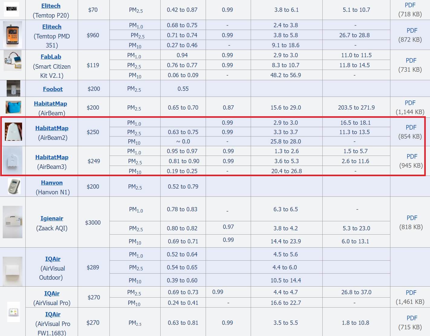

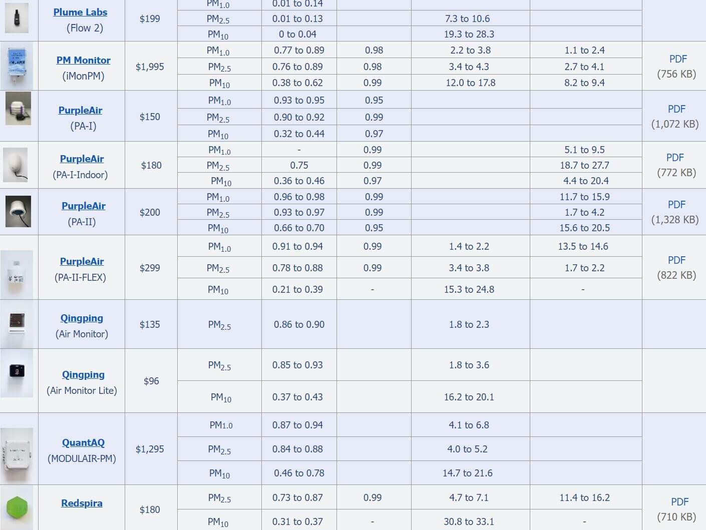

Luckily, we have far better data to look at in the form of AQMD’s testing. As part of the AQSPEC program, AQMD compared the AirBeam 2 and AirBeam 3 to reference-grade equipment – essentially, particle monitors that cost tens of thousands of dollars and are the most accurate we currently have access to. While I am reviewing AirBeam 3 in this article, I first want to look at the AirBeam 2 results, as these were how Habitatmap built the correction algorithm for the updated AirBeam 2 and AirBeam 3.
Left/first: AirBeam 2 results. Right/second: AirBeam 3 results.
As you can see, despite both devices using the same sensor, the AirBeam 2 (shown on the left or first on mobile) only showed moderate to strong correlations with reference grade equipment for PM1.0 and PM2.5. With the improvements brought by the correction algorithm, the AirBeam 3 achieved strong to very strong correlations for these two types of particles – a significant improvement, especially for field studies where particle types can differ greatly.
After looking through the AQMD database, these results make the AirBeam 3 one of the most accurate PM1.0 monitors tested (depending on whether we compare the lowest, average, or highest result, it is the most accurate) and among the most accurate PM2.5 monitors tested, too. This great result makes it the most accurate monitor I’ve so far reviewed on this website for a combination of PM1.0 and PM2.5.
AirBeam Accuracy
Now, the elephant in the room here is the PM10 correlations, which are very bad in both the case of AirBeam 2 and AirBeam 3. Before we go any further, it’s important to note that low-cost PM sensors come with severe limitations when it comes to measuring PM10 as they don’t directly measure the particle count – instead, they estimate it based on the particle counts of smaller particles, such as PM2.5. For this reason, low PM10 accuracy is typical across not just the AirBeam devices but most low-cost particle sensors. This is why I tend to stay away from PM10 readings and only use the far more accurate PM1.0 and PM2.5 concentrations.
With that said, even other devices that exhibit poor PM10 accuracy (relative to PM1.0 and PM2.5 accuracy) tend to perform better than this. Something happened with PurpleAir’s latest devices, but the previous PA-II shows an R-squared value of 0.66 to 0.70 (with 1 being a perfect correlation), which is much higher than the AirBeam 3. With that said, the more recent PurpleAir Flex dropped from 0.21 to 0.39, showing how PM10 is an entirely different matter, and we shouldn’t be relying on low-cost sensors to measure this metric accurately.
PurpleAir Accuracy
In summary, the AirBeam 3 performs very well for PM1.0 and PM2.5, being among the most accurate monitors in AQMD’s database for both metrics. However, it does drop off considerably for PM10, and the PM10 readings from this device should probably not be used at all. If you decide to pay attention to them, consider the inherent flaws with trusting low-cost air quality monitor PM10 measurements.

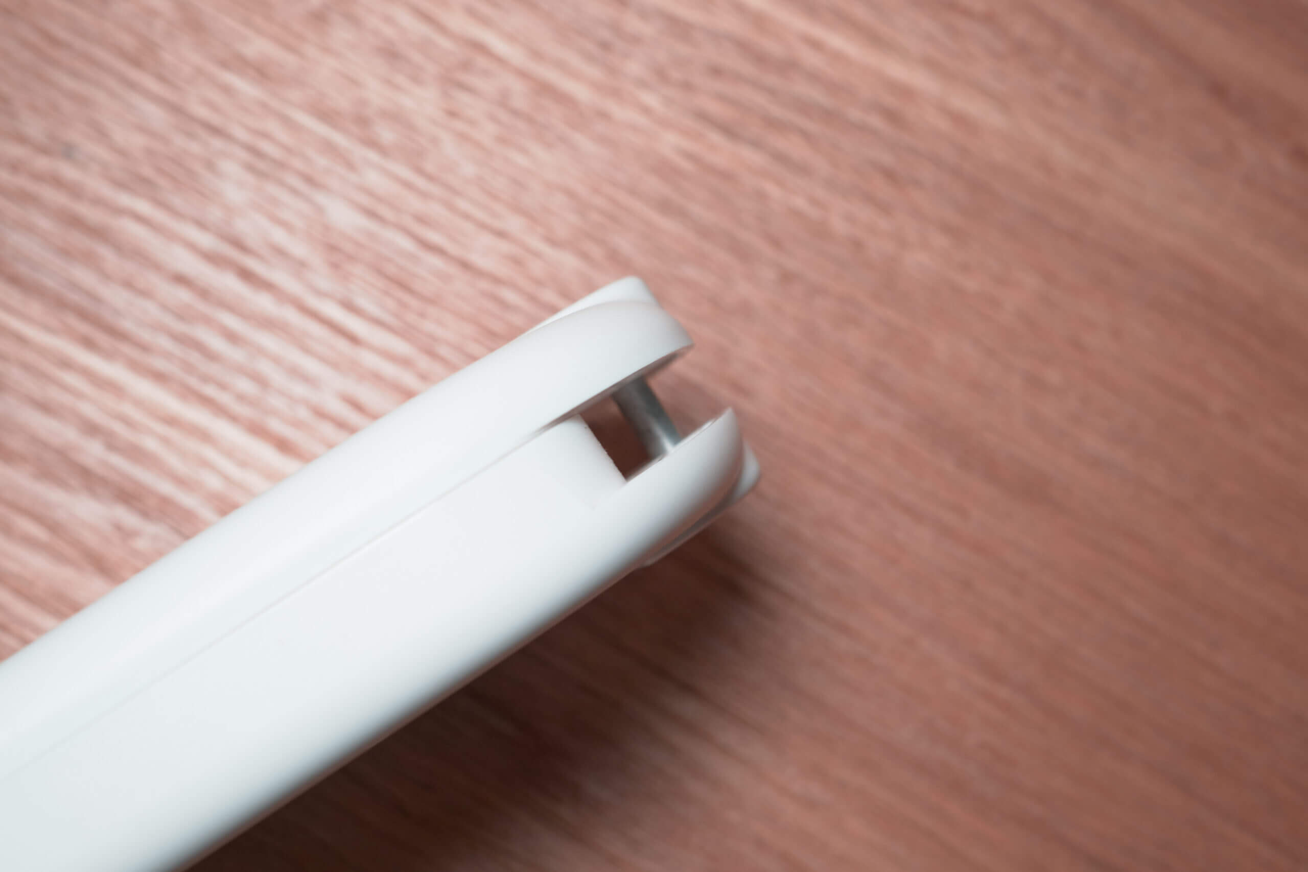

AirBeam 3 AQ Monitor Carabiner Hook

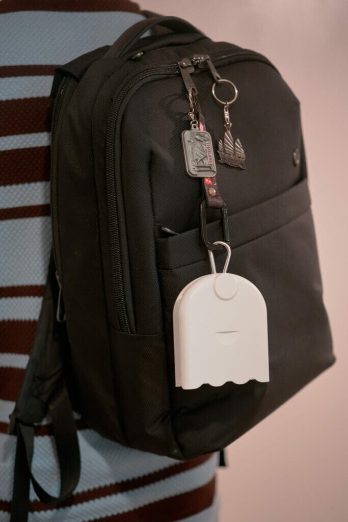

Since I’ve already alluded to them, let’s first discuss the mounting options of the AirBeam 3. This monitor can be used either as a portable air quality monitor or as a fixed air quality monitor outdoors. While you could, in theory, use this device indoors, too, there are much cheaper indoor air quality monitors that offer great performance, meaning this is best used either portably or outdoors.
The AirBeam 3 has a metal carabiner that can be attached to a mounting point on the top of the device for portable uses. I love how this carabiner can easily be attached or detached depending on how you plan to use the device, especially as these metal loops can be unwieldy when not in use. While you can use this carabiner to hang the device outdoors, there is also a screw thread and bracket included in the box that will better let you mount this device to an outside wall, fencepost, or otherwise if you want to use this monitor as a static outdoors monitor.

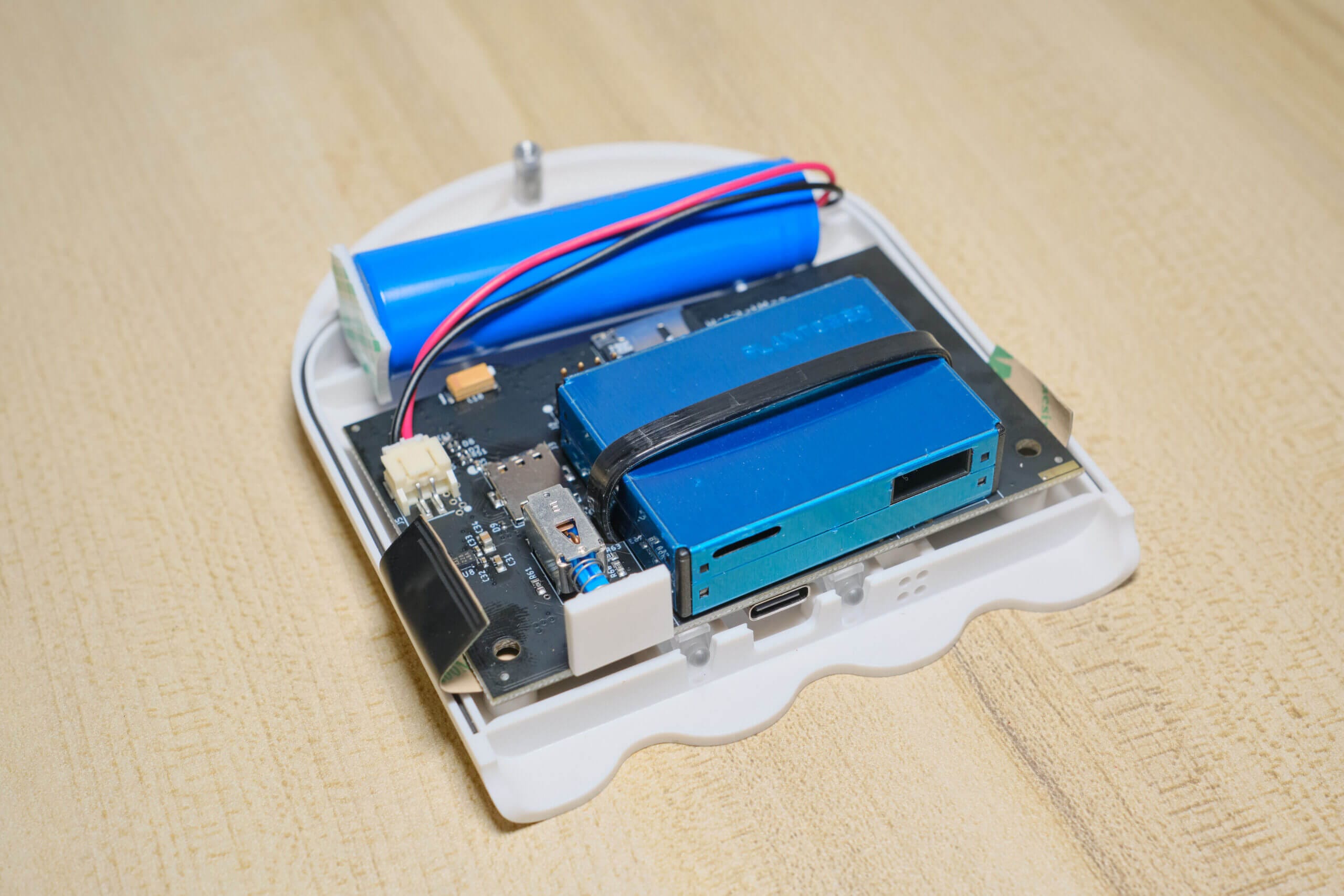

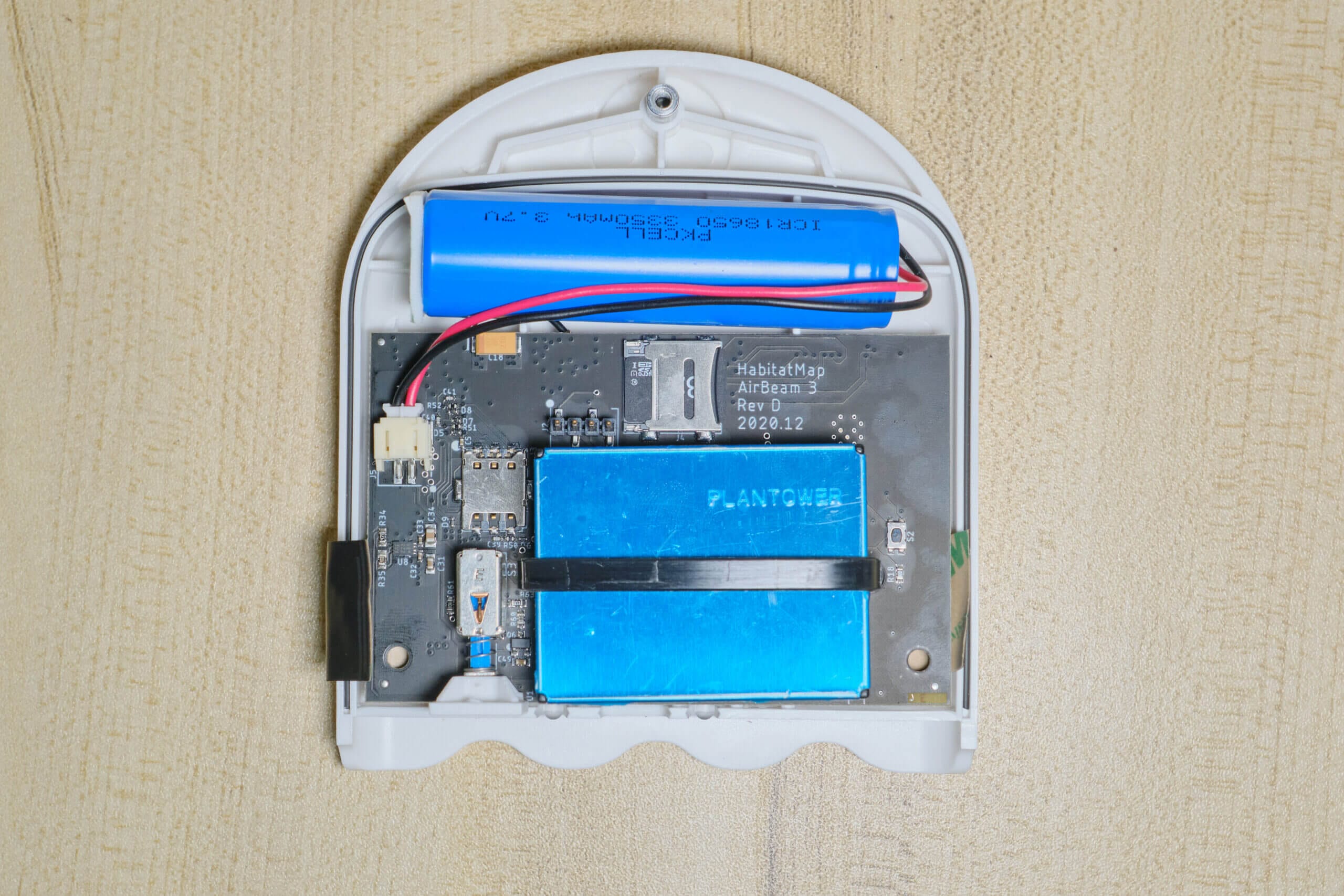

Unlike many air quality monitors, the AirBeam 3 is somewhat supposed to be opened. I say ‘somewhat’ because you need to open the device to add or replace the SIM and SD cards, but it’s also not designed to have replaceable components like the AirGradient Open Air.
As you can see, the Plantower PMS7003 sits directly above the vents (which you can make out if you squint at the image above). While you can’t see the temperature and relative humidity sensor in this image, it sits behind the third vent on the back of the mainboard.
On the back of the mainboard, you will find the cellular antenna and the chips that power the device. The most notable other feature is, of course, the massive battery that sits at the top of the mainboard. This battery is 3350 mAh, which means it’s the same size you can find in many smartphones today – impressive for an air-quality monitor! This battery will let the unit operate for 17 hours without charging, even with the monitor taking frequent readings.
While it doesn’t compete with something like the Atmotube Pro (which has a battery that lasts a week), the AirBeam also appears to take much more frequent readings, which allows it to provide more up-to-date readings, but at the cost of drawing more power. I don’t mind this at all, as a battery that can easily get through a day is enough for me on a portable monitor, but I would like to see the option to decrease the frequency of readings to conserve battery life.

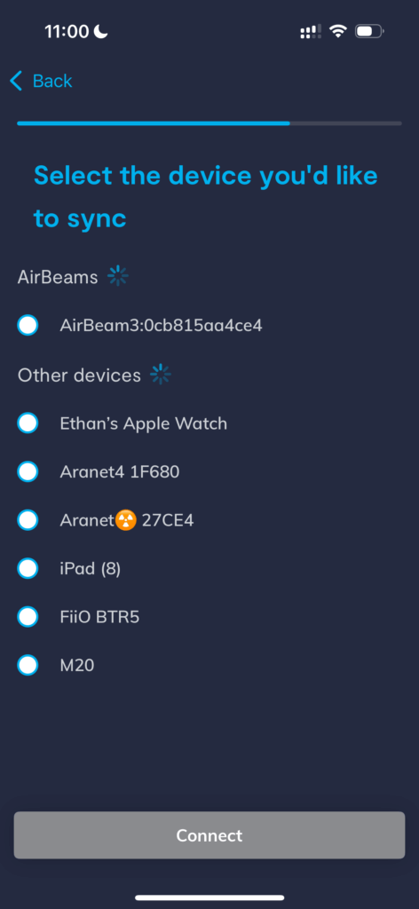

Regardless of which session you choose, you will next need to pair your AirBeam to your phone. While this sounds like it could be a painful process, the device becomes visible within a second after being powered on, and the complete pairing process takes only a few seconds. Once on, you will be able to name the session, tag it, and connect to WiFi (if doing a fixed session). Finally, you can start the session, and your device will begin recording.
