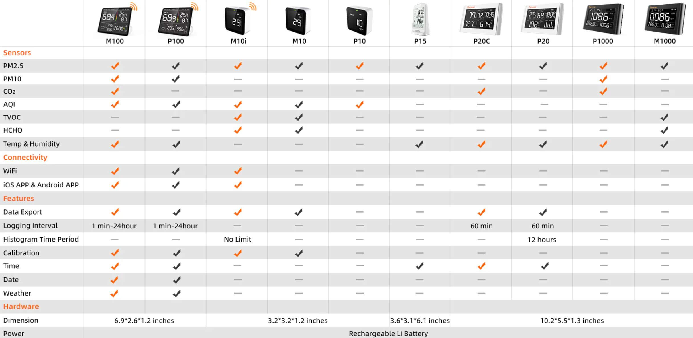

Temtop has quite a few monitors in its range. I wanted to call it the ‘M’ range, but there are also ‘P’ monitors. Hence, I think it’s best to call it the ’10’ range of monitors. From the most basic and affordable P10 monitor to the M10+, there appear to be four monitors that comprise the range. There is also a 100 range, but these monitors appear to use a larger screen with more detailed information as their selling point, making them quite different from the 10 range. So, what exactly differentiates the monitors in the 10 range?
The image above does a less-than-ideal job of explaining the differences, as I wish it also showed MSRP and either ascended or descended in lineup position instead of using seemingly random sorting. The P10 is the most basic and affordable monitor, and it only monitors PM2.5 (AQI is based on PM, so I don’t count this as an additional measurement). For the price, this may not be a big issue, but I am surprised by the omission of temperature and relative humidity sensors, which are used in almost every air quality monitor on the market. Furthermore, laser particle sensor accuracy varies based on relative humidity, and the lack of such a sensor means there is no compensation going on within this monitor.
Above this, the more expensive M10 adds a VOC and HCHO sensor to the PM2.5 sensor. Notably, it also adds the ability to export data and calibrate the sensor (presumable the VOC and HCHO sensors). I believe these two monitors are nearly identical in exterior design and size. While the PM2.5 sensor is from Temtop, the VOC sensor in this and the models we will discuss soon are from Sensirion, while the HCHO sensor is from Dart Sensors.
Left: Temtop M10+. Right: Temtop M10i
With the next model in the lineup, we see the introduction of connectivity. The M10i follows the same form factor as the two previous models and even has the same sensor arrangement as the M10, but it also adds WiFi connectivity and supports the iOS and Android apps. While the device is functionally the same as the M10 if you use it standalone, the advantage of viewing historical data and seeing data trends via an app is a big advantage for many users (including myself).
Confusingly, the M10+ is not included in the above image, but it appears to sit above the M10i. I say this because it adds a CO2 sensor (albeit in lieu of the HCHO sensor), an E-ink display, vastly better battery life, and a temperature and humidity sensor. Overall, it feels like the most complete package out of this series of monitors, and it also has some design improvements, such as the E-ink screen. While some users may be upset by the removal of the HCHO sensor, I personally would prefer a separate (and certified) sensor for such a dangerous gas.
While there are many other monitors from Temtop, this is the extent of the semi-portable indoor air quality range, as the other monitors are far larger or come in a handheld shape. Personally, I see a couple of ‘sweet spots’ within this range – namely, the M10 and M10+. The M10 is significantly more comprehensive than the P10, and I think it’s worth saving a bit more to jump to the M10 over the P10. While I also like the M10i, I think it’s much the same situation – I believe most people should jump to the M10+ as it’s a more well-rounded monitor due to its inclusion of a carbon dioxide sensor.

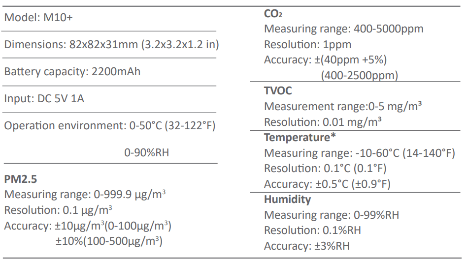

With that out of the way, let’s examine the monitor’s accuracy. Let’s start by examining the performance of the Temtop-made PM2.5 sensor. Some people may be surprised at the omission of a PM10 reading, but it makes sense when you consider that most low-cost sensors interpolate PM10 readings based on PM2.5 count, which leads to most PM10 readings on lower-cost air quality monitors being completely inaccurate.
Since information on the PM2.5 sensor is hard to find, I had to rely on the stated specifications (shown above) and some of my own testing. Now, it’s worth noting that my own testing is far from scientific, and it’s really just an overview of how the sensor might perform. With that said, I had some interesting findings.

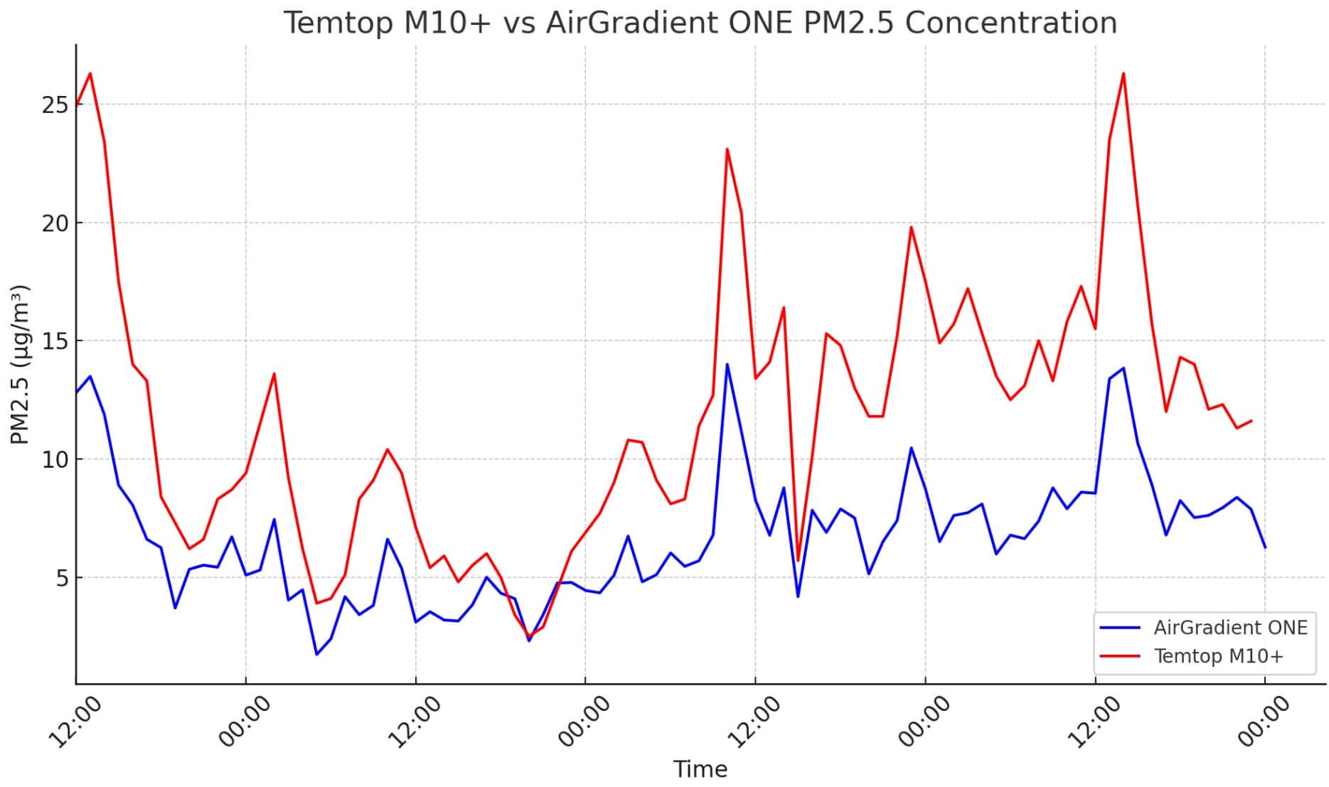

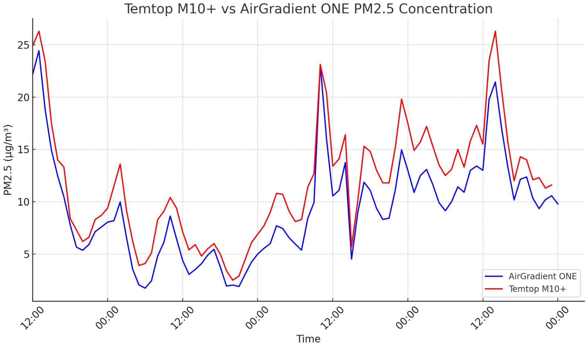

Above, I compared the PM2.5 readings from the AirGradient ONE and the Temtop M10+ over a couple of days. When I first set the monitors up, I expected the AirGradient monitor to report more particles than the Temtop monitor as the sensor it uses (the PMS5003) is known to significantly overreport particle counts when smoke is the primary source of pollution (as it was in my case). However, it was the complete opposite! This led me to worry a bit, because I know the AirGradient results to be already too high.
I decided to correct the AirGradient data using the EPA formula for PurpleAir monitors (which rely on the same sensor), and the results are shown below. As you can see, the Temtop monitor recorded similar trends but appears to overreport PM2.5. Again, this is far from scientific, but the EPA formula has been extensively studied, and when it comes to smoke particles, it should, in theory, improve accuracy on monitors with the PMS5003. To see the Temtop overreporting when being compared to the raw AirGradient data means it’s likely overreporting PM2.5 concentrations significantly.
Temtop vs AirGradient Corrected
While it’s hard to draw conclusions without access to reference equipment, which costs tens of thousands of dollars, I would bet that the Temtop M10+ (and likely other monitors in the Temtop range if they use the same sensor) overreport PM2.5 concentrations as do many monitors in this price range. With that said, it’s still a handy tool for picking up trends, and out-of-the-box, it will show readings similar to other popular monitors like those from PurpleAir – just keep in mind that the readings are likely a bit higher than the actual concentrations.

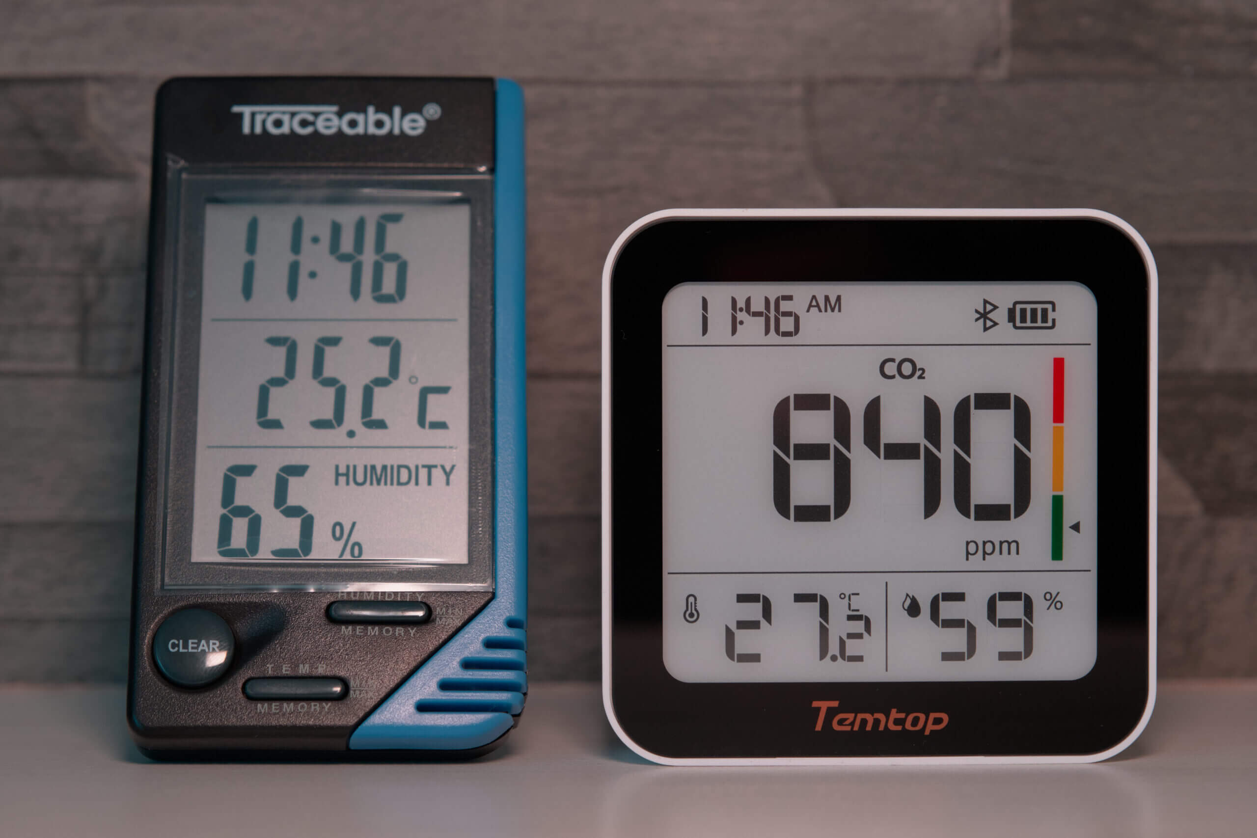

Unsurprisingly, the Temtop performs well when it comes to carbon dioxide. The SCD41 is a tried-and-tested sensor, and while it does have a few caveats compared to transmissive NDIR sensors such as the SenseAir Sunrise (found in the Aranet4 Home) and the SCD30, it’s still a good sensor. If you want to learn more, I’ve discussed some of these issues in this post.
However, I still wanted to compare the readings to an Aranet4 Home to ensure the monitor was accurate and performed well. While the graphs below aren’t particularly detailed (I can only export data from the Temtop monitor with a one-hour resolution, which is far from ideal), you can see that the readings from each monitor closely follow one another. While there are some differences in the readings, these appear to be systematic and are likely thrown off slightly due to an autocalibration from the SCD41.
Temtop CO2 Accuracy
That is a point worth mentioning – while the CO2 readings from this sensor can be very accurate, you will want to ensure the device is calibrated correctly. You can manually calibrate the sensor through the app, but autocalibration will occur every week. This isn’t an issue if the device is regularly exposed to ambient air or left in empty rooms. However, if the monitor is placed somewhere where the concentration never drops to around 400 ppm, this can lead to the readings quickly becoming inaccurate. Since the monitor is portable, this can be easily offset by leaving the monitor outdoors for an hour or so every week.
Another thing to note regarding the CO2 sensor: since the SCD41 does not have an altitude sensor built-in, the readings from this sensor will lose accuracy at higher altitudes. While this shouldn’t be problematic for most users, anyone living in an area significantly above sea level may encounter issues. Please refer to this post for a first-hand example of what I mean. Overall, this is a good sensor, and it performs well on the Temtop M10+.

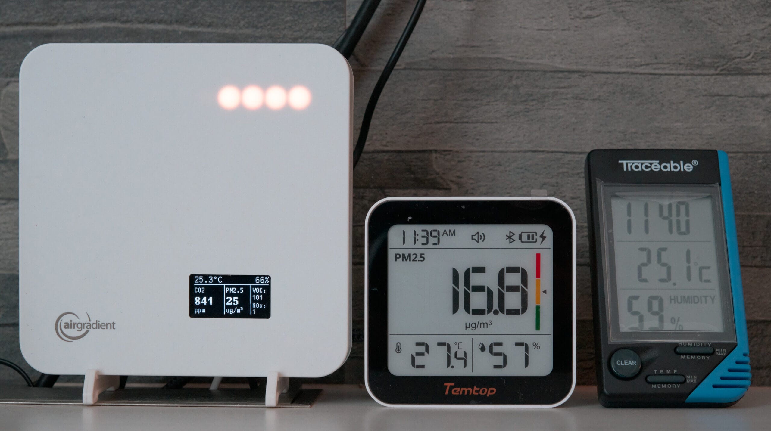

The Temtop M10+ has some quirks when it comes to the most basic sensors, temperature and relative humidity (which are measured by a combined sensor). Temtop admits in its manual that, when charging, the accuracy of the temperature may be off by around half a degree Celsius. However, I found the inaccuracy when charging far higher than this. I recently purchased a Traceable 4040 Hygrometer with very accurate temperature readings, which can be used as an imperfect baseline for temperature and RH (variance with this monitor is still ± 5% for RH). Let’s look at temperature first, which my Traceable lab certificate showed is within 0.1 degree accuracy at 25 degrees Celsius.
Temtop M10 Temperature and RH
As you can see, when charging at 25 degrees Celsius, the Temtop monitor records a very significant two degrees Celsius higher. This image isn’t unique, either, as I noticed the Temtop always read higher temperatures than both my Traceable monitor and my other air quality monitors when it was being charged. This surprised me as it looks like the temperature probe of the M10+ is attached to the outer vent, and the device is quite large, meaning I wouldn’t have expected it to be greatly impacted by the heat it emits.
As for relative humidity, it’s far more difficult to know for certain. Even pricey relative humidity monitors can have a large variance in readings (the Traceable monitor is ± 5%, as mentioned earlier). With that said, my lab test for the monitor showed results within ± 1% at 50% RH (this accuracy will decrease as RH increases), and I was surprised to see regular 5-10% differences in the readings between these two monitors – again when the Temtop monitor was charging. While I would trust the Traceable monitor more in this regard, and I have a gut feeling that the Temtop monitor is not very accurate on these two metrics when charging, these numbers are within the specifications of each monitor (± 5% for the Traceable and ± 3% for the Temtop – which in itself, seems optimistic compared to a dedicated monitor such as this, but I can’t say for sure).
On the battery, the temperature performance improved, and it almost always stayed within one degree Celsius of my Traceable monitor, more often than not within 0.5 degrees of the actual temperature. This was a massive improvement, and I find it surprising that simply charging could have such a big impact. Interestingly, RH accuracy also appears to be significantly better on battery. I’m not sure what causes this, but both readings are far more trustworthy on battery. It is also worth noting that both of these parameters can be offset in the app if you notice a systematic error.
Is this a big deal? Probably not. However, unless you don’t care about these readings, you should not just keep the monitor plugged in as you would with other monitors. This is a bit disappointing as I prefer to keep mind plugged in as it means I get more frequent PM readings than on battery. The most important thing is that you’re aware of this issue as it led to me questioning the monitor for a good while!

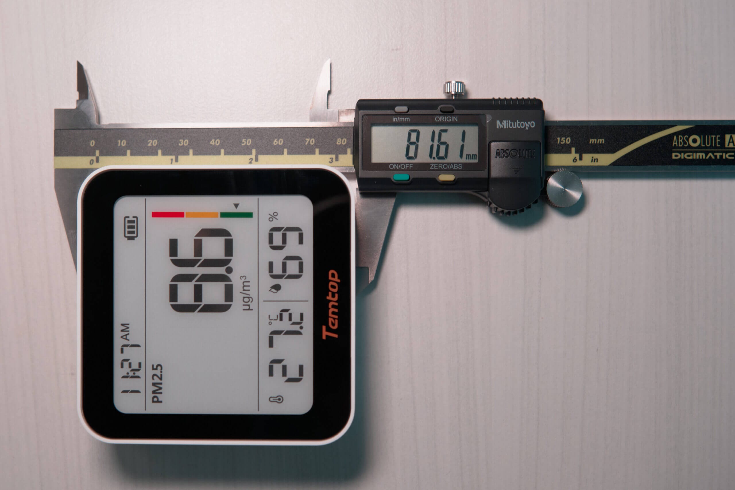

The monitor is around 81x81x31mm (I say around, as I had slightly higher readings for length and width as in the image below), meaning it’s quite small and easily holdable. It also only weighs around 170 grams, meaning it weighs basically the same as a standard iPhone model (non-plus, non-pro) and is lighter than any larger or more ‘premium’ smartphone.
Temtop M10 Dimensions
While I wouldn’t call the device pocketable, it is portable enough that you could easily fit it into a large handbag or backpack alongside your other daily essentials. As this device definitely isn’t intended to be used portably in the same way as an Aranet4 (which is to be kept in your pocket or handbag and be referred to frequently), I don’t mind this extra size, and I view it as a positive as it allows the screen to be larger.

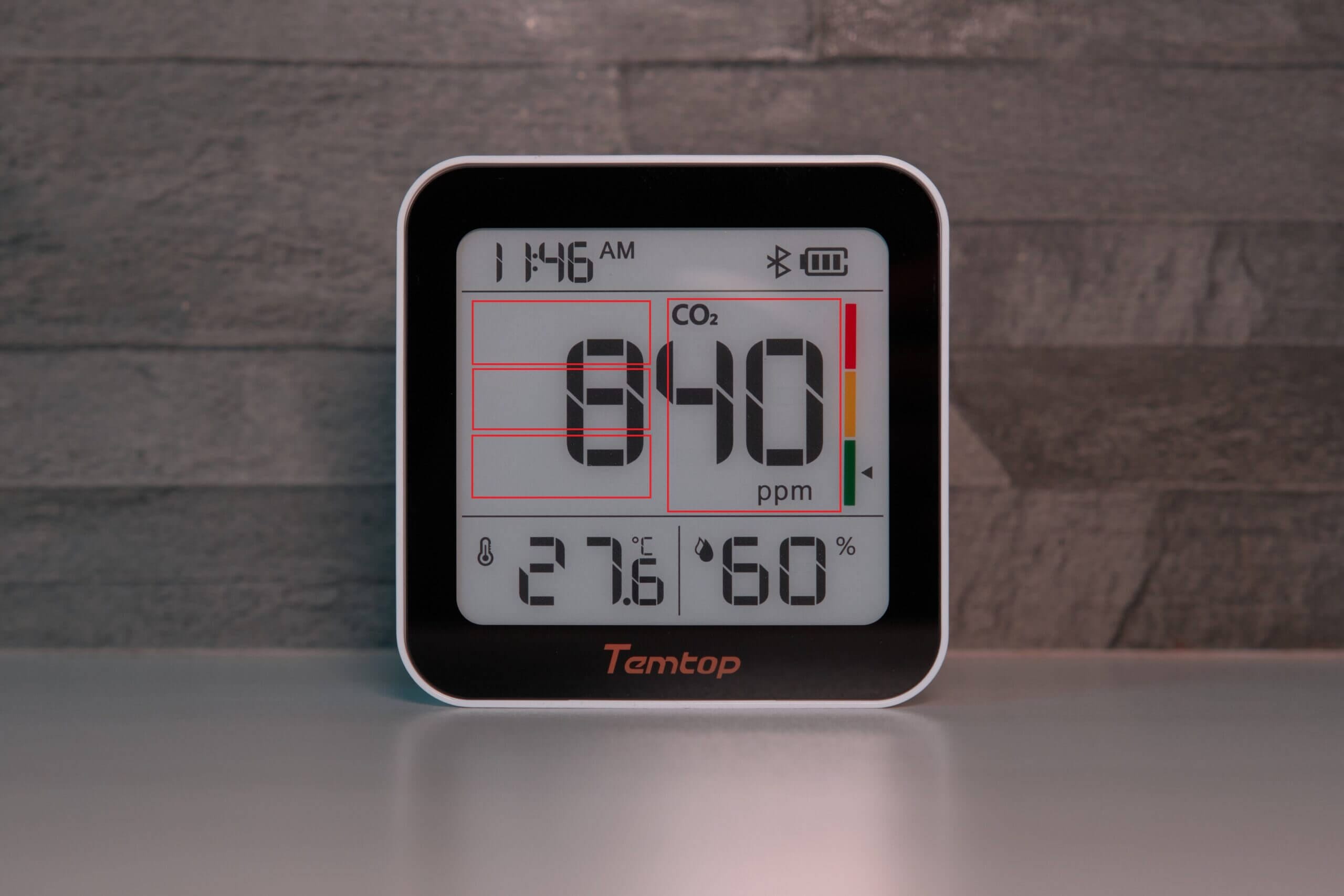

While I am a fan of the device’s build quality, I do have one key issue with the display. Don’t get me wrong – I like the inclusion of E-ink, and the screen technology is great. However, for some reason, Temtop chose to show only one key metric on the screen at any given time – despite such a large screen! You can always see the time, temperature, relative humidity and a few status symbols. Unfortunately, you must scroll through PM2.5, AQI, CO2 and VOCs by pressing the single button on top of the device.
Temtop M10 Screen Size
Please excuse my imperfect Paint skills; I don’t see why a UI like the one I’ve shown above couldn’t have been used. The large box could show overall AQI, while the three boxes on the left could show PM2.5, CO2 and VOCs. This could be done over a firmware update.
This bothers me because it means I can’t get all of the information I desire at a glance. It also seems like something that could have been easily overcome, as the device has a massive screen! While I can understand that perhaps they didn’t want to overwhelm the user with too many readings at once, there should at least be an option within the app to choose to show all pollutant information at any given time. I had a similar issue with the Airthings View Plus, but at least that monitor had a small screen and a (poor) excuse not to show more information at once. This monitor, though, could easily add more readings to its very large display.
I don’t think this is a deal breaker, but it does frustrate me. That said, the monitor will stay on whatever screen you set it to, meaning that if you care primarily about the carbon dioxide concentration, you can set the monitor to display CO2. It won’t time out and revert to the default PM2.5 screen. You can also set it to auto-scroll through the different displays in the app, but this still won’t give you all the information you want at a quick glance. These are silver linings, however, and mean that while I wouldn’t say I like the implementation, I can work around it.

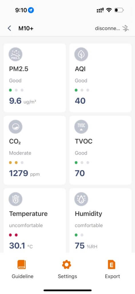

In the app, you can view all of the pollutant data, which is colour-coded to represent the quality of your air. While I wish the thresholds were adjustable (for example, some users consider 800ppm of CO2 in their home very high, whereas the Temtop monitor will only change at 1000ppm), I appreciate this colour-coding and the coloured dots to give a quick overview of the air quality.
When you tap on a pollutant, you can view historical data in a graph. While the app’s graphing functionality is quite simple, the ability to export data to a spreadsheet is also present, and, from my experience, it is a straightforward process. I consider the ability to export data almost essential for most monitors, and I love how it’s implemented into this app so well. Since the graphing within the app is quite simple, you will likely find yourself wanting to export data for any more in-depth analysis.

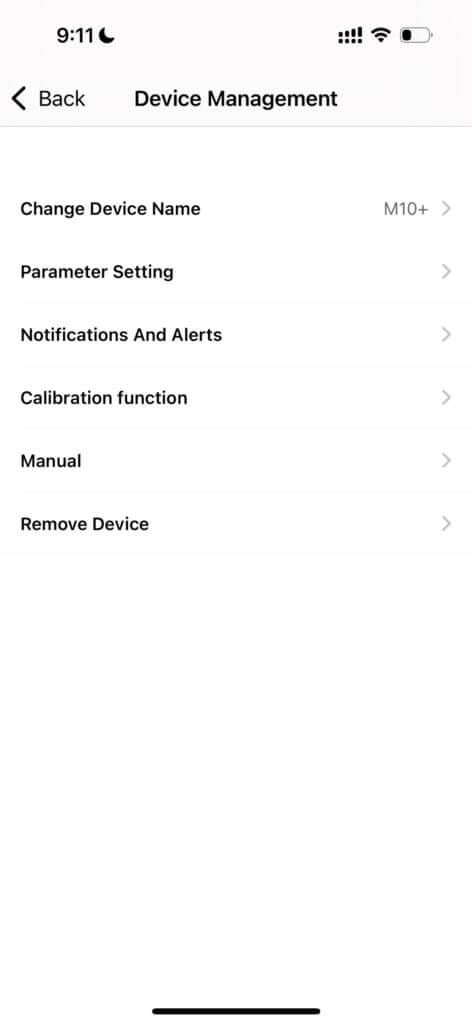

Surprisingly, the settings menu is my favourite aspect of this app. Despite Temtop clearly going for a minimal and what I would call ‘approachable’ design throughout the monitor and app, there are some quite powerful settings here. At the most basic level, you can change what the monitor display shows (and set it to auto-loop readings), change the temperature unit and time system, and toggle between the 2012 and 2024 EPA guidelines for AQI (2024 being stricter).
At a more advanced level, you can also calibrate the CO2 sensor and set offsets for the PM, temperature, and relative humidity values. Since I found this monitor to read incorrect temperatures, but in a systematic way, I appreciate this offset functionality and think it is a fantastic inclusion. Many monitors overlook this, and I am glad to see it included here – more so since this monitor seems to read incorrect temperature readings out of the box.
You can also enable or disable audible alarms on the device, but frankly, I found these to be very annoying. You can’t adjust when the alarms go off, and you also can’t adjust if it’s a one-time beep when the threshold is reached or if it will keep beeping until the concentration decreases below the threshold. By default, it’s the latter, and this can’t be changed. One night, I went to sleep, and the CO2 level rose, so the alarm kept repeating itself until I got fed up enough that it’s now permanently disabled on my monitor.

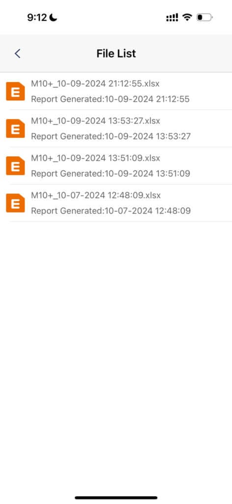

Can the Temtop M10+ export data for further analysis?
Yes, the M10+ allows users to export data to a spreadsheet, making it easy for further analysis. The app also supports viewing historical data and trends, though its graphing functionality is simple.
