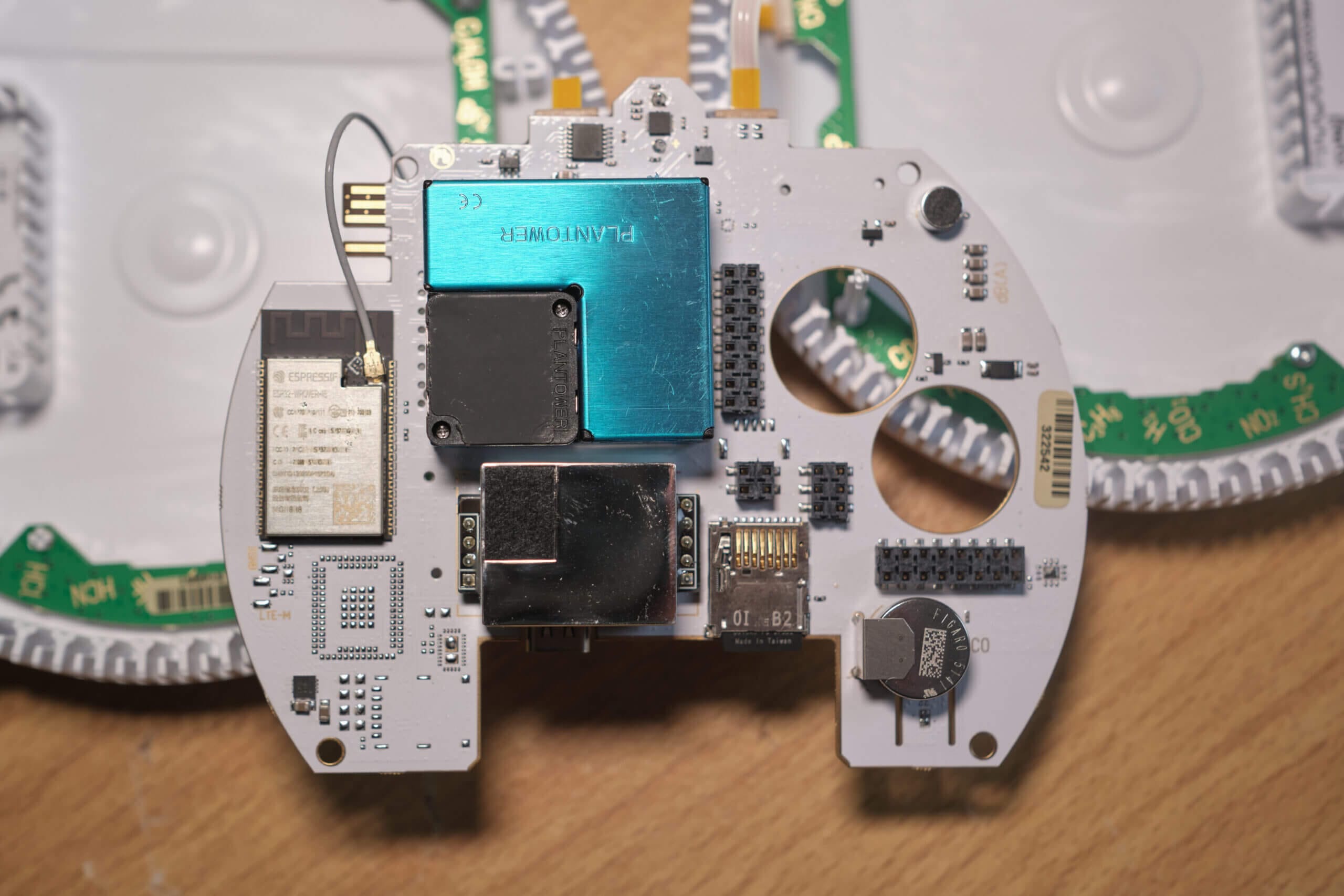

It’s worth noting that I have the Air-Q Basic, so I can see what components are used in this device and, presumably, in the Air-Q Light. However, I am still unsure exactly which sensors the Air-Q Pro adds in addition to the Basic’s selection, and I can’t comment on their performance or accuracy for this reason. That said, it likely uses the same sensors for PM, CO2, VOCs, and CO found in the Basic and, in the case of CO2 and VOCs, in the Light. Here are the sensors my teardown revealed:
  • PM Sensor: Plantower (I am unsure which model, as there was no visible label). Considering its size and look, I think it’s a PMSA003.
  • CO2 Sensor: Cubic CM1107. This is a dual-beam NDIR sensor.
  • VOC Sensor: Sensirion SGP40
  • CO Sensor: Figaro 5141
  • Temperature & RH: I haven’t found out conclusively, but it is labelled 121R.
At first, I wasn’t too sure about these sensors as I’ve had bad experiences with sensors like the Figaro 5141 before. However, after looking into this sensor and discussing it with Air-Q in more detail, I don’t believe this is a big issue with the Air-Q monitors. It’s also worth noting that these sensors are pretty common in the field, and you’ll see them used on many different monitors.
Plantower PM sensors are used in various monitors, from the PurpleAir Zen to the AirBeam 3. While there are some (arguably) better options in this sensor price range, the Plantower sensors have the advantage of being some of the most widely studied in the field, as they are included in very popular monitors such as those used by PurpleAir.
Cubic is another generally reputable brand, and I’ve encountered these sensors before in devices like the Airthings View Plus. Interestingly, this is a dual-beam NDIR sensor, meaning it should retain its accuracy even better than single-beam NDIR sensors such as those used in high-end CO2 monitors like the Aranet4 Home.

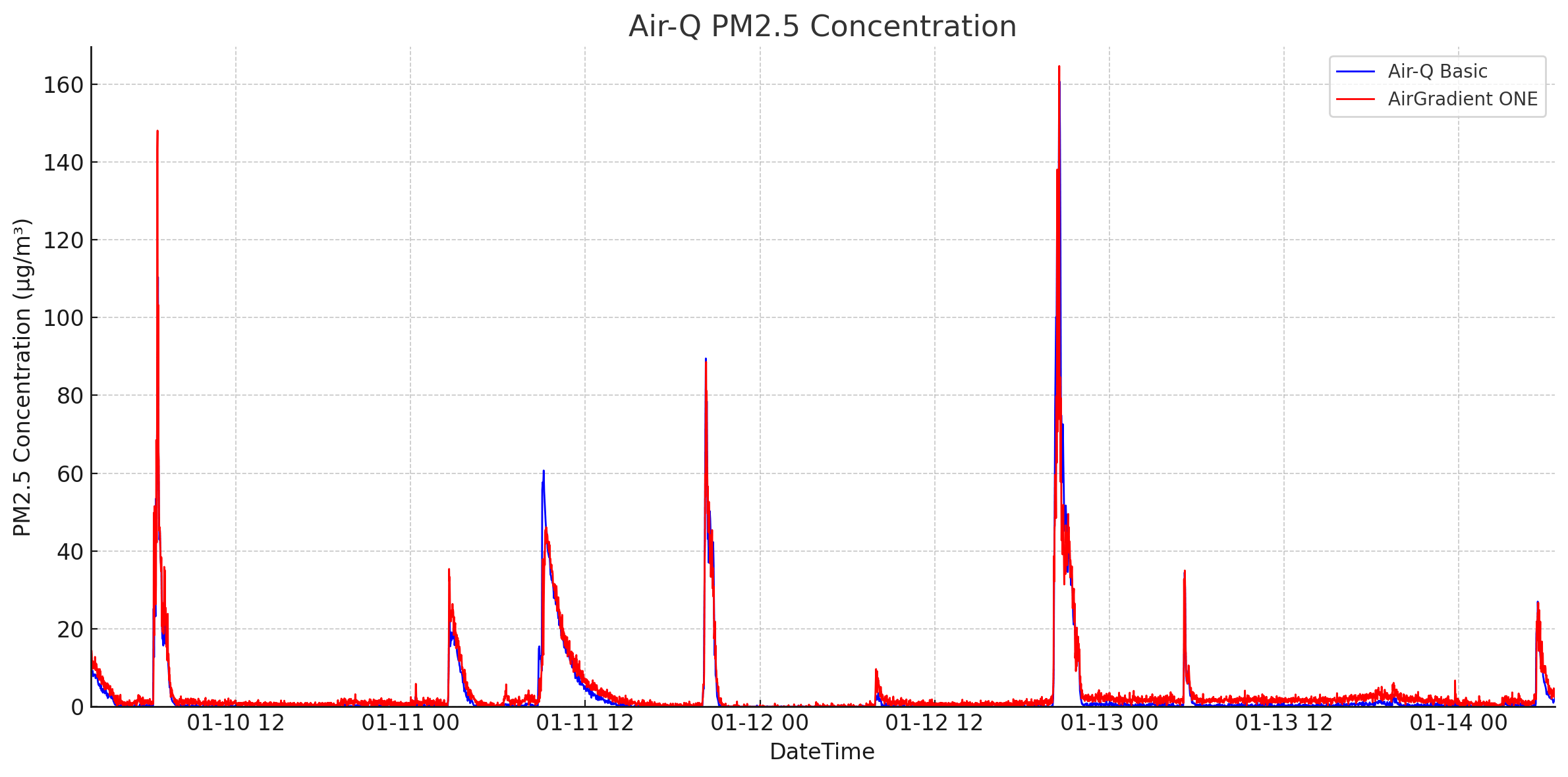

My first test, shown above, was to compare readings from the Air-Q Basic and an AirGradient ONE (with a Plantower PMS5003) over a few days in my kitchen. The large spikes were during cooking, and the objective of this comparison was to see if the PMSA003 performs similarly to the PMS5003. As expected, they provide very similar readings with an R-squared value of 0.85. I wanted to perform this test as the PMS5003 is a very well-studied sensor, and knowing that PMSA003 performs similarly allows me to know the same characteristics from the PMS5003 that likely apply to this sensor, too.
Numerous studies have found that the PMS5003 is generally a good low-cost sensor. However, it tends to significantly overstate PM2.5 concentrations at higher values while typically understating them at lower values. For this reason, algorithms such as the EPA correction (used by PurpleAir) are often used to improve accuracy. Speaking of PurpleAir, I also wanted to compare their Zen monitor to see if they picked up the same trends.
Air Q vs PurpleAir vs AirGradient
As you can see, all three monitors provided similar results, with the Air-Q monitor generally reading a bit low. However, as all four (the PurpleAir monitor has two sensors inside) sensors are fundamentally the same, we can see there is generally good precision. The takeaway here is that the Air-Q provides similar readings to other trusted consumer-grade monitors like the PurpleAir Zen, which correlates well with reference instruments in most studies but likely understates PM2.5 concentrations at higher values. Overall, I would trust the readings from this monitor as much as my PurpleAir Zen or AirGradient ONE.

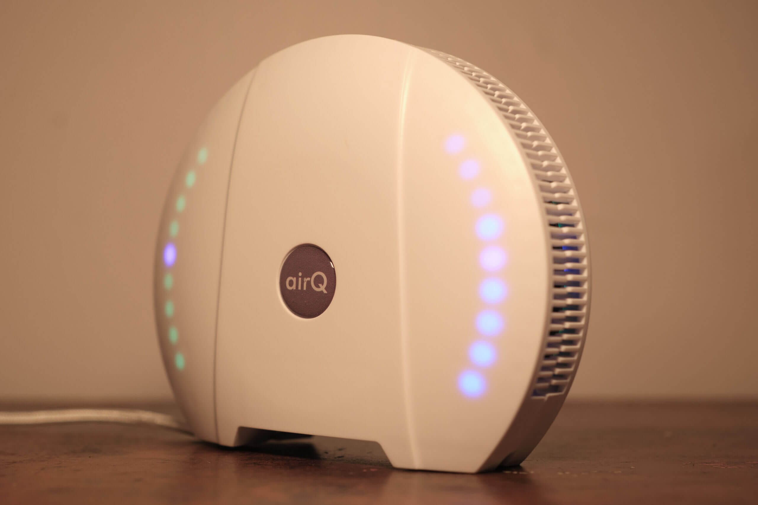

The Air-Q series of monitors has a unique design that manages to convey a surprising amount of information, considering the lack of a display. This information, as you likely can already tell from the images, is conveyed through two LED bars which run up either side of the device. I think this design is very cool, and I appreciate how the LED bars are fully customisable and can be set to show any two metrics of the user’s choice via the app.
These LEDs are visible on both sides of the device (back and front), meaning the device can be orientated in whichever way you prefer. On top of this, there are slots on the bottom (where the USB cable connects) to run the wire, meaning that this device truly can be orientated either way without any disadvantages. While this is a small touch, I appreciate this as there are some locations in my house where the device only looks good in one orientation or the other – usually as I want to try and hide the USB cable.

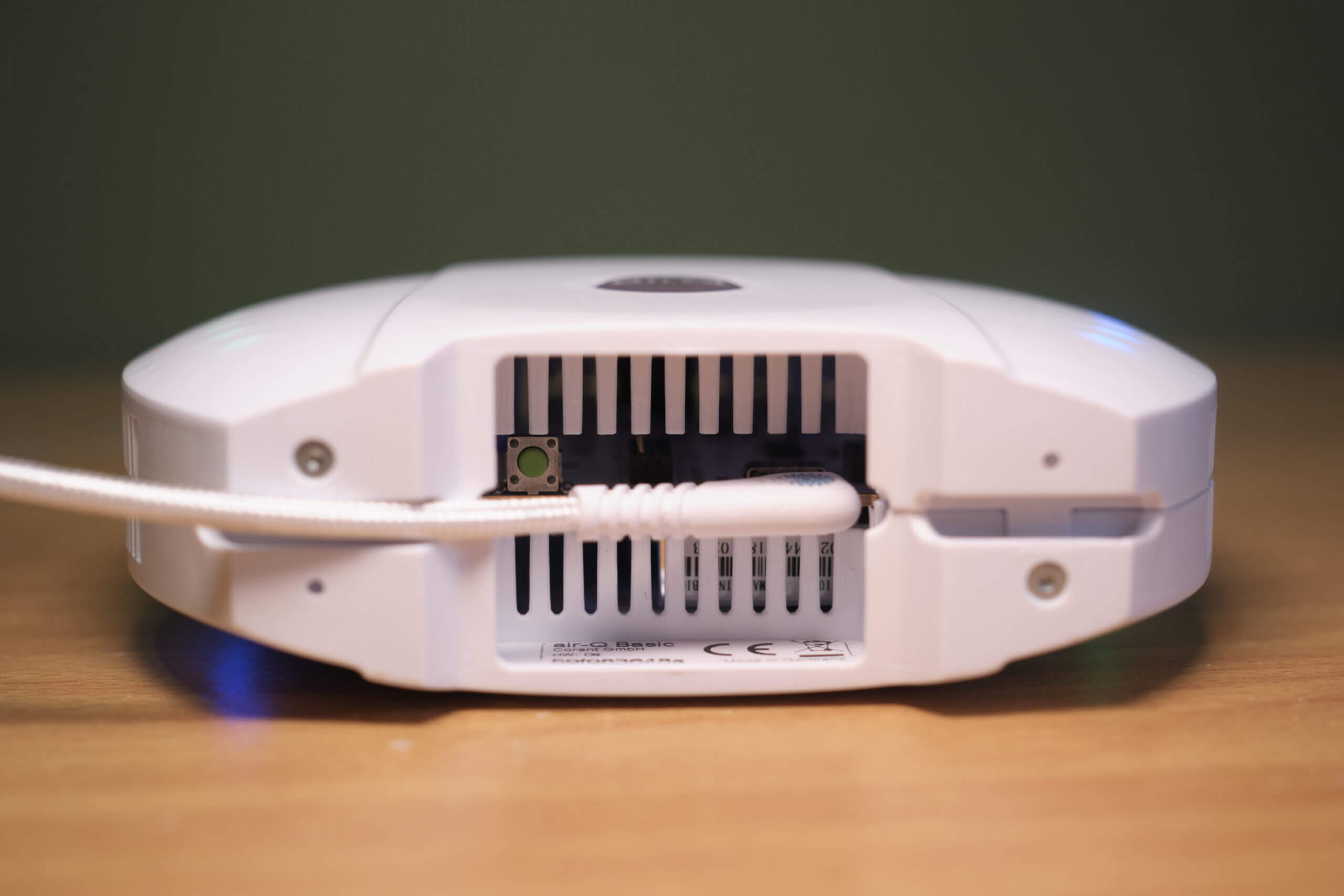

Speaking of the USB cable, a Type-C to Type-A braided cable is included. This cable is a good length, and this is important because you will want to use this cable. Why? Well, the bottom of the device is quite low to the ground, and the included cable has a 90-degree head, meaning the device can sit flush with whatever surface it is on. Without a 90-degree cable, you will not be able to place this monitor flat on a surface.
Air Q Basic Bottom 1
Interestingly, this device doesn’t have any other mounting options (such as a bracket to mount it on a wall), but this is far from a big deal; many other monitors are the same in this respect. Also interesting is that this monitor is super easy to disassemble (and you can see images of the internal components in the ‘Accuracy’ section above). This is likely due to the device needing to be custom assembled due to customer configurations, but it also means that the user can easily open the device if needed. That said, the device doesn’t exactly feature replaceable components (at least not easily) as everything is soldered down, and some sensors are embedded on the mainboard.
Air Q Basic Bottom
Also on the bottom of the device is a reset button, which can be used to reset the device in case of any issues, and a micro-SD card slot. My monitor came with a 32GB card included, and this will store a massive amount of data from this device. Since data can’t be exported from the web dashboard without a subscription (more on that in the next section), this micro-SD card is the only way to get data off the device for further analysis.
Around both sides of the device are large vents that run along the entire semi-circle that is the top of the device. This venting allows fresh air to both enter and exit the device, allowing it to measure the ambient air quality. While it’s hard to test for sure, I believe that this extensive venting allows for the best airflow and, therefore, more accurate readings from the sensors within.

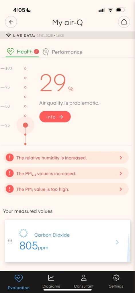

Before I get ahead of myself, let’s dive into what makes the app so special. From the home screen (evaluation), you will get two summaries – one for health and one for performance. The health index is probably what most people will use, and this shows a score from 0-100, which indicates the health impact of your current air quality. On the other hand, performance shows how much your air quality impacts your cognitive ability and is also a helpful stat – especially for people like me who work from home often.
Remember how I mentioned this app is fantastic for power users? Well, I was wondering exactly how these scores are calculated. At any given time, you can see the exact factors taken into account and the weight of each by simply tapping on the score. I love this kind of transparency! You can also see a graph of the score over the past three, six, 12, and 24 hours, and you can even export this (as an image) or set alarms based on scores.
You can also delve into the specific pollutant concentrations underneath the overall scores. Tapping on any of these will present you with a similar screen that has a graph, some export and graphing settings, and, helpfully, full descriptions of the limits, consequences, origin and even sensor hardware for that specific pollutant. This might be more information than is needed for most people (especially the sensor hardware screen), but again, I love this information.

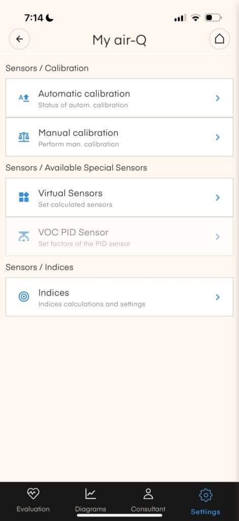

Other than this, there is also an extensive settings menu – when I say extensive, I mean it! The menu is divided into categories such as Basic Settings, Sensors, Cloud Settings, Dashboard Settings, and more. Furthermore, many of these menus have more than 10 suboptions, allowing you to truly customise the device. While I can’t delve into every setting here, I will discuss a few key points.
Under Basic Settings, you can change the device’s LED behaviour, and you can change the LEDs on the left and right-hand side of the device to show any measurements taken by the device. Yes, any measurement! Under Cloud Settings, you can set up the device to also send data to the Air-Q Cloud for safekeeping and easy access. You can also edit network settings, and, handily, the device can even have multiple saved WiFi networks, and it will choose the network with the strongest signal at any given time.
Night Mode settings allow you to change how the device operates at night (which is adjustable) and even disable WiFi for this period if you would like. Again, very cool! If you find the PM sensor fan sound annoying, you can also disable it at night. Acoustic alarms, push notifications, email notifications, and smart (AI) alarms can all be set and adjusted under the Notifications menu.
My favourite menu, the Sensors menu, allows you to see the automatic calibration status of different sensors (in the case of the Basic, this applies only to the CO and noise sensors) and even allows you to disable automatic calibration entirely. You can also manually calibrate some of the device’s sensors in this menu, allowing you to add custom offsets. Interestingly, the CO2 sensor is not included in either of these sub-menus, and this seems like a bit of an oversight considering how in-depth the rest of the app is.
Other than these settings, there are also menus for functions such as updating the device, removing the monitor from your dashboard, and more. However, these are the menus you will likely never use or at least not frequently open. Overall, I’ve been very impressed with the functionality of this app, and I love how much control I have over the device. While it could admittedly use some polishing (I am using an iPhone 16 Pro Max), it’s a great app already.
