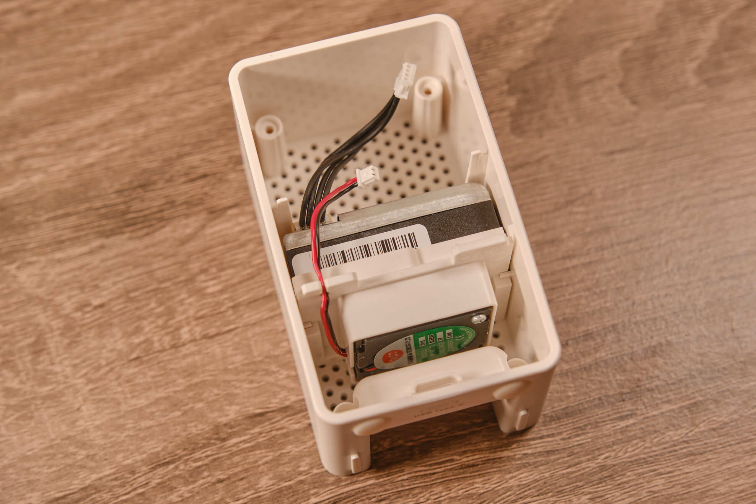

The Vindriktning uses a Cubic PM1006K particle sensor. These sensors are very low cost, which explains how IKEA can fit them within such a cheap product. Unlike more expensive particle sensors, this Cubic model uses an LED instead of a Laser to measure the particles passing by.
This sensor has a stated accuracy of ±20μg/m³ or ±20% of the reading (whichever is larger), which is quite a large deviation compared to more expensive sensors. Of course, we expect this in a cheaper device, but with a deviation of ±20μg/m³, we should expect to see a large variability in the readings compared to other devices.
Interestingly, IKEA has added a fan to the sensor. Since the CUBIC PM1006K doesn’t come with installed by default, the decision was made to add a fan to the module to constantly push air through the sensor. This should improve accuracy and it shows IKEA has put effort into trying to improve the accuracy of the device.
IKEA Vindriktning Sensor Fan

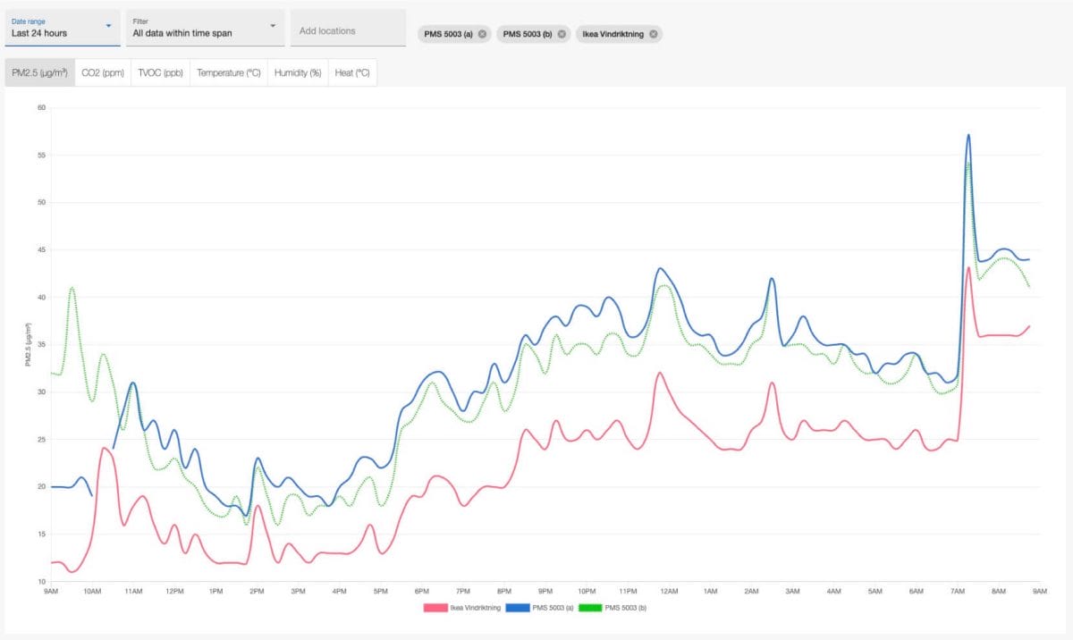

IKEA Vindriktning (red) compared to two other low-cost but accurate sensors. Graph from AirGradient.
As per AirGradient’s report, the Cubic sensor consistently underreports PM2.5 concentrations. This is the opposite of what I would have expected, and it’s particularly interesting because the graphs show that the Vindriktning can identify trends – it just massively underreports them.
Unfortunately, combined with the terrible air quality scale used on the IKEA monitor (which I will discuss in the design section), this makes the device useless. Not only does it underreport, but the levels used for the traffic light LED system are very badly thought out.
While this current iteration of the IKEA air quality monitor is not something I can recommend due to this poor accuracy, I can see the potential here. The sensor can clearly pick up trends and correlates very well with better sensors – it just underreports significantly. It seems that if a software update was made and the zero value changed, the sensor could instantly become far more accurate. Unfortunately, without the ability to receive updates, we will need to wait for a second version for this issue to be solved.

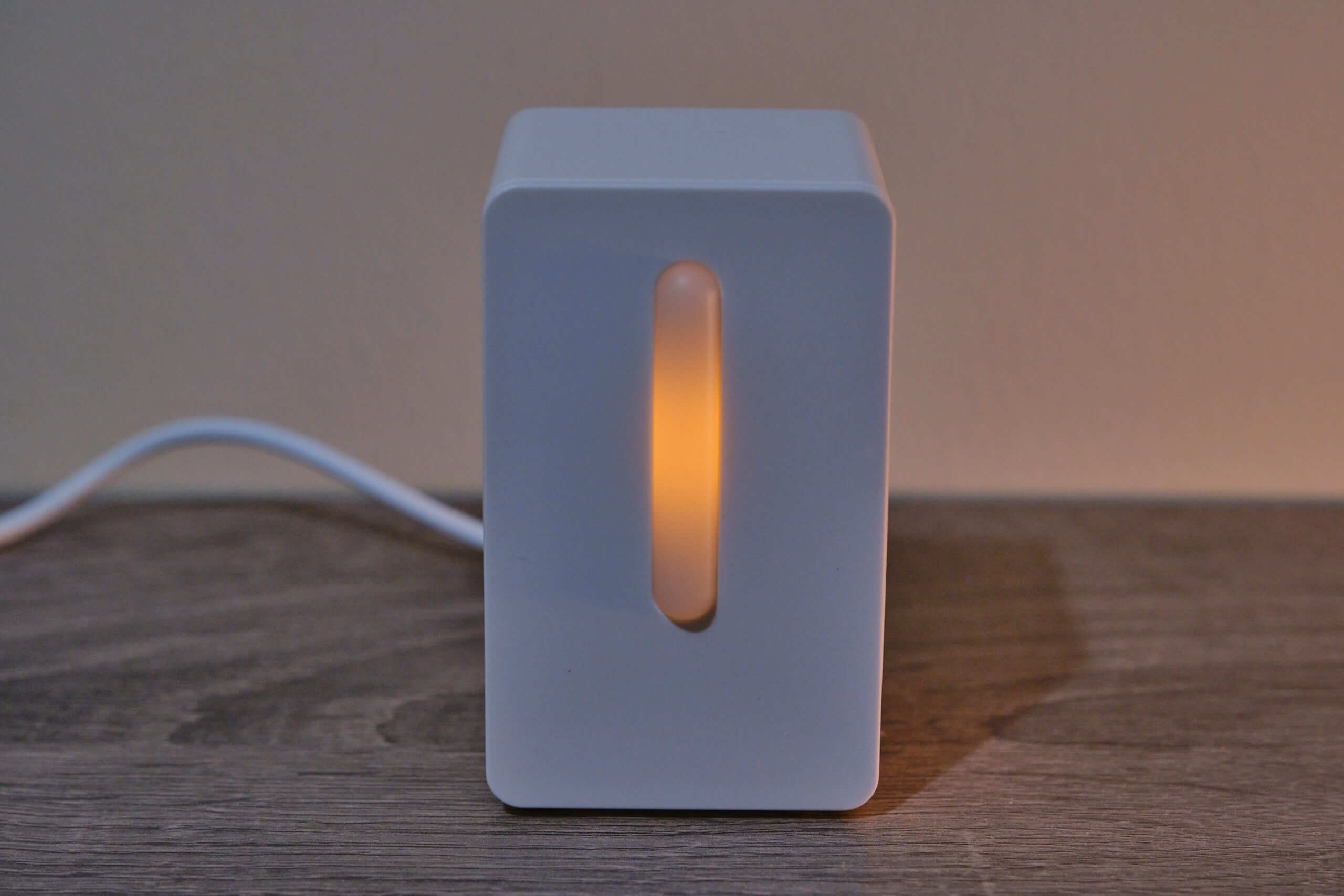

On the front of the device, you will find a transparent plastic bar which looks akin to a glass thermometer. Behind this bar are three LEDs which illuminate the bottom of the bar green when the air quality is good, the centre orange when it’s moderate, and the top red when it’s bad. This simple traffic light system is the only way you will be able to identify the current air quality.
There is nothing between these three colours – no yellow between green and orange and no dark orange between light orange and red. This means the device is very easy to interpret at a glance, but it also means there are only three levels of air quality that the device can differentiate between, which is not particularly useful.
While I understand the need to keep costs low, a couple of extra LEDs would cost IKEA almost nothing. Even better, a few RGB LEDs would also cost a negligible amount, yet they would significantly improve the usefulness of the monitor. I can’t understand why they made the decision to keep this device so simple other than to encourage users to purchase the more expensive monitor.
With that said, the traffic light system could be somewhat helpful in that it gives users insight into whether their air quality is good, acceptable or poor. While it’s not specific at all, this information alone is enough for some people, and if that’s the case, the design of the Vindriktning may not be an issue for you.

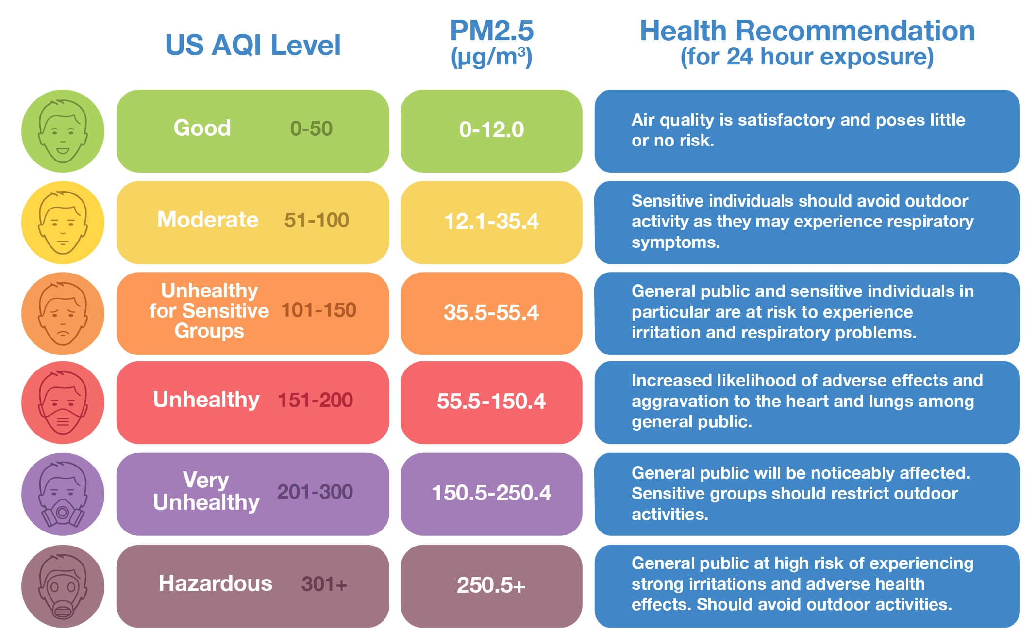

These thresholds for each light lead me to another issue. The brackets are simply terrible – an issue which is shared by the more expensive Vindstyrka. The WHO lists 15µg/m3 as the PM2.5 guideline for average 24-hour exposure, and the average annual exposure as only 5µg/m3. The Vindriktning, on the other hand, considers both of these (maximum) values as green or ‘good’!
IQAir AQI Scale
U.S EPA Guidelines. Image from IQAir.
I could give the thermometer-like design of the Vindriktning a pass if two changes were made: firstly, the thresholds were significantly lowered. For example, green might stop at 20µg/m3 (or even lower), and orange would cover 21-50µg/m3. Secondly, the sensor would actually need to be accurate. If both of these were changed, it would be possible to glean some insight from the device at least.

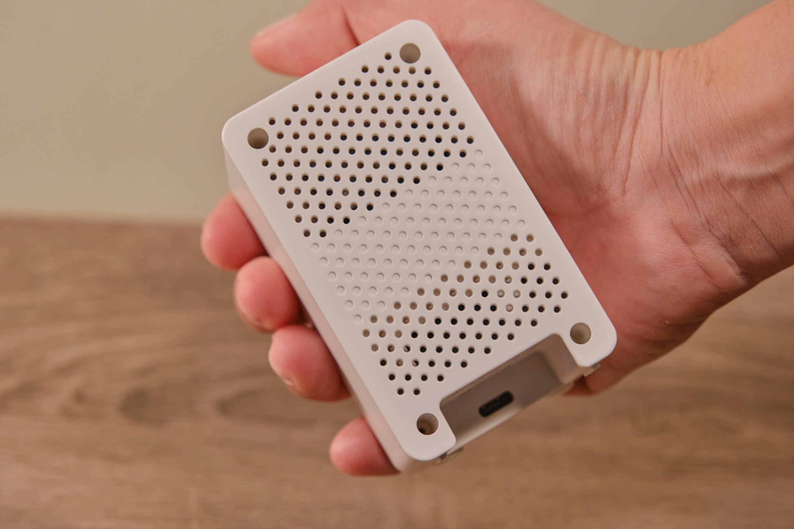

Also, on the back of the device, you will find air vents, which are there to allow particles to enter the device. Interestingly, there are no buttons to be found anywhere on the device, meaning you can’t change settings anywhere – again, showing how simple this device is.
