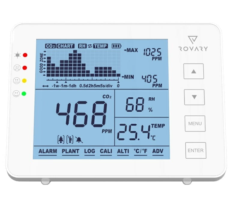

Before diving into the article, however, I want to mention that the Forensics Detectors Carbon Dioxide Monitor is a white-labelled product. You may have seen identical devices sold by brands such as Rovary and GZAIR. For the most part, these devices are the same and share a feature set.
Left: Forensics Detectors Carbon Dioxide Monitor. Right: Rovary Carbon Dioxide Monitor
With that said, each product seems to have some minor differences. For example, the display on the Rovary device varies significantly from the Forensics Detectors device. The GZAir product, on the other hand, features an exporting data function unavailable on the Forensics Detectors model.

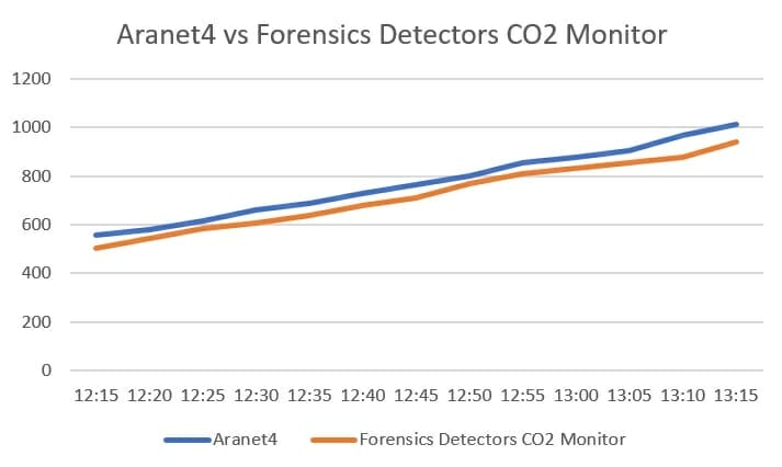

The most important aspect of any carbon dioxide monitor is, of course, its accuracy. Therefore, I decided to run some tests to ensure you can rely on the Forensics Detectors Carbon Dioxide Monitor. While I don’t have access to a reference monitor to compare against, I compared it against the Aranet4 – a monitor often regarded as the most accurate consumer-grade carbon dioxide monitor.
Since carbon dioxide concentrations can vary greatly – even with both devices within close proximity of one another – I created a temporary test setup to monitor both devices. While by no means perfect, placing both devices in a box with constant airflow (provided by fans) allowed me to ensure minimal discrepancies recorded in the air by both devices.
This box was placed in a large room without ventilation for an hour. In this situation, you would expect to see a gradual increase in carbon dioxide concentrations recorded by both devices. While you would expect the increase to be mostly linear, some minor differences are caused by uncontrollable variables.
For the first test, I compared the factory calibration of the Forensics Detectors monitor with an accurate manual calibration of the Aranet4. Both monitors provided similar results in this test, but the Forensics Detectors Carbon Dioxide Monitor consistently recorded concentrations 30-60ppm below the Aranet.
Forensics Detectors CO2 Monitor Accuracy
Since the monitors consistently had similar readings and exhibited the same trends, I figured a calibration issue was the most likely problem. As such, I recalibrated both devices in the same outdoor air. The Forensics Detectors Carbon Dioxide Monitor features manual calibration, and it’s a painless process – select the calibration option and allow the device to sit for 300 seconds.
After the calibration on both devices was complete, I reran the same tests. Starting at around the same carbon dioxide concentration, I used my box setup to again record the increase in carbon dioxide concentration over an hour in the same room. The results are fascinating!
Forensics Detectors Accuracy
After calibrating the Aranet4 and Forensics Detectors CO2 Monitor in the same conditions, they provided almost identical measurements for the next hour. While some readings differed significantly, these were within the margin of error of both devices (± 30ppm for the Aranet and ± 50ppm for the Carbon Dioxide Monitor).
Since running these tests, I’ve had both monitors on my desk to continue comparing their readings. Over the past week, they’ve read within ten parts per million very often, sometimes even measuring the same concentration! Needless to say, I’ve been very impressed by the accuracy of the Forensics Detectors Carbon Dioxide Monitor, as it’s a significantly cheaper device.
The only caveat I need to mention is regarding calibration. Forensics Detectors suggests manually recalibrating the device every six months. However, I would recommend more frequent recalibrations – perhaps every month or two. Even over a month, I’ve noticed some drift, and I wouldn’t want to use the device for six months without any manual calibrations.
Thankfully, there is no automatic calibrating working behind the scenes on the Forensics Detectors Carbon Dioxide Monitor. While automatic calibration may seem useful, it often leads monitors to increasingly inaccurate readings. I discussed this issue in-depth in my Vitalight Mini CO2 Detector review, and I recommend referring to that article if you want to know why automatically calibrating devices may be worth avoiding.

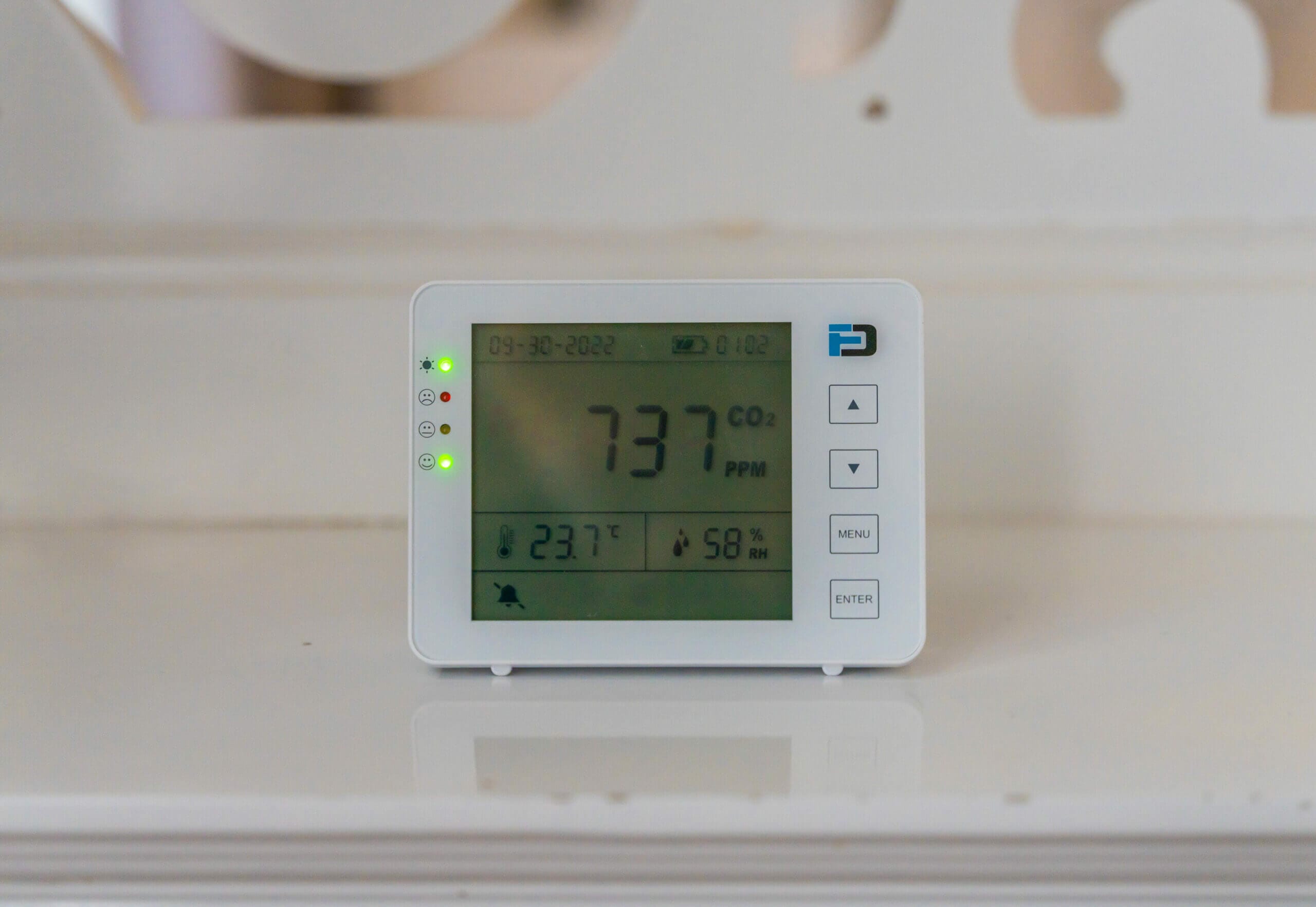

The Forensics Detectors Carbon Dioxide Monitor has a simple design, but I wouldn’t call it minimalist like the Aranet4 or Qingping Air Monitor Lite. The design makes it instantly apparent that the Carbon Dioxide Monitor isn’t meant as a portable solution – rather, it’s intended to live somewhere in your home or office.
The monitor is large, has a relatively short battery life, and has a large screen. Together, these factors show that the Forensics Detectors Carbon Dioxide Monitor is best suited to living in your home or office. If you’re looking for such a device, you will want to consider a smaller monitor, such as the Vitalight Mini CO2 Detector.
With that said, the Carbon Dioxide Monitor from Forensics Detectors is a perfect desk-based solution. The user interface is clean and easily readable, and the device’s size and shape mean it is visible even from metres away. Since the battery life is quite short (eight hours – although I’ve found it to be around 24 hours), you’ll also find you want this device almost permanently plugged in.

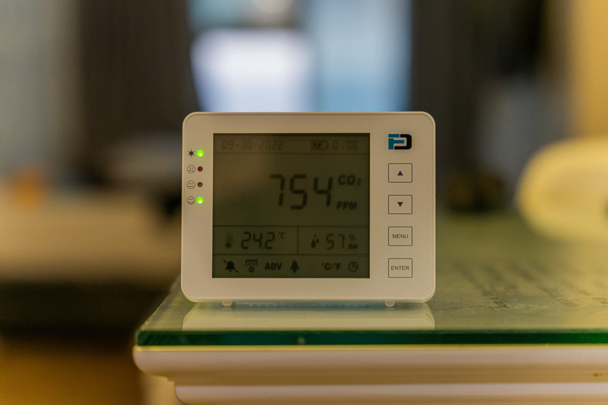

Unlike most other carbon dioxide monitors, the Forensics Detectors Carbon Dioxide Monitor does not use an E-ink screen. While this has the benefit of meaning the screen can be backlit (just hit a button, and the screen will light up), it also means the screen is less visible in brighter light, and the viewing angles are worse. Since the LEDs allow you to identify the CO2 concentration in the dark quickly, I would have preferred an E-ink screen.
This image has been brightened significantly. Without editing, it’s almost impossible to see the screen in low light.
However, while the screen isn’t very bright, I don’t find this a major issue with the product. What is frustrating, however, is that to make the screen backlight activate, you need to press a button and pressing a button makes a loud beep. While you can turn the concentration alarms off, you can’t disable the sound on button presses. This makes it difficult to use at night when you don’t want to wake anyone or pets.
Furthermore, the screen brightness is almost blinding in the dark. To fix this issue, I would have loved to see a button on the top of the device (similar to a sleep button on an alarm clock), which would light the screen, but at only 30% or 50% brightness. This button could have been silent to press and would’ve been a better option than pressing the menu, enter, or up or down arrows simply to highlight the screen.

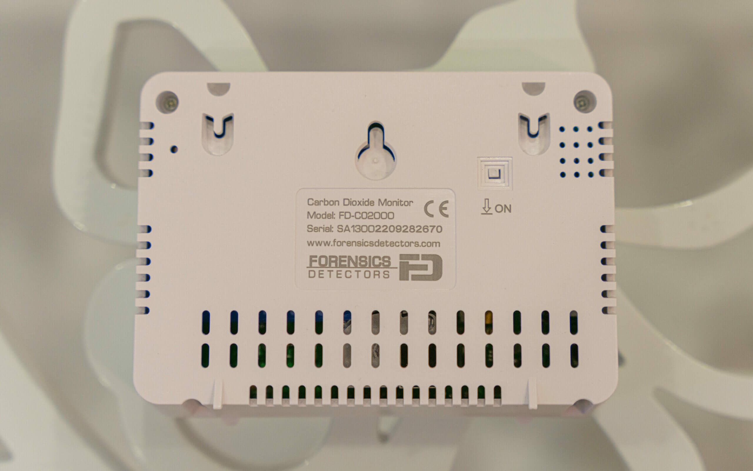

Turning the device around, the back of the product is covered in vents that act as air intakes. As usual, the device is prone to water damage, and you’ll want to ensure it’s always clear of any potentially hazardous areas. There is also an on/off button, which, as the name suggests, turns the product on and off.
Forensics Detectors CO2 Monitor Back
There are also two screw-mounting holes on the back of the device. These holes may be very useful if you intend to mount the monitor somewhere. However, I would still recommend the non-USB-powered Carbon Dioxide Monitor for anyone wanting a wall-based solution.
