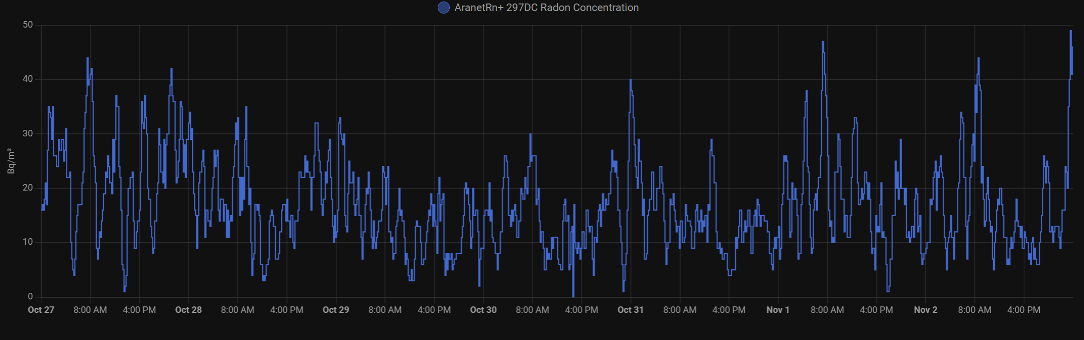

Radon concentration as measured by Aranet Radon Plus
Radon measurements from the condo I am staying in.

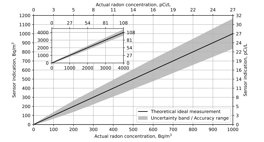

* Every radon monitor has an inherent error and a level of uncertainty. While most manufacturers don’t mention it, Aranet has stated that 95% of readings fall within this accuracy margin.

Aranet Radon Plus Accuracy
Where most monitors in the same price range state their accuracy as ±10%, I appreciate Aranet stating the accuracy as ±8%, but only for 95% of readings. As mentioned, there is an inherent error with these kinds of sensors, and there is always a level of uncertainty. If Aranet were to expand the accuracy to, say, ±10% as well, even this would only apply to (this is a total guess) 98% of readings. The same applies to other radon sensors, but most manufacturers don’t state the uncertainty of their sensors.

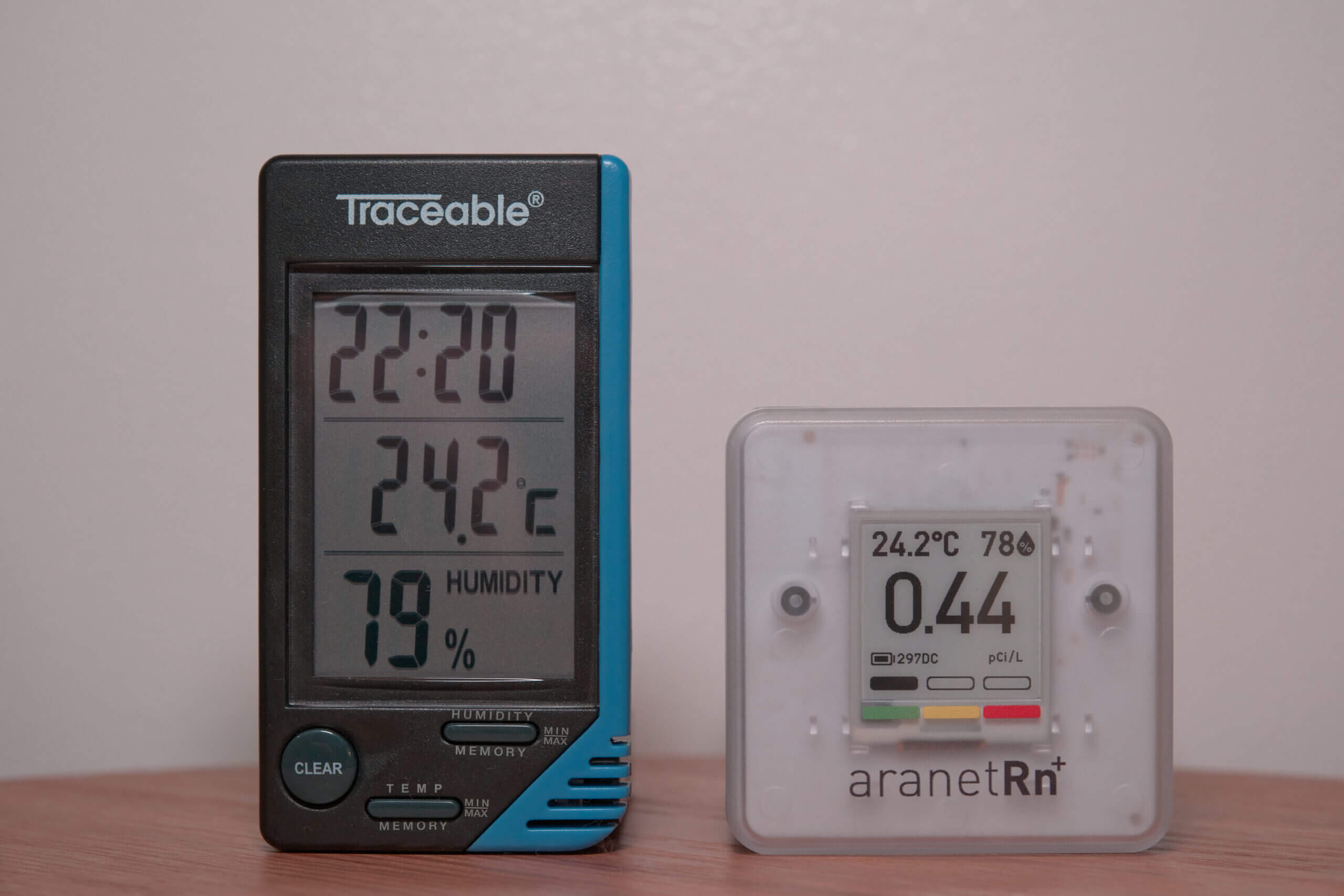

Aranet Radon Plus and Traceable
Regarding temperature and relative humidity, it seems that Aranet has kept its usual accuracy, and this monitor performs very well. Compared to the Traceable monitor that I use as a reference, the Aranet Radon Plus was always within half a degree Celsius and within a few percentage points of humidity. As both devices have some errors, this is expected, and I was impressed with how the device performed overall. Like the Aranet4 Home, you can expect to get good temperature and relative humidity readings from this device.

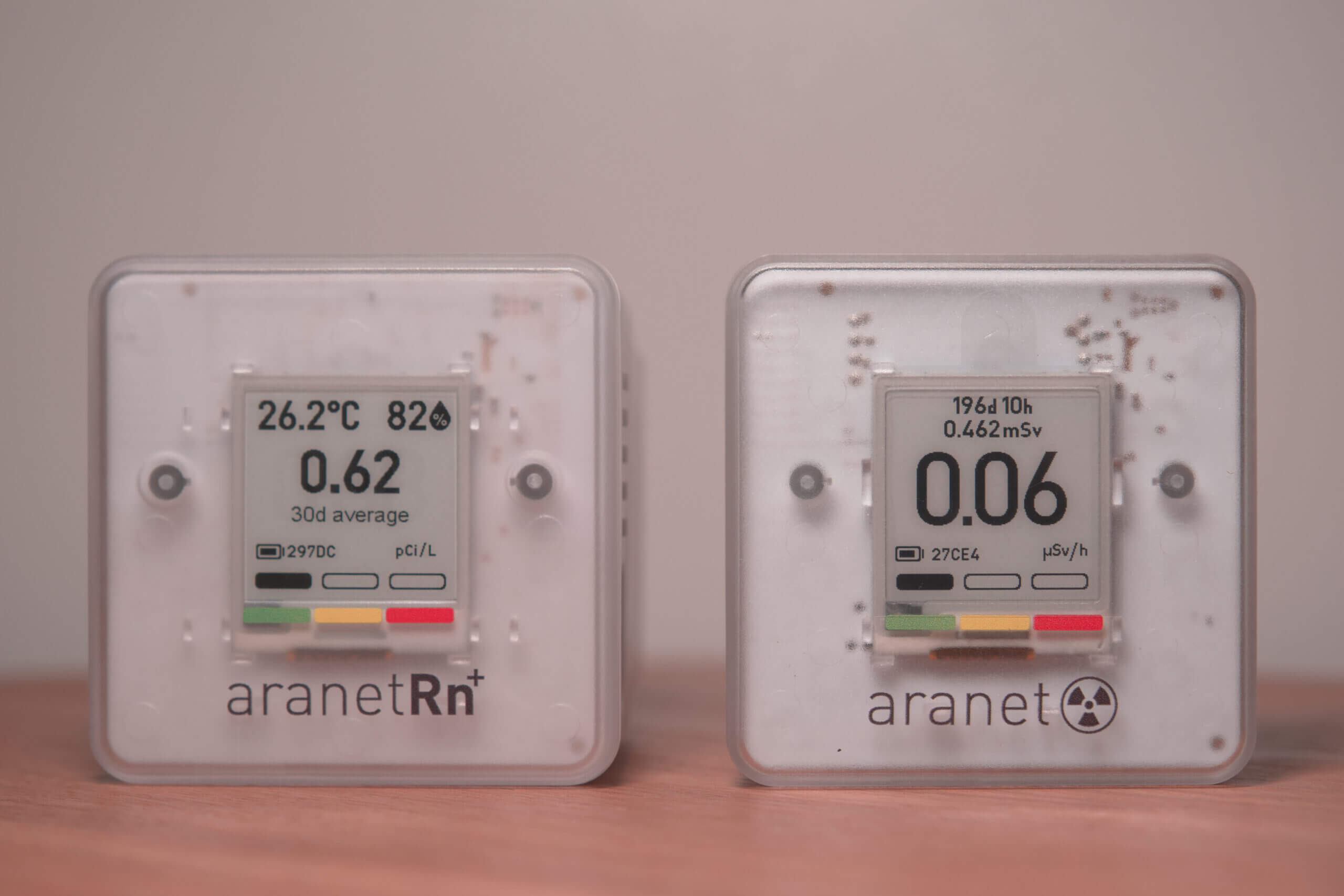

Aranet Radon Plus and Radiation
On one hand, the Aranet Radon Plus looks exactly like its siblings in the Aranet Home family. On the other hand, as soon as you turn the device around, you realise it is much larger and almost three times as long. While this means it’s far less portable than the other Aranet Home monitors, radon monitors generally aren’t meant to be moved frequently, and I appreciate the design consistency across the range.

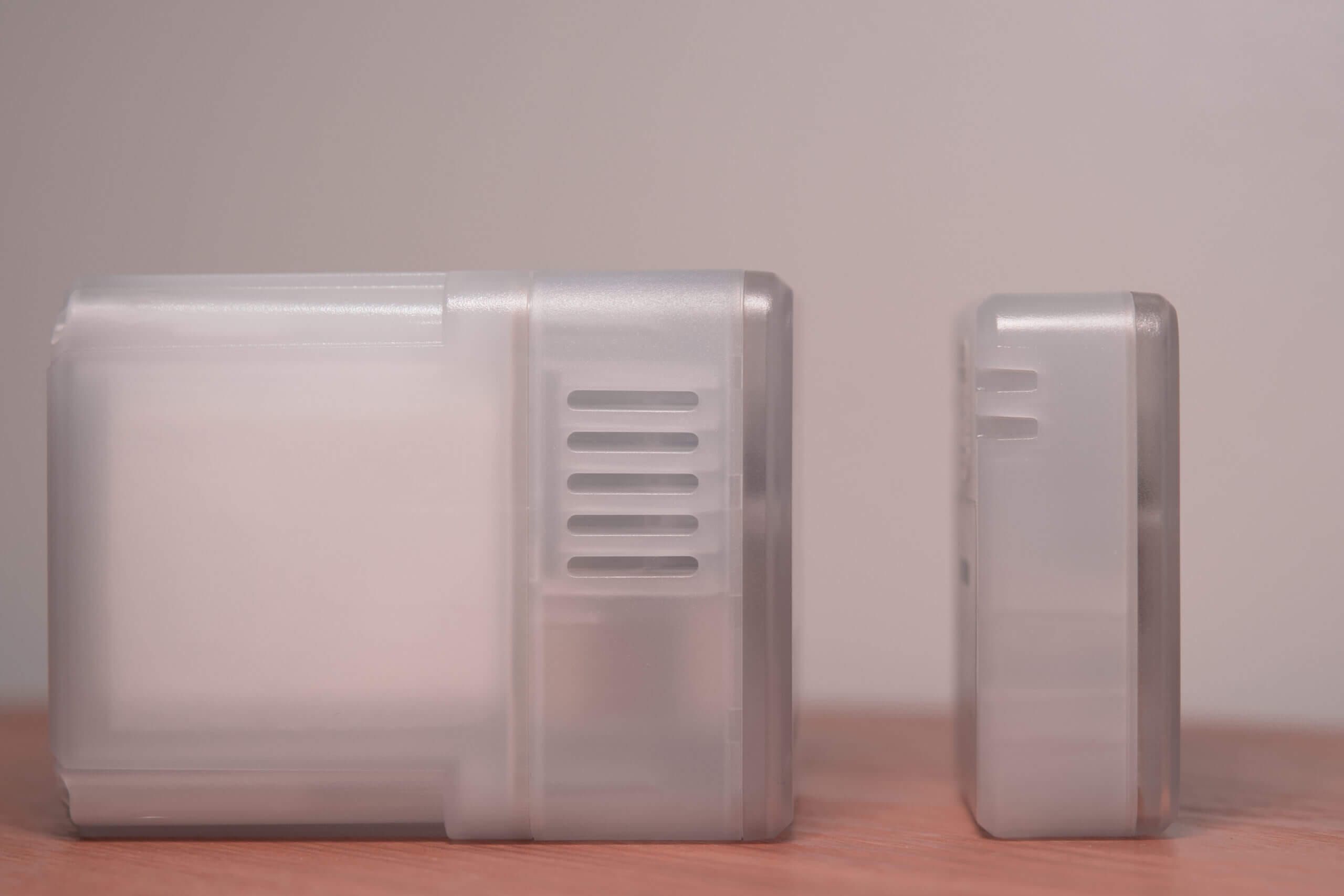

Overall, the monitor measures 71x71x77 mm, making it a relatively compact radon monitor similar to the EcoQube (but much smaller than devices like the RadonEye). The reason for this increase in size over the other Aranet Home devices (which measure 70 mm x 70 mm x 24 mm) is the means the monitor uses to measure the radon concentration.
The Aranet Radon Plus uses an ionization chamber to record the radon concentration, and the need to house this sensor restricts how small the device can be – much in the same way that, until recently, CO2 monitors have needed to be a certain size to house the lasers required in transmissive NDIR sensors. However, while the device is much longer than other Aranet devices, I appreciate how the company has kept the face of the monitor the same as it fits perfectly next to other Aranet monitors on a shelf or desk.
Aranet Radon Plus Size

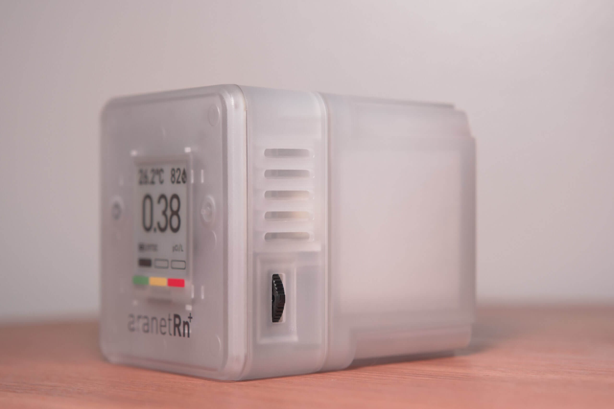

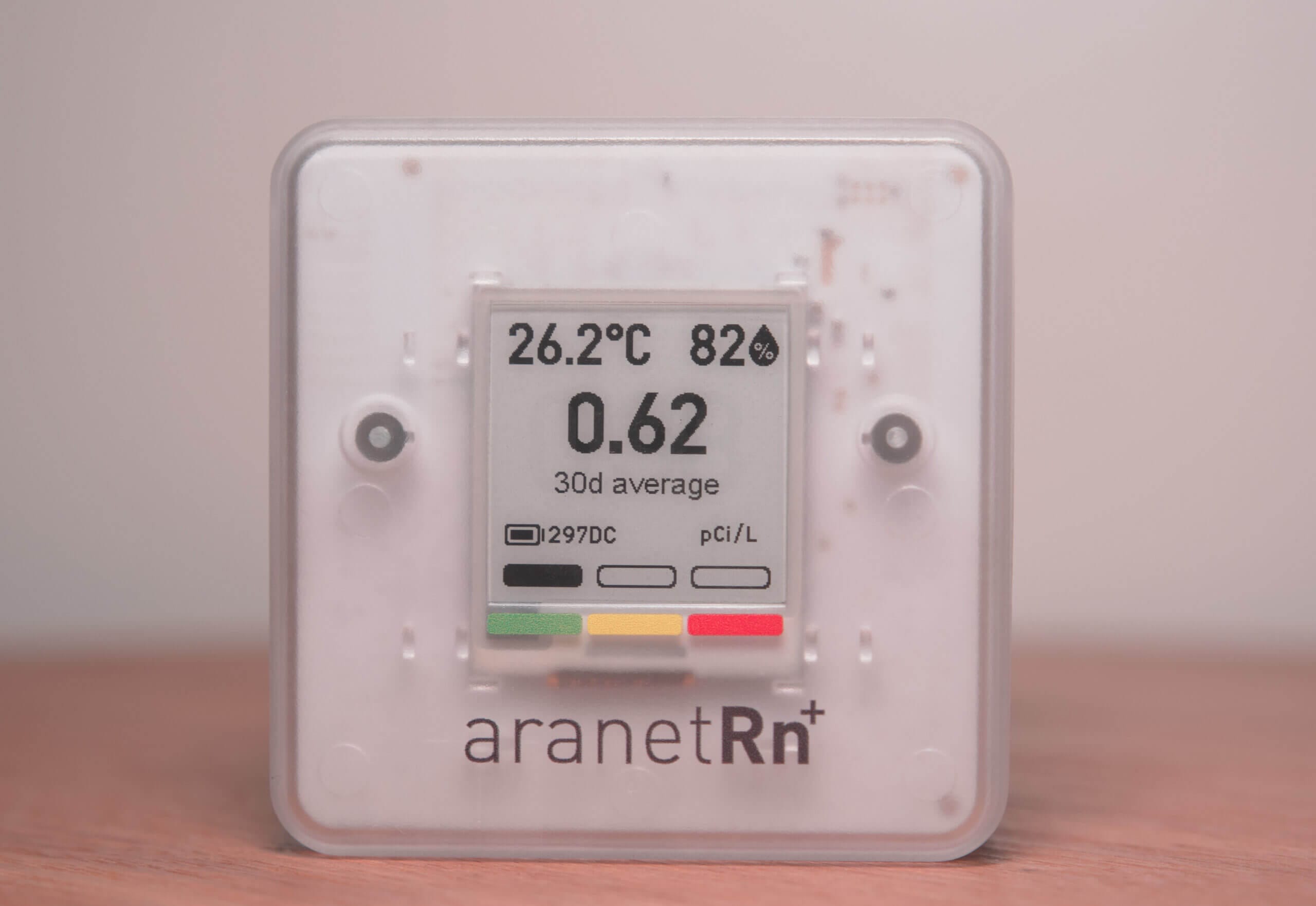

With that said, let’s discuss the device’s ‘face’. On the front, you will find large branding, with a small E-ink screen located in the centre of the square. This display is identical (as far as I can tell) to other Aranet devices, and it simultaneously displays the temperature, relative humidity, radon concentration, battery life, and the units on the screen. A ‘ traffic light ‘ at the bottom of the screen represents your current concentration and risk level.
The monitor also measures air pressure, but this is not shown on the device’s screen and can only be found in the app. While I’m not a fan of ‘hidden’ measurements, I think this is acceptable. I very rarely want to view the air pressure, as it remains consistent unless I’m travelling with the monitor. Again, a radon monitor is not a monitor you would want to travel with, unlike a CO2 monitor.
On the right-hand side of the device is a small wheel that you can scroll to navigate through its four displays. These displays show the current concentration, 24-hour average, 7-day average, and 30-day average. Handily, the screen will not automatically revert to the default display (the current concentration), meaning you can set the device to display whichever metric is most important for you. Personally, I keep mine showing the current concentration and check the longer-term averages on the app. Again, the longer term averages are the numbers you should be focusing on.
Aranet Radon Plus Side View (2)
I’ve never been a fan of control-wheel-type interaction methods in the past, but I actually don’t mind it on this device because it feels solid (there is no sideways movement when I scroll with the wheel) and is very responsive. Every time I scroll with this wheel, I know the device will respond, and I appreciate this implementation of a control method that I am otherwise not a fan of.

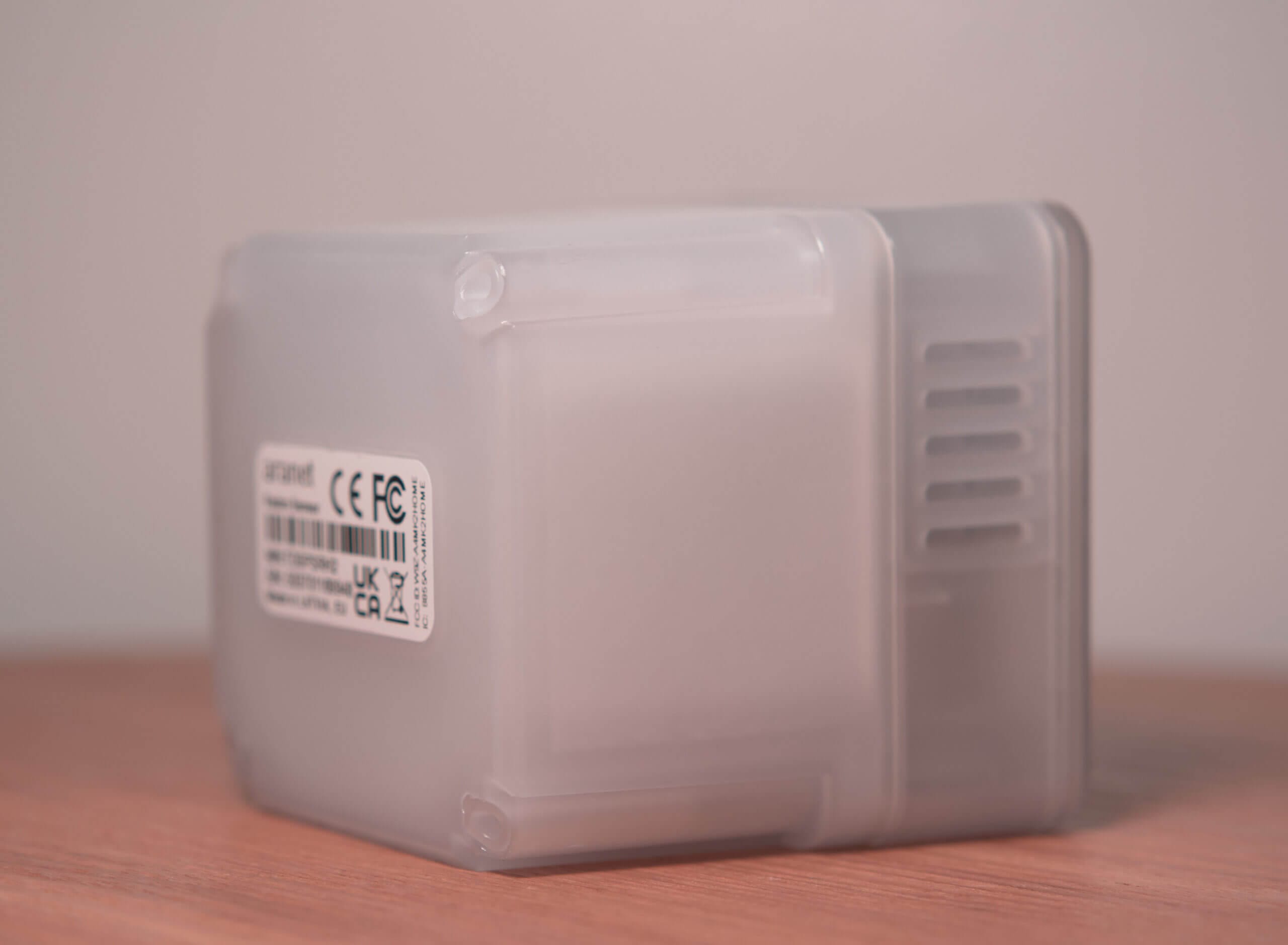

Unlike on other Aranet devices, where you insert the batteries in the back of the device, on the Aranet Radon Plus, you need to insert the two AA batteries from the bottom. The latch feels a bit flimsy, but since I don’t think I’ll be replacing batteries often (the battery life is up to 7 years, depending on factors such as Bluetooth usage), I don’t believe this to be a big deal.
Continuing to rotate the device, we find little of interest other than a couple of vents on the side of the device, which allow the gas to enter for measurement. There is also some regulatory information on the back of the device.

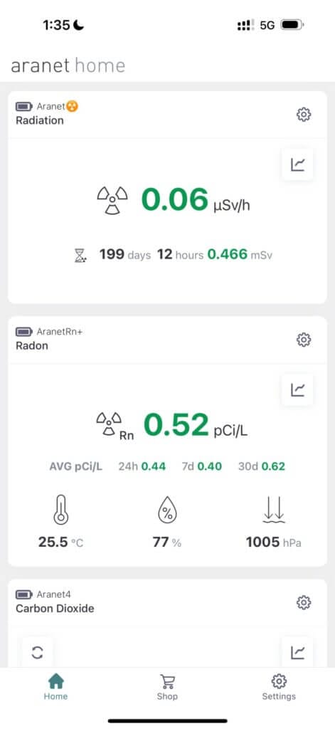

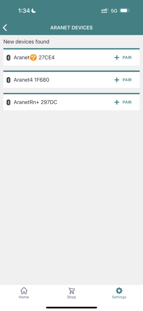

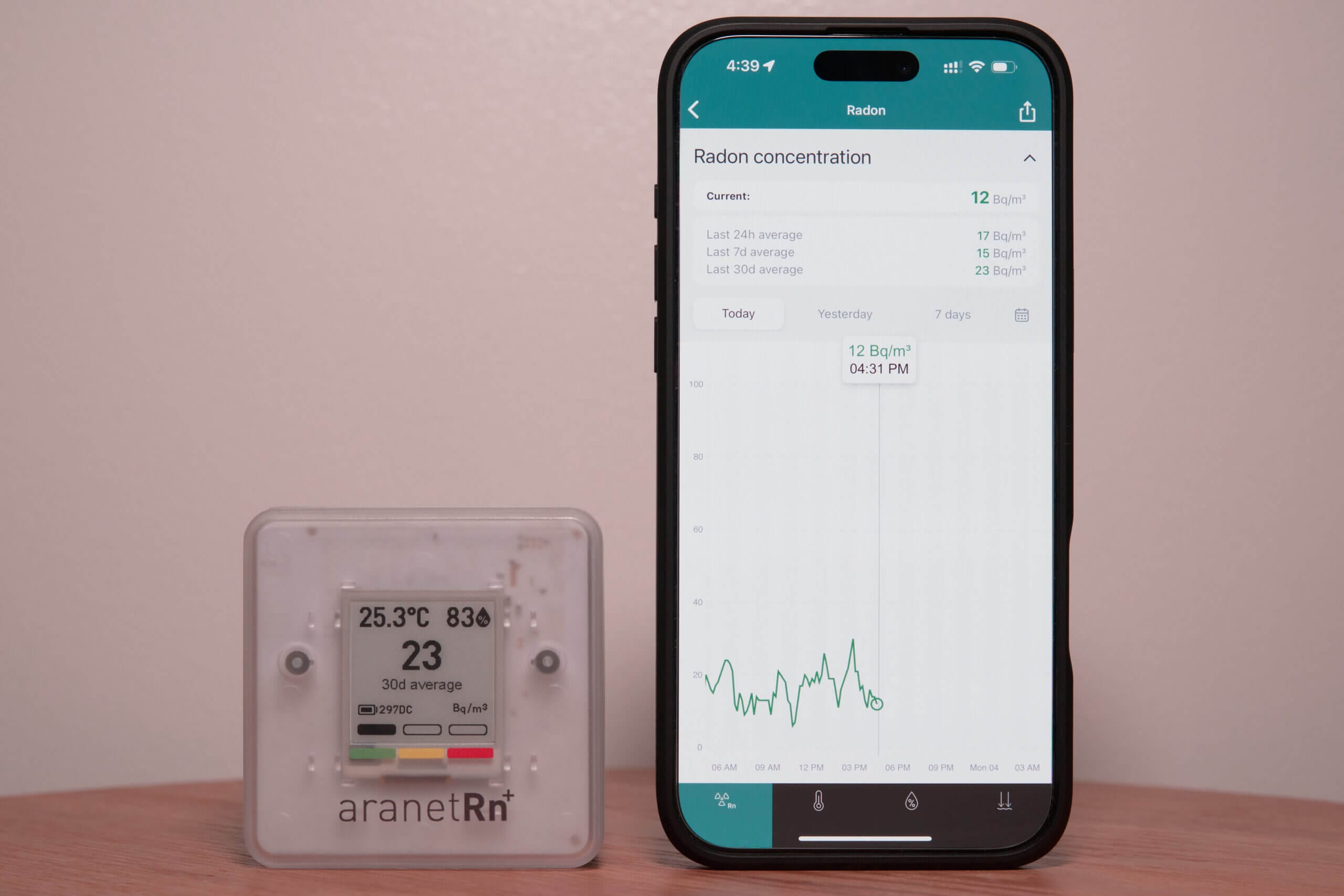

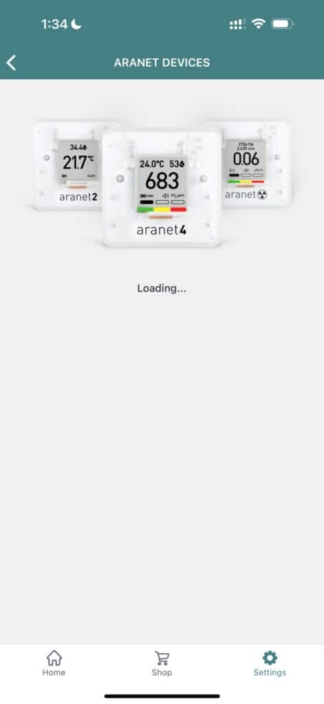

As with other Aranet Home devices, the Aranet Radon Plus connects to your iOS or Android device via Bluetooth. While this does have some limitations (you will need to remain close to the device to sync it with your smartphone), I find connectivity to be great as long as the device is in the same room as mine.

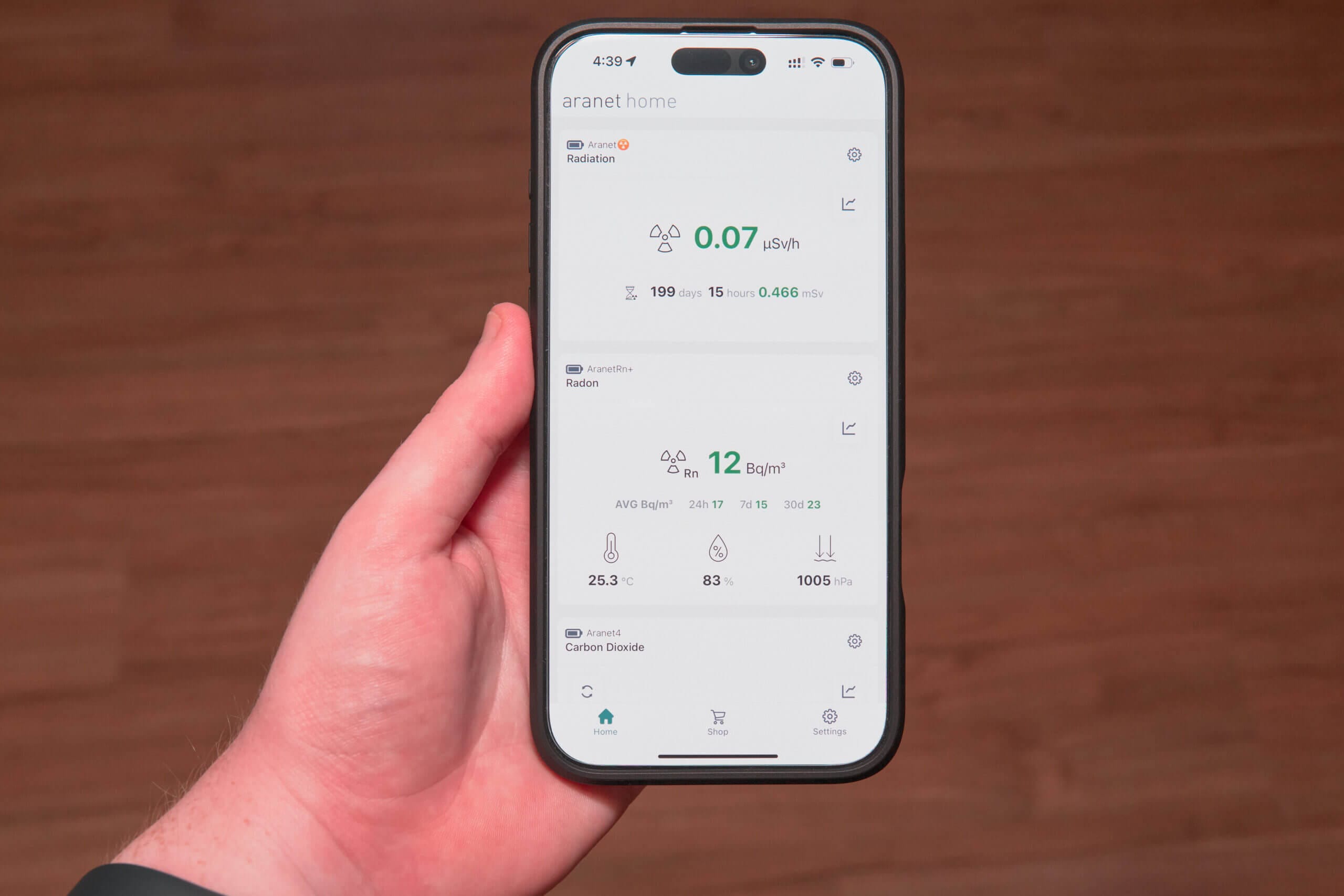

Upon downloading the app, you can launch it and jump right in. I recently upgraded my phone and had to re-add all of my Aranet Home monitors to the new app. I forgot how painless this whole process is as there is no need to make (or log into) an account, and you don’t even need to put the monitors in a pairing mode – simply open the app and tap ‘pair new device’ and all nearby Aranet devices will appear. This simplicity and ease of use are part of what makes this app so great.
Once you’ve added your Aranet Radon Plus, it will appear under the app’s ‘home’ tab. If this is your only Aranet Home monitor, the device will appear in isolation. However, if you own any other monitors in the series (which currently consists of the Aranet2, Aranet4 Home, Aranet Radiation Monitor and Aranet Radon Plus), these will also appear in the same section. While I’m generally not a fan of brand ‘ecosystems’, Aranet’s digital centralisation of its Home devices creates a great user experience.
Since a Bluetooth connection is required for data transfer, data will only sync between your monitor and smartphone when you open the app and try to view historical data. This is usually quite a quick process, and even when I have a week or more of data to sync, it takes less than 10 seconds to appear in the app. On top of this, the device appears to have a decent amount of internal storage, and when I set up the app on my new phone, it instantly imported about one month of previous data from the device.
This internal storage is incredibly handy as it means the monitor can have great battery life without maintaining a constant Bluetooth connection. You also don’t need to worry about losing data if you forget to sync your monitor occasionally. I wish more monitors would hold such a large amount of historical data locally.
Historical data can be viewed through graphs on the app. While the graphing functionality here is quite decent (you can toggle between day, yesterday, or week views), there is also the ability to export data for anyone wanting to graph or inspect the data using more specialised software such as Excel. Since the monitor also has a temperature, atmospheric pressure and relative humidity sensor, you can view and export this data alongside the radon readings.
While the app is generally quite simple, there are a few other options to customise your experience. Most importantly, you can change the radon units displayed between pCi/L and Bq/m3. While these measurements both indicate the same thing (radioactivity within a volume of space), some people may be more familiar with one, and it’s nice to have a choice. You can also choose to show the current radon measurement or a daily, weekly, or monthly average. Personally, I tend to use daily or weekly averages as radon isn’t a big issue for me, and the concentrations don’t change very rapidly (if the monitor stays in one place, anyway), and these longer averages help balance the inherent variation in readings that can occur.

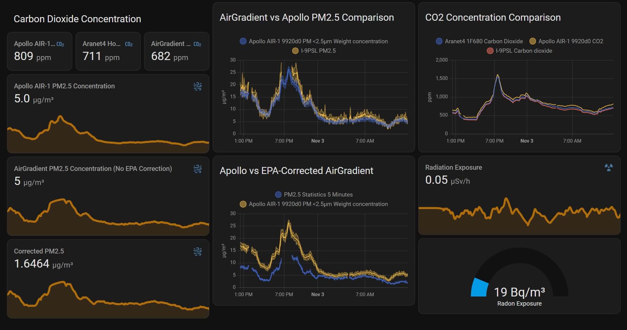

If you want to integrate your monitor more thoroughly into a smart home or use it to control automation, the Aranet Radon Plus also currently supports Home Assistant (through Bluetooth). While the Aranet4 Home also supports Homey, it seems that this integration has not yet been carried across to the other Aranet Home devices, as I can add them to my Homey Pro, but they aren’t recognised and show CO2 as opposed to radon, showing the integration is clearly only targeted at the Aranet4 Home for now.
Aranet Radon with Home Assistant
My Home Assistant dashboard with the Aranet4 Home, Aranet Radiation, and Aranet Radon Plus data displayed.
Luckily, Home Assistant works with all Aranet monitors. By default, the monitor comes with six entities: battery life, relative humidity, air pressure, radon concentration, temperature, and update interval. Although I sometimes have questionable Bluetooth connections, I’ve found the Aranet Radon (and all Aranet Home devices) to work well with my Home Assistant setup as long as they’re within a room or two of my Raspberry Pi.
I appreciate that SAF Tehnika allows the Aranet Home series to have integrations with these platforms instead of trying to keep everything within the Aranet app. While many integrations still aren’t supported (at least not officially), I hope we continue to see more integrations in the future. I would also love to see the Homey integration carried over to non-Aranet4 devices, but I understand the choice as I’m sure the Aranet4 is by far their most popular seller. I’ve been told Aranet will work on a Homey integration for this device, but there is no indication as to when this will be released.
Either way, if you use Home Assistant, you will find the Aranet Radon Plus an even more powerful tool with the range of integrations that it can bring. While there aren’t many automations that I can think of that you would want to run with a radon monitor (for example, you wouldn’t want to turn on an air purifier at a certain concentration like with an air quality monitor), it’s nice to have these options available.
