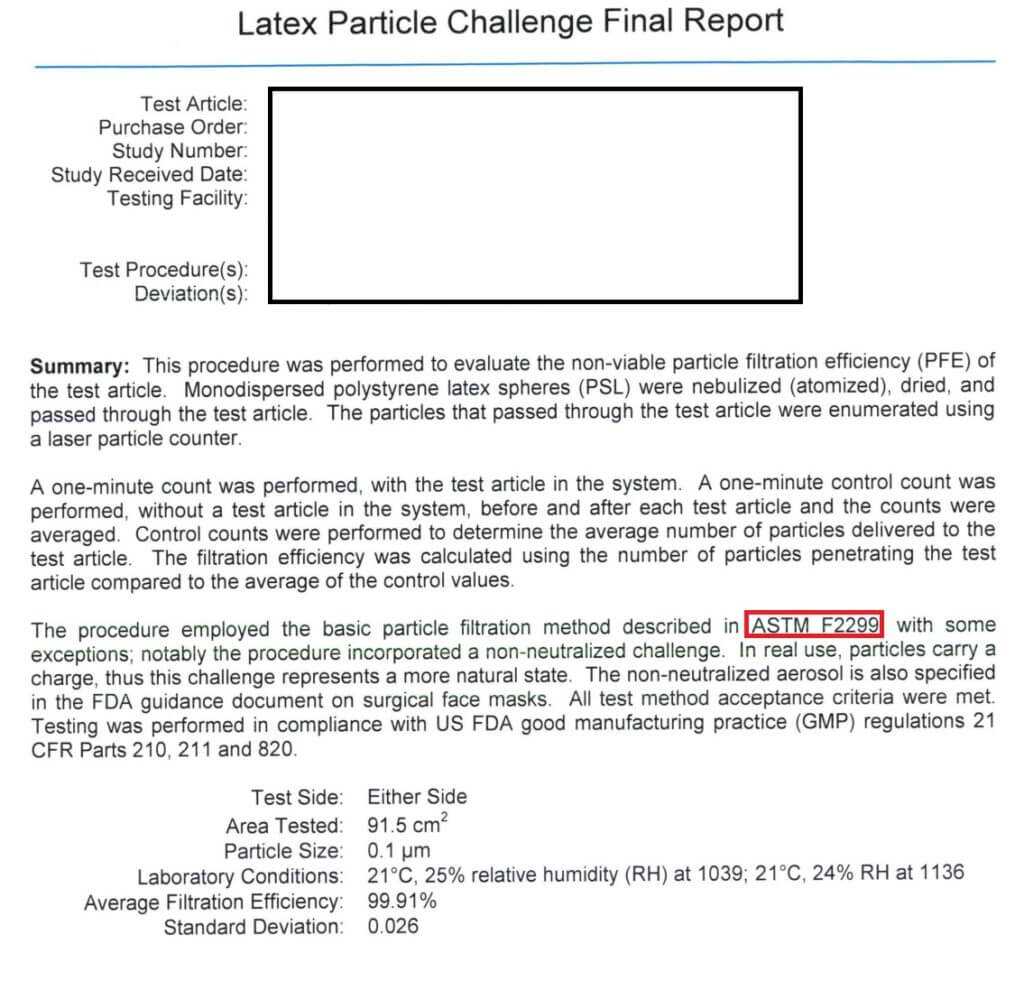

For example, in the case of PFE testing, there are many variables in play. While most labs will follow the ASTM F2299 standard, which defines the testing conditions, there is no set ‘PFE’ standard. Rather, the term PFE refers to a type of test that can vary in testing methodology and specifications. Below is an image of a Latex Particle Challenge Final Report from Nelson Labs. On the report, you can see the test method employed highlighted in red.
Lab PFE Test Report
What makes comparing these standards so difficult, especially in the case of PFE, is that not all labs will test PFE using ASTM F2299. Other labs may instead test for PFE following the European EN 149 standard. This creates issues because there is a range of variables that make these two tests different. Flow rates, particle sizes, laboratory conditions and more can vary.
This leads to issues because it means that, in many cases, PFE test results are not directly comparable. Devices can achieve different results from different standards due to the variables involved. While far from an exhaustive list, below is an example of the different PFE standards:

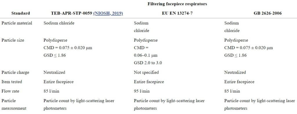

FFR PFE Test Standards
TEB-APR-STP-0059 (N95), EN 13274-7 (FFP-series) and GB 2626-2006 (KN-series). Source
When it comes to particulate filtering efficiency tests, there are two standards that are usually followed. The first of these is NIOSH’s TEB-APR-STP 005x (where the x represents the class of respirator) in accordance with 42 CFR 84. 42 CFR 84 is the procedure used to certify N, R and P series respirators such as N95, R95, and P100 devices. The full testing procedure for TEB-APR-STP-0059 can be found here.
The Standardization Administration of China’s GB2626 standard for KN-class devices also closely follows the NIOSH standard. As the table above shows, testing conditions are identical to NIOSH’s TEB-APR-STP 0059. Therefore, GB 2626 and NIOSH devices are considered the same in this section.

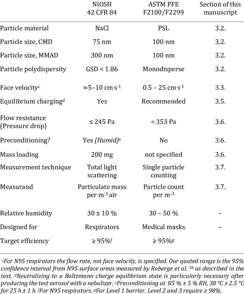

ASTM F2299 vs NIOSH-42 CFR
NIOSH 42 CFR 84 compared to ASTM F2299. Source. CMD = count median diameter. MMAD = mass median diameter. PSL = polystyrene latex spheres. GSD = geometric standard deviation.
Between ASTM F2299 and 42 CFR 84, the NIOSH standard is the more conservative. Due to the smaller particle size, particle charge neutralisation, and higher flow rate, 42 CFR 84 is considered a ‘worst case scenario’. Devices tested at both standards typically perform worse under NIOSH testing conditions (source), and therefore, 42 CFR 84 can be considered the more stringent PFE standard.
All devices tested in the study performed at their worst in NIOSH testing conditions as opposed to under PFE conditions set by ASTM F2299. While the ASTM F2299 is a relatively stringent standard in itself, NIOSH’s guidelines are designed to test respirators and PFE at their most extreme circumstances.
In the most extreme example, a NIOSH-certified device filtered just over 98% of NaCl test particles. The same device showed a filtration efficiency of well over 99% when tested under ASTM F2299 conditions. This was a worst-case scenario, and most NIOSH-tested devices performed more closely to their ASTM F2299 counterparts. However, in all cases, NIOSH-certified device filtration results were lower than ASTM F2299 results.
When compared tested under NIOSH and EN 13274-7 conditions, the NIOSH test will often show lower filtration efficiency. This is due to the fact that NIOSH requires particles to be neutralised, something that neither EN 13274-7 nor ASTM F2299 requires. Since many respirators and filters rely on electrostatic attraction, this makes the NIOSH test more challenging (source).
While there are other variables to be considered, studies have shown that NIOSH’s PFE testing is the most stringent and returns lower particle filtration results on tested devices. While devices that perform well under ASTM F2299 and EN 13274-7 can also perform well under the NIOSH conditions, they tend to lose some filtration efficacy

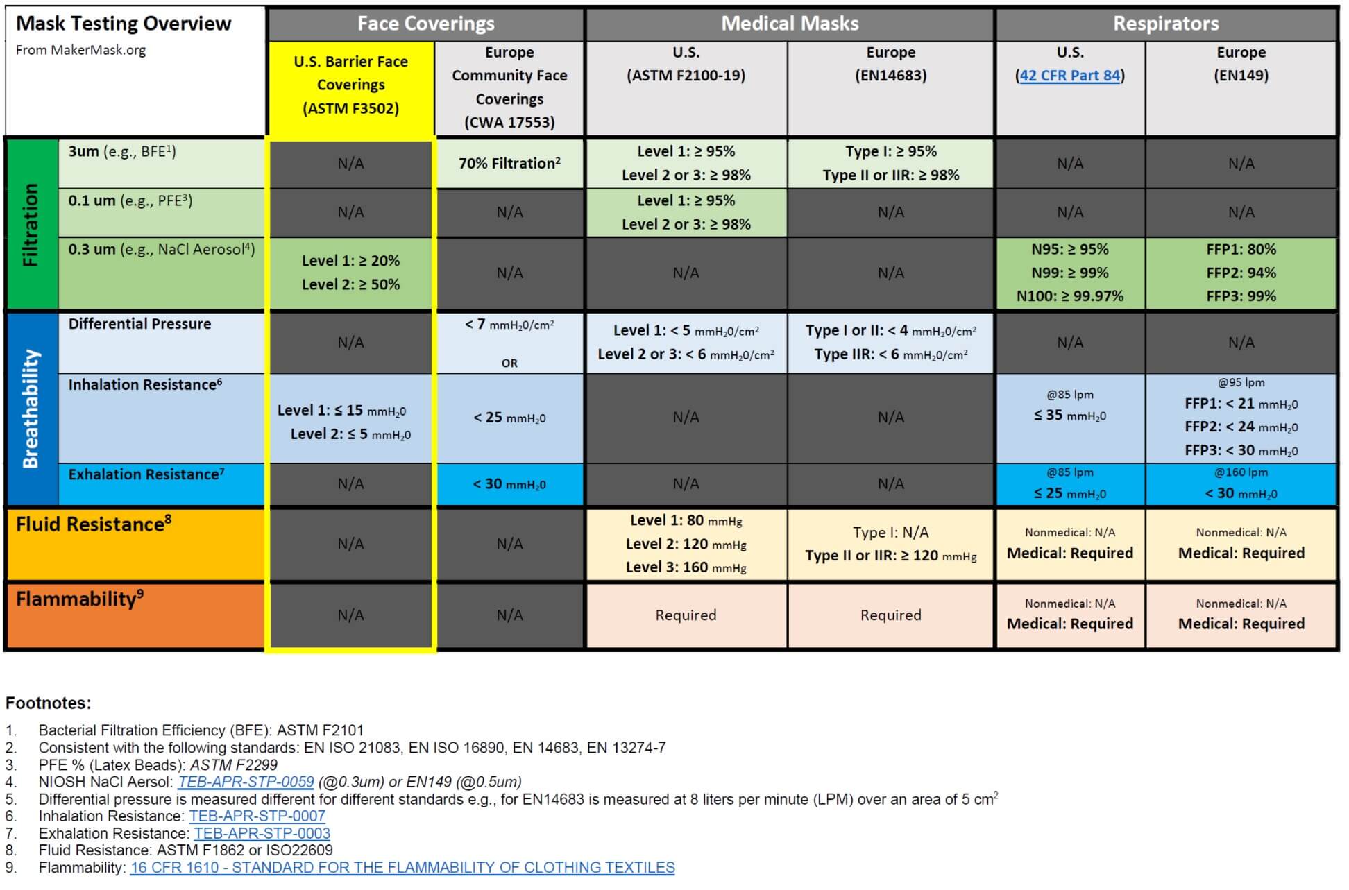

Mask Standard Comparison
Mask Testing Overview from MakerMask.org. The middle column, medical masks, compares ASTM F2100 (BFE as defined by ASTM F2101) and EN 14683.
While ASTM F2100 and EN1683 differ in other specifications, the BFE testing conditions outlined in ASTM F2101 and EN1683 Annex B are identical. This means that BFE results obtained from tests carried out under either of these standards are directly comparable. However, it’s important to reemphasise that the masks certified under the standards are not directly comparable – only the BFE testing conditions are.
On top of this, other medical mask standards, such as AS 4381:2015 used in Australia, also accept BFE testing carried out under the ASTM and EN standards. Where there is a lot of variation in PFE testing methodologies and conditions, BFE tests are far more streamlined, and the two most common BFE test standards are equivalent.

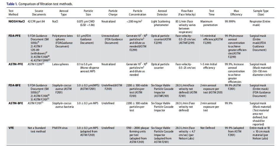

Since I’ve spent so long discussing how not all standards are the same, especially in regard to PFE, I need to define the standards I will be comparing in this section. As such, I’ve chosen the most common PFE test – ASTM F2299 to compare alongside ASTM F2101 and the modified ASTM F2101 that is used for VFE testing. Further, I also want to include NIOSH’s 42 CFR Part 84. This is the most commonly referenced respirator standard and it provides a good point of comparison.
Filtration Testing Methods
Comparison of filtration test methods. Source.
The biggest difference between these four test types is the particle size and type. NIOSH uses a NaCl particle at a count median diameter of 0.075μm. The most common PFE test, ASTM F2299, uses latex spheres at 0.1μm to 5.0μm depending on the test taker’s request. However, even at ASTM’s smallest particle testing size, 0.1μm, the NIOSH test uses smaller particles.
While this difference may seem relatively minor, it can have a significant impact as 0.075μm is closer to the most penetrating particle size (MPPS) of 30-40nm (0.03 – 0.04μm) of N95 respirators that rely on electrically charged fibres (source). Further, the NIOSH test uses neutralised charges which makes it a more challenging test for charged fibres. While ASTM F2299 recommends using neutralised particles, it’s not essential.
ASTM F2101 uses far larger particle sizes for BFE. Since the Nelson Lab’s created VFE test is based on ASTM F2101, both of these tests are identical in particle size. Both tests use particles with a diameter of 3.0μm, and the big difference is the particle type. In the case of the BFE test, staphylococcus aureus is used, and in the case of VFE, PhiX174 is used.

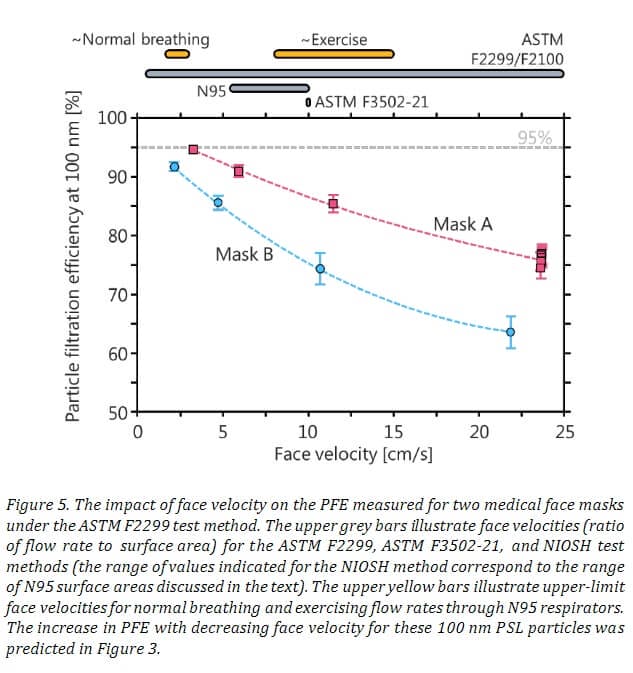

Another key difference between the three standards is the flow rate (or face velocity) used. While it’s very hard to compare face velocity to flow rate due to the fact that it varies from mask to mask, the ASTM F2299 standard can either prove easier or more difficult for masks than the NIOSH standard. This is made more difficult by the fact that ASTM F2299 does not define a set face velocity but rather a range.
According to the study quoted for the graph below, most labs test ASTM F2299 at 5 cm/second. If this is the case, most ASTM F2299 PFE tests are carried out are more lenient than the NIOSH test which requires a flow rate of 85L/minute. Both BFE and VFE tests require significantly lower flow rates, with rates of only 28L/minute being used.
Flow rate vs Face Velocity
Face velocity vs filtration efficiency (source).
Overall, the NIOSH method is the most conservative (source), and a device that has undergone the NIOSH PFE test according to TEB-APR-STP 005x should perform better in PFE (ASTM F2299), BFE and VFE (ASTM F2101 & modified ASTM F2101) tests. Current studies have shown NIOSH’s tests are the most stringent.
In turn, ASTM F2299 tends to be more stringent (in regard to filtration) than ASTM F2101. Assuming the particle size for ASTM F2299 is 0.1μm, face velocity 5cm/second and particles are neutralised, ASTM F2299 is a more challenging filtration test than its BFE and (modified) VFE counterpart.
