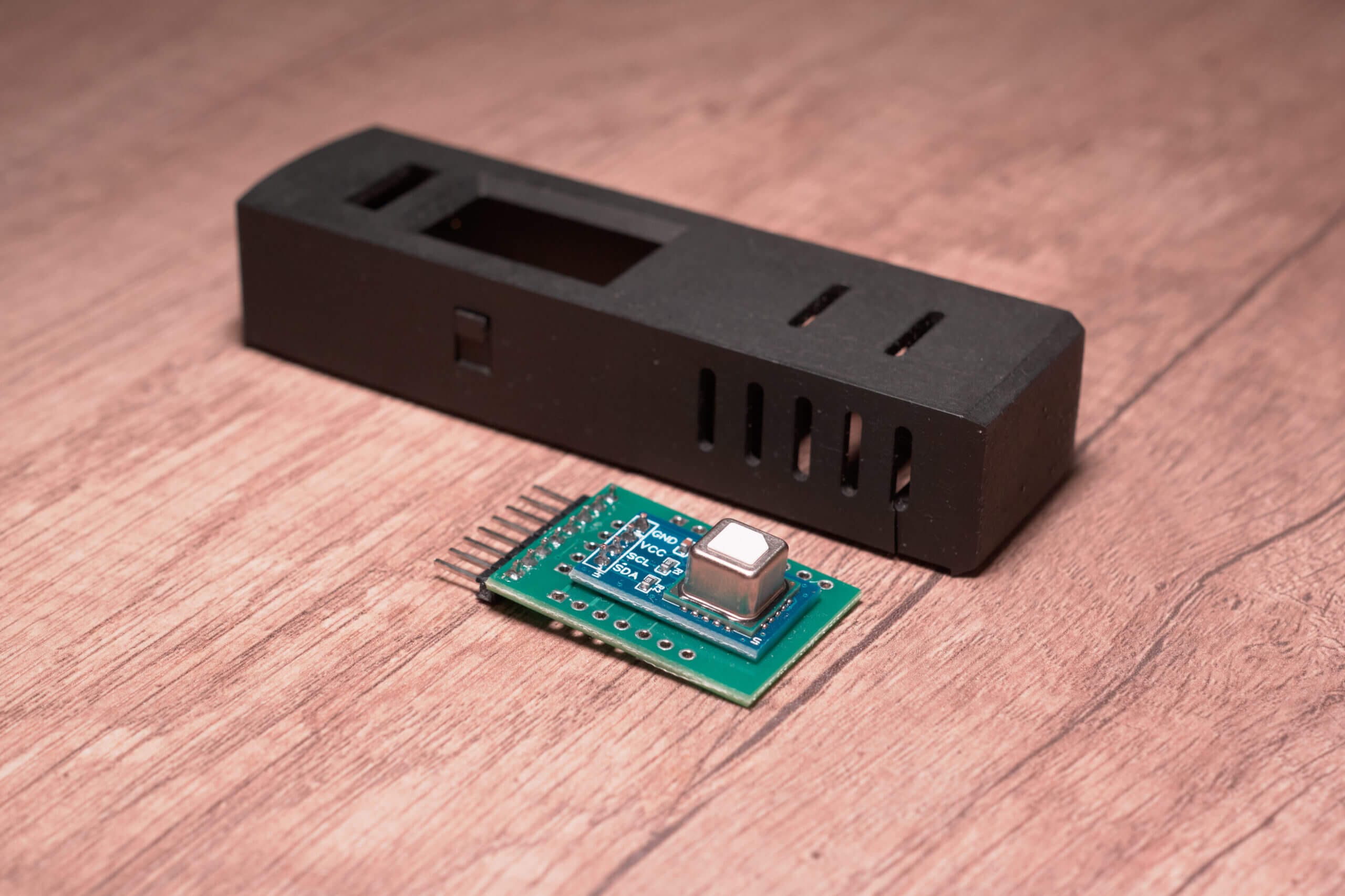

SCD41 Photoacoustic Sensor
Despite being a lower-cost CO2 sensor than its more feature-full siblings, the Model D and Model C, the Model F does not cut corners regarding accuracy. Inside this monitor, you will find one of the most trusted consumer-grade CO2 sensors on the market – the photoacoustic NDIR SCD41 from Sensirion. This is the same sensor in monitors from the incredibly tiny AirValent CO2 monitor to the Qingping/SmartAir CO2 monitor. As an integrated sensor, the SCD41 monitors:

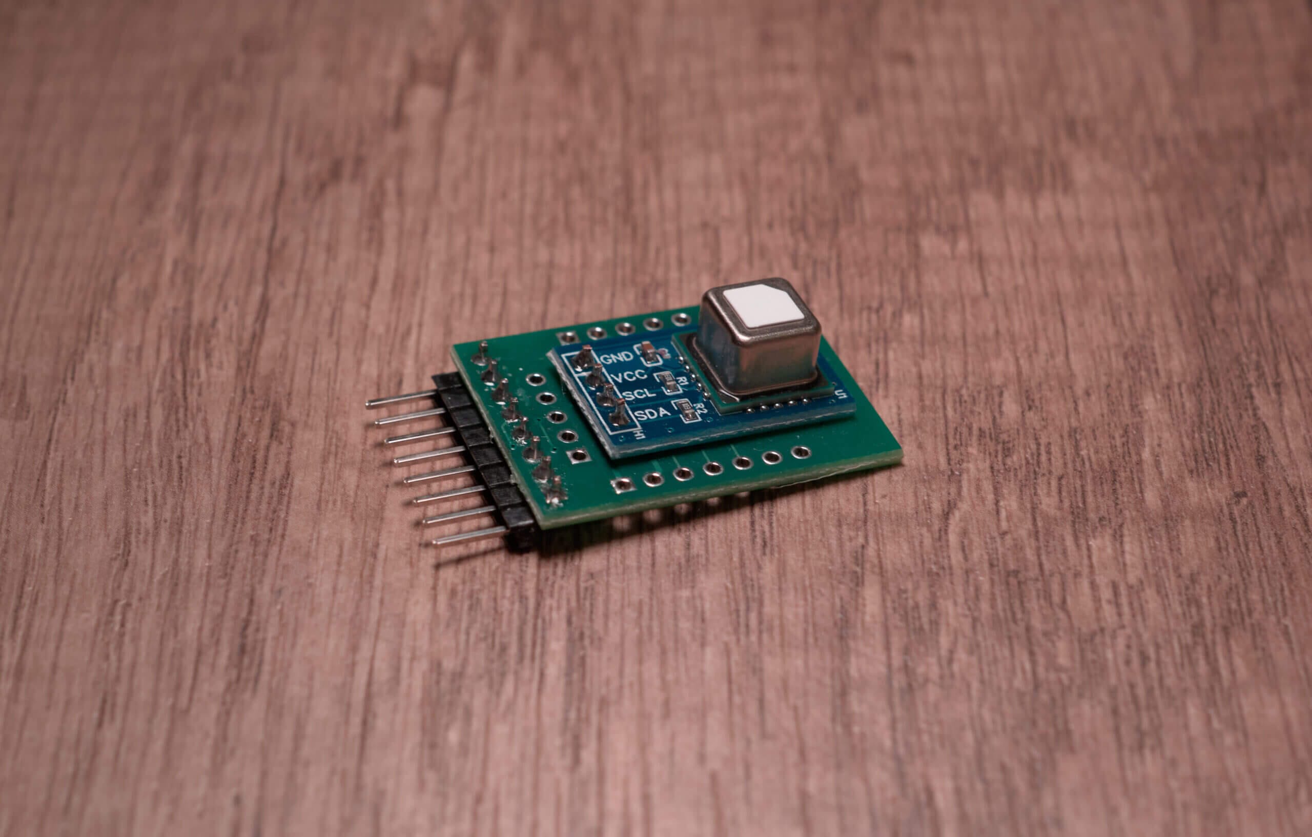

The SCD41 is currently a very popular sensor due to its compact size. While it’s still an NDIR sensor (the gold standard for CO2 monitors), it isn’t a traditional transmissive NDIR sensor like the ones you will find inside the Aranet4 Home and even the other VisiblAir monitors. Instead, it’s referred to as a photoacoustic NDIR sensor, which has a few key advantages and disadvantages. Primarily, these sensors are tiny as they don’t rely on lasers that must be placed a minimum distance apart. This allows the SCD41 to be much smaller and allows for the miniaturisation of CO2 monitors.
SCD41 Sensor
However, there are some disadvantages, too. For example, while similarly accurate to transmissive NDIR sensors, photoacoustic NDIR sensors have some caveats when calibrating them, and they should be calibrated in a sheltered area with minimal airflow. On top of that, they seem to have issues regarding cooler (or hotter) temperatures. While it’s far from conclusive (and I thought it was due to the monitor I was testing at the time rather than the sensor itself), I’ve found that photoacoustic sensors appear to be more influenced by temperature than their transmissive counterparts. However, this likely won’t have much impact on real-world usage.
Anyway, I will discuss these caveats further later in this section. The most important takeaway is that the SCD41 and, by extension, the VisiblAir Model F provide similar performance to the best consumer-grade carbon dioxide monitors, such as the Aranet4 Home and even its bigger sibling, the Model C (which uses a much more expensive sensor). After using this sensor extensively and after comparing Model F to both the Aranet4 and Model C, I conclude that it is accurate when calibrated in the same conditions. However, it’s important to keep in mind that there is a 400 ppm baseline on the Model F. In contrast, on the Aranet4 and some other devices, the baseline is a more accurate 420 ppm, meaning you should remember there is about a 20 ppm offset on this device compared to those devices and likely a 20 – 30 ppm offset compared to the actual CO2 concentration which you can check here.

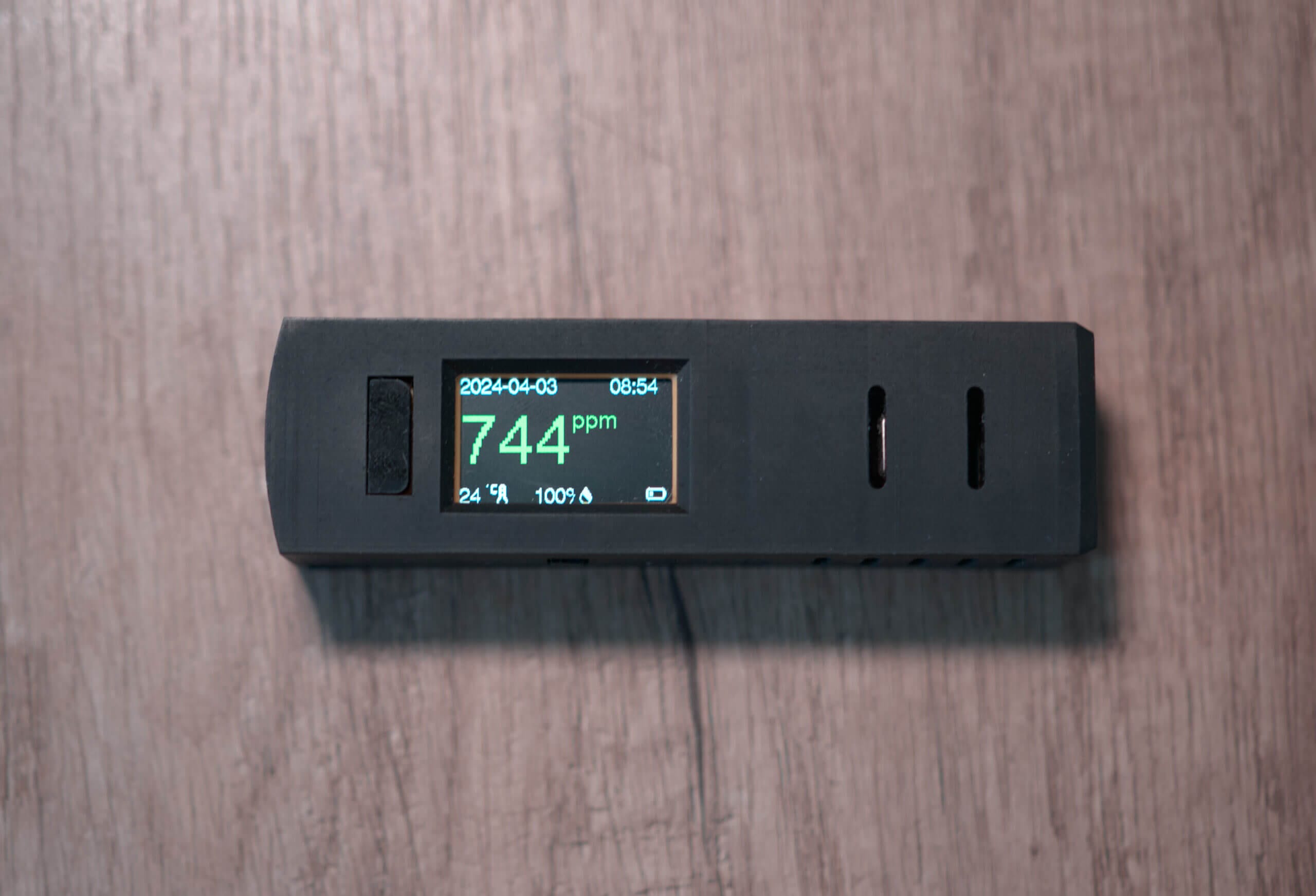

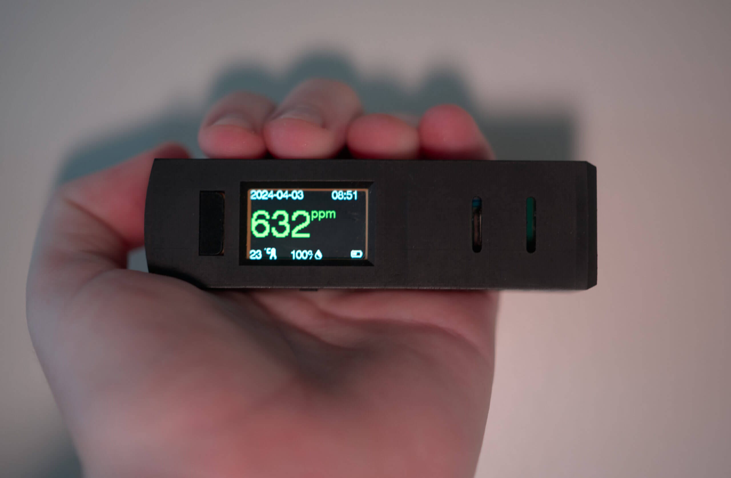

The Model F, even on the official website, is compared to a stick of bubblegum, and there is no better comparison regarding the shape and size of this device. Compared to other, typically square monitors, the Model F has quite a unique form factor that easily stands out. Overall, I prefer it too, as this long shape makes it very pocketable, and it feels a lot less cumbersome to carry because of this.
When the device is face-up, you will be presented with one button next to a small screen. This button is essentially the ‘home’ button, and it’s how you will turn the screen on to see the current CO2 concentration. After you press the button, the screen will stay on for long enough to check any information you need before it turns off again to conserve battery life. I would have preferred a small e-ink screen that could convey the carbon dioxide values while preserving battery life, but I understand these are more pricey and are challenging to find in such small sizes.
Since the device isn’t symmetrical and the screen only has one upright orientation, you will need to use the device with the button and screen on the left. This is far from a big deal, but it did mean that I would often need to turn the device around after pulling it out of my pocket (I am right-handed, and the device feels more natural to hold in my left hand).

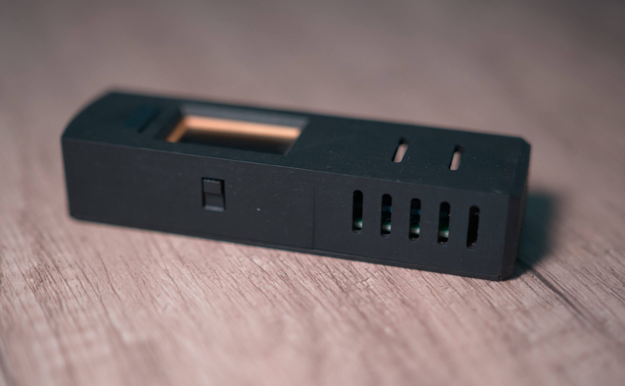

Opposite the screen, you will find vents on all sides but the bottom of the device. These allow air to flow through to the sensor and ensure the device can provide accurate readings. As with all CO2 monitors (and air quality monitors in general), the device isn’t waterproof, and you will want to keep it safe from water. Again, this is consistent across all CO2 monitors and isn’t an issue that is isolated to the Model F. However, it is important to keep in mind.
Interestingly, you can see the sensor through the vents, and it’s truly amazing how small it is (please see the picture in the accuracy section for a size comparison!). In fact, when you see how small the sensor is, it’s apparent how much this photoacoustic sensor has changed the game through miniaturising NDIR sensors. That said, we now need to wait for other technology, such as batteries, to catch up to get even smaller monitors (and, hopefully, one day, the ability to integrate these sensors into other devices like watches).

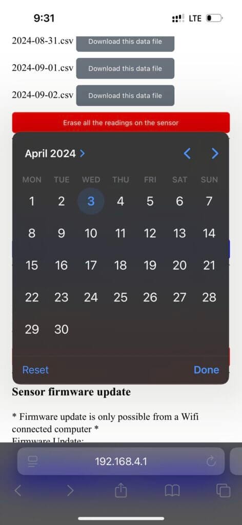

On top of this, you can also change the date and time on this site. This is one big issue I have with the Model F – when the battery dies, all time settings are lost. Many computers get around this by having a replaceable battery on the motherboard, and I wish the Model F also had some tiny battery in it to retain time and date information even through power loss. Unfortunately, this isn’t currently possible on the Model F, though.
This means that you will likely find yourself updating these date and time settings quite frequently unless you are very good at ensuring the device never runs out of battery. This won’t be an issue if you’re regularly using the device and charging it every night. However, I do wish the time and date data were kept even through the times that I forget to charge the device or am travelling and don’t have time to ensure it remains powered.
Finally, through this web page, you can also calibrate the device. This is as simple as pressing the button, placing the monitor outside, and leaving it for three minutes. Overall, the calibration process is exceptionally straightforward, and I have never encountered any issues here. That said, as discussed in the accuracy section, there are some things to keep in mind when calibrating the SCD41 photoacoustic sensor (place the monitor outside, but not in the way of strong airflow). Still, these don’t relate to the software experience.
